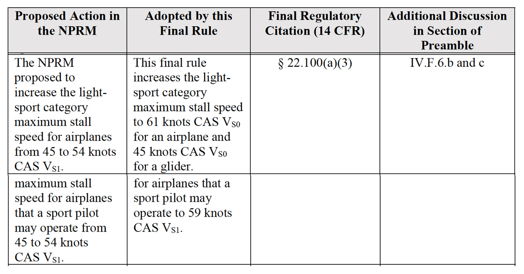

The single biggest change is the increase in the maximum stall speed for airplanes a Sport Pilot can operate. The old limit was 45 knots calibrated airspeed (CAS) without flaps (VS1). The final rule raises this limit to 59 knots CAS (VS1). This is a big deal, as it brings a massive number of popular homebuilt designs—as well as legacy aircraft like the Cessna 172—into the Sport Pilot world.

At the heart of these new, more capable LSAs is a fundamental shift in certification: a 61-knot limitation. This refers to the maximum stall speed in the landing configuration (VS0) an airplane can have to be eligible for LSA certification. By replacing the old, restrictive weight limit with this performance-based standard, the FAA is allowing manufacturers to build heavier, more robust aircraft. This single change enables designs with better handling in turbulence, increased useful load to accommodate modern passengers and fuel loads, and the structural integrity to incorporate new safety features and technologies like electric propulsion. It’s this higher stall speed that allows new LSAs to have the size and performance to truly compete with the homebuilt market, aligning them with the proven safety benchmark of the Primary Category.
It is important to distinguish this aircraft certification standard from the pilot operational limitation. While a new airplane can be certificated as an LSA with a stall speed up to 61 knots VS0, a Sport Pilot is limited to flying airplanes with a maximum stall speed of 59 knots in the clean configuration (VS1). This means that some newly designed, higher-performance LSAs may require a pilot to hold a private pilot certificate or higher to legally fly them.

The 61 KCAS VS1 for Light Sport Aircraft and 59 KCAS VS0 for Sport Pilots seems like a strange dichotomy. Previously we thought of LSA’s (at least I did) as aircraft Sport Pilots can fly. Now it seems like LSA is just an aircraft certification whereas the Sport Pilot rules can apply to any aircraft — including LSA.
