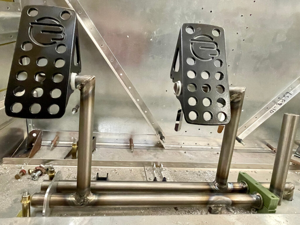

Fast forward from then, to my previous article in the Kitplanes August ‘25 issue and you will remember that I took this a step further with adding a simple argon purge setup to my welding equipment, bought a better tubing vise to jig these pieces up, and expanded my titanium fabrication into building the rudder pedals from titanium tubing. I’m still not ready to fully reveal my whole new pedal/steering/suspension system design, but I do have several more parts ordered to complete that new setup so stay tuned. While I am anxiously waiting on those parts, I have been looking at the rest of the control system for this 750SDXtreme. I had really planned to stop falling into the world of titanium with this build at the rudder pedals, but as I was sitting in my shop chair inspecting the main control torque tube, I found an imperfection that I just could not overlook. It was a crack at the end of the tube where a cromoly plate is bent and welded onto the tube and the aileron control rods attach to it. I have looked at this piece over and over, and while I really don’t believe it would ever cause a problem because this factory component is plenty robust and structurally sound enough to withstand any normal flying abuse, it is still a crack and I would always know there was an imperfection in this build and that would haunt me forever. I have no doubts that Zenith would ship me a new torque tube quickly if I had told them about the issue, but there were also a couple of other things leading me into more titanium work with this component. The connection point of the control stick to the torque tube is designed/manufactured in a way that is almost impossible to remove all the slack. After inspecting this same joint in my 700+hr Super701, I noticed it has developed more slack than it had when it was built, and there is just not a good way, or easy way, to fix it.

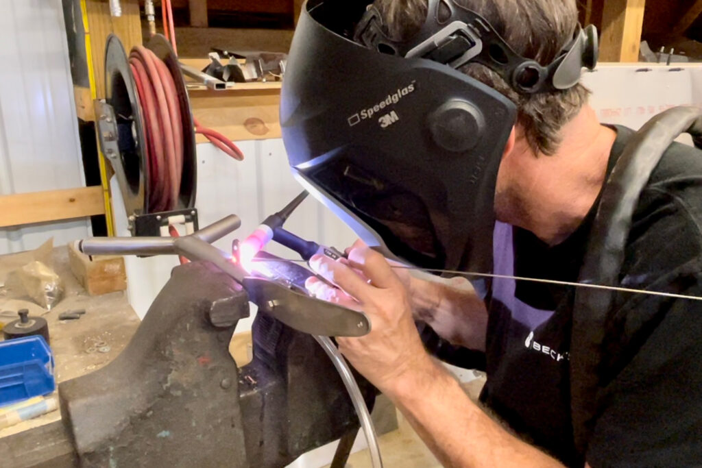

Now that I have a plan, it is time to cut more titanium tubing and meticulously cope the ends to get everything fitted up tightly and ready to weld. Once the pieces of tubing for the basic Y are laid out and ready, it is time to focus on the attachment point at the bottom of the stick. This requires two pieces of 1/8” plate to be cut and formed. I say “formed” because titanium does not like to be bend, at all. Titanium is too hard and brittle to handle the same “S” bend that the factory puts into their cromoly pieces. I also don’t see a good reason to make the lower end of the plate be parallel with the control tube, because this is the attachment point for the elevator cable and that cable doesn’t care which way it is turned as long as it is in the center of the tube, like the original control stick. So I decided to form that plate with a gentle curve, to ensure there is no degradation of its strength. These lower plates are also the pivot and attachment point of the control stick where it articulates with the torque tube.
I kept the basic shape of the larger plate by making a template out of plywood and then plasma cutting the titanium plate to match. A little extra time with the belt sander and I have a couple of nice pieces of titanuim plate cut to match the standard profile. To form the curve, I simply used a bench vise with pieces of rounded wood as a form and tightened the titanium plate down in the vise to achieve the offset it needed. Unfortunately, this was one of those nights where I came to the shop after eating supper to work on the airplane “for a little bit” and several hours later I stepped back outside the shop to find out it was getting daylight. So the jigging and welding of all these pieces would have to wait until the longer-than-normal workday was over, and possibly a little rest.
We are still way behind on the farm with our cropping season because of record-breaking rainfall for the month of May. So every chance we get, we are trying to catch back up on that. In between the farming, consulting, and all my other responsibilities, I am working on this 750SDXtreme as much as possible.
So…..Back to it! After a few hours of jigging up and Tig welding all these pieces, I finally have a nearly complete control system ready to install into the 750SDXtreme! It was exciting to see these newly made titanium components come together as I mocked them up into this custom Super Duty.
