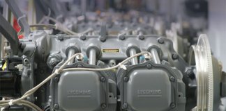

If your fuselage is not yet on its main gear, you can still use these dollies to your advantage by placing several in key positions underneath to maintain its balance. Your project is kept off the floor and is simple to move as needed. Another common place to find these dollies is underneath the large wooden crate that many kits are shipped in. We all love to keep that crate for storage (and it might also double as a workbench) as we build. While the crate is impossible to move when planted on the floor, a set of dollies at each corner allows a single person to roll that crate to any location in the shop. The same goes for the engine—whether it is in a crate or not. A larger version of the dolly can provide a wonderful platform for an engine that can now be easily rolled across the floor by one person. And being just inches above the floor, it is safe from accidental damage as it doesn’t have far to fall.
