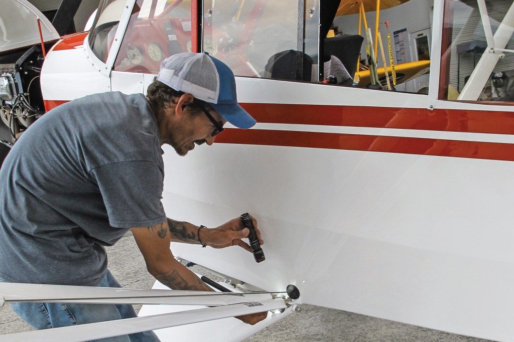

Maintenance technician William Vergonet conducts an inspection on a Cub. [Credit: Lisa Turner]

When you get out of the cockpit, walk a distance from the airplane and walk around it. Notice stance and anything else unusual. Then move in closer. Look for unusual streaks and definitely look at the belly. Yes, you might need to get on the ground to see everything. Engine system leaks will show up here. One time I added some oil to the Rotax tank prior to flight. I added too much. Guess where it went? The entire length of the underbelly. It wasn’t visible unless I got on the ground to look.
