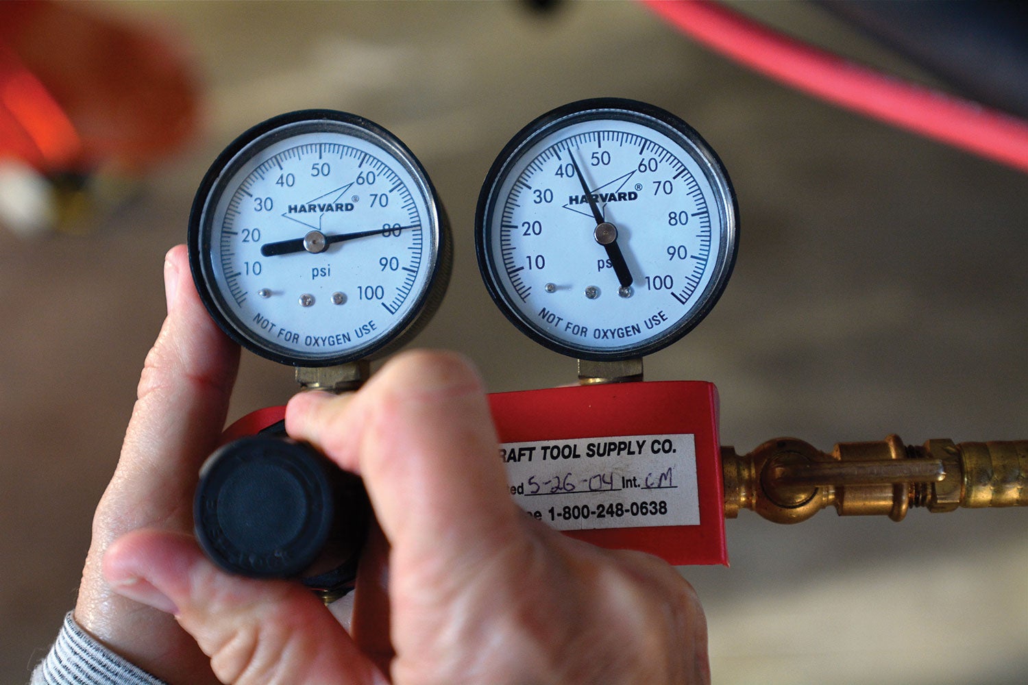

You look down at the instruments, and instantly energy drains down your body as if bomb bay doors on the soles of your feet had opened and the concrete floor were a sponge. The first needle is pointing nearly at 80, just as you knew it would, but the other is barely in the 40s. For an instant your thoughts and a solitary word go blue.
“Back it up a bit and see what you get.” Your buddy pulls back on the prop with the sort of seriousness you hadn’t seen since your days on the explosive ordnance detail. The needles drop on the tester, then zoom upwards as the prop moves forward. As the prop stops where your buddy senses top center, the needles find a slightly different resting spot. You tweak the tester’s adjustment knob and get a little rise out of the low reading, but nothing like you’d like to see. Oh no.
You try again with no luck. So you try again, and the needles play with a slightly higher reading but then slide back a notch. Forty-nine over 80 is the best you can get. Disgustedly, you disconnect the air hose.

So, when we come along and try to pump the cylinder full of air, the cylinder can be far from normal running conditions. There’s no better illustration of this than when we “rock the piston” by moving the propeller around top center. The piston is so loose in the cylinder, it literally flops around the piston pin. This changes the piston ring to cylinder wall mating and often results in a big improvement in leak-down readings.
Because of this, it turns out leak-down testing of aircraft cylinders is rather more ambiguous than we might think. Both Continental and Lycoming offer various testing regimes that essentially sum up to “Run it and test it again until you get a reading you like.” If you really have a problem, you’ll eventually get all the signs such as rapacious oil consumption, wet spark plugs, high EGTs, and so on. If you don’t have a problem, then retesting will typically show a dramatic improvement.
The 49/80 cylinder noted above tested as 75/80 after a 7-minute ground running session. Like tucking in your shirt and combing your hair after a long flight, that engine just needed to re-adjust its piston rings. No doubt they had been lightly glued to the piston groove by cold oil.
In short, while leak-down testing can certainly pinpoint problems, it’s also a tool that requires considered thought when interpreting the readings. Like the good advice to watch trends and not just one sample in oil analysis, it sometimes takes a couple of goes with that sticky-valved tester to get the full picture of what’s going on in those big cylinders. But that doesn’t mean they can’t scare the stuffing out of you occasionally. J

If you get a low reading, it’s important to listen to where the air is leaking.
Take the oil fill cap/ dipstick out. If you hear the hissing here, the air is leaking past the rings, so try the ‘ hot test ‘.
If the air is hissing out one of the exhaust stacks, it’s leaking past the exhaust valve. Try the running the engine, in case there is some carbon between the valve and the seat.
Continentals tend to wear the exhaust valve guide if run too rich, with the lead depositing on the valve stem and wearing the guide.
BTW, TCM doesn’t care about the differential pressure readings. If the engine makes full static power and has oil use less than the limit, it airworthy.
