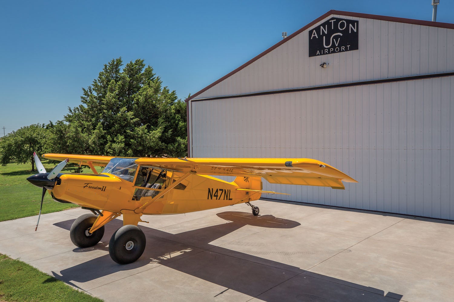

A series of transitions defines every pilot’s life. For Bill Anton of Satanta, Kansas, retiring after 35 years as an ag banker coincided with maturing flying desires, “from cross-country and aerobatics to fun flying out in the boondocks.” Now 72, “I’m thinking of how many more years of good flying I might have left,” he said. After more than 800 hours in the Van’s Aircraft RV-8 he finished building in 2006, “I was ready for something different.”
A Bearhawk is certainly different. He chose it by following the same path that led him to the RV-8 in 1998, when he decided it was time to build his own airplane after flying a Piper Arrow for 17 years. “I sat down and wrote a set of criteria for what I wanted. I live out in the country, have a grass strip and hangar, so I needed something that would handle grass. And I wanted something that would go cross-country” with at least one passenger, his wife, Nancy.
His list compiled, Anton sat down with the directory of available amateur-built designs “and started crossing out those that didn’t meet my criteria,” he said. That included a requirement for how many were airborne. “A lot of them had only four of five flying, and those I kind of eliminated.” Looking at his final candidates, “Since I’m a fighter pilot wannabe, I picked the RV-8,” he said.
The Antons haven’t moved from their Anton Flying UV Airport (SN98), so those criteria remain. Measuring 2150×100 feet, Runway 1/19 forms one side of their 15-acre property. Steps from the hangar is the house they built between 1979 and 1982 on the remains of the family’s southwest Kansas homestead. The Flying UV, so called because one arm of the U flies over the V, is the family brand, the initials of the homestead’s founder, Ulysses Victor Anton.
The RV-8’s usual passenger is also 72, “and it is getting to be a struggle to get in and out of the back seat.” Anton said. “I’m not so sure the Bearhawk is any easier with those 31-inch tires, but once you’re in, it is more comfortable.”
Comfort, cross-country cruising and cargo capacity rounded out Anton’s criteria for a backcountry airplane that can go cross-country. “Some of them are 100-mile-per-hour airplanes,” he said, adding that he was a Cessna 172 partner for about two months. Relating a midsummer cross-country with his wife, “It beat us up and took a long time to get there, and I didn’t want to do that.” The Bearhawk cruises at 150 mph, “so you can go someplace in it.”
Speaking from 12 years of RV experience, “You have to be real careful what you pack,” Anton said, adding that when they camped at Oshkosh, it was Spartan. “With the Bearhawk’s big ole back doors, you just throw stuff in and take off.” Taking a friend to EAA AirVenture 2019, he said all their camping gear, two tents, sleeping bags, mattresses, and a huge Yeti cooler “hardly filled up the back.”
To use the space more efficiently when carrying two passengers, Anton built a single back seat that replaces the side-by-side bench. It made its first flight in October 2019, when Anton and his sons, Marc and Erik, both pilots, flew to Critter’s Lodge, a private aviation preserve in East Texas, for its annual long weekend fly-in. “They had probably 20 or 30 airplanes there” at the grass strip just off Highway 7 between Crocket and Centerville, Texas.

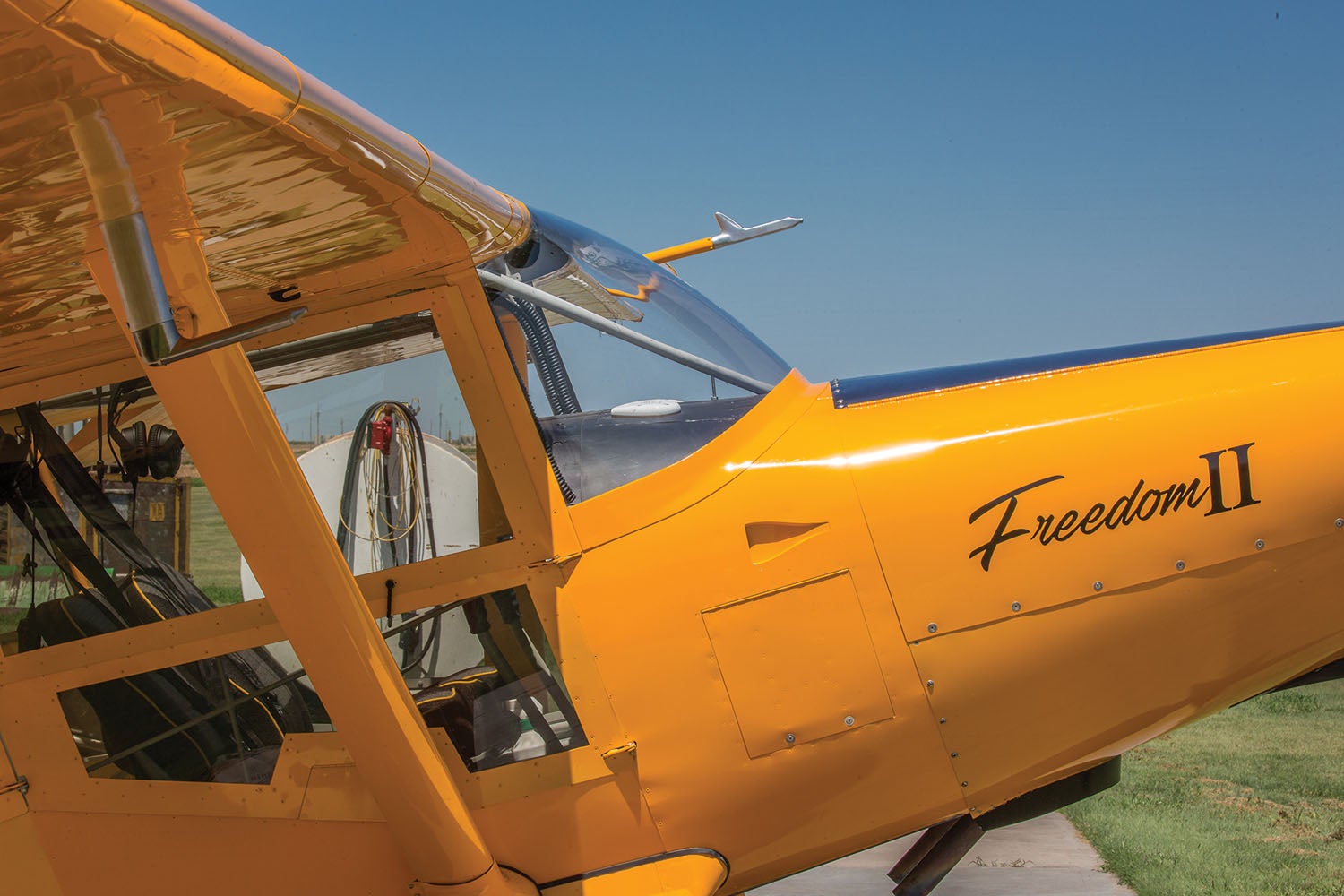

Big backcountry tires are not the Bearhawk’s only distinguishing feature. It has two pitot probes. A military-issue heated pilot/static head, like those on a P-51 Mustang, extends from the left wing. An eBay find, “I really like the military combination of the pitot tube and static port” in a single unit.
But the military unit would not work with the Dynon system, which requires a pitot tube plumbed to provide the source data for angle of attack. That pitot tube extends from the right wing. Instead of putting in a static port, Anton installed the military unit and used its static port. “It’s a nice conversation starter,” he said, if people notice the bilateral probes.

Prepared by more than 800 hours in his taildragging RV-8 (N46BV for the year of his birth and his name, Billy Victor) and another hundred hours or so in the Aeronca Champ he once owned, Anton made the maiden flight of Bearhawk N47NL (for his wife, Nancy Lynn) on November 2, 2018. “I kissed the ground, got in that baby and away we went. It was a little out of trim. The Bearhawk is a very rudder intensive airplane compared to the RV-8. When I took off, I was puckered up because I was trying to keep it upright. It wasn’t like it was rolling over on me, but it had a heavy wing and the rudder was out of trim.”
Adding trim tabs on all of the control surfaces resolved the problem during his Phase I test period. Studding the wing with vortex generators improved its low speed performance. Still, he said, “You really have to fly it. No sleepy feet.”
