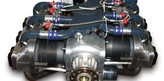

Engine: whistling or hissing sound; frequency changes; erratic idle. You may be hearing an induction air leak. Your aircraft engine needs a precise balance of fuel and air plus compression and a well-timed spark to produce efficient combustion. Any problem with this mix will affect performance. Induction air leaks will do the least amount of damage if caught and fixed promptly. Check gaskets, hoses, flex elbows, clamps, head to intake tube joints, and even alternate air doors not closing all the way.
Engine: clicking, missing, and rough-running sounds when cold that go away when warm. The most serious is sticking valves and especially an exhaust valve stuck closed. The cause can be a buildup of deposits and/or corrosion. Don’t be fooled if the noises go away upon warmup. Sticking valves may free up temporarily but don’t get better over time, so this is something to get checked out.
