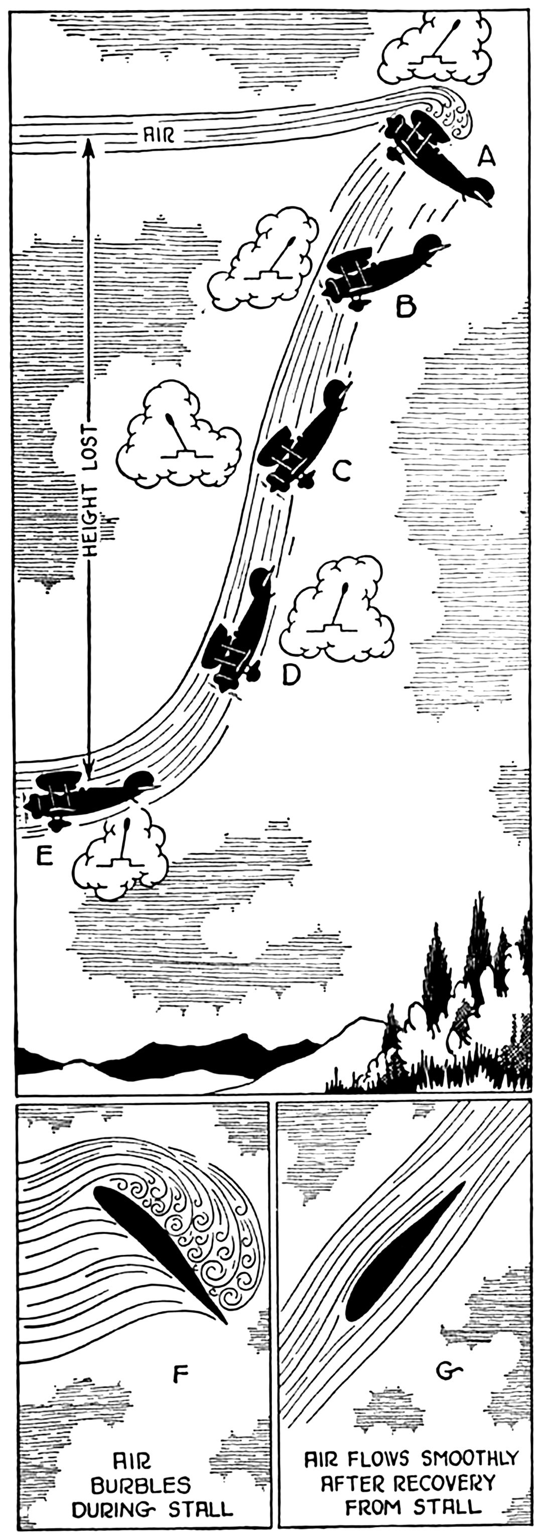

What is a stall? The textbook says a stall is the loss of attached flow, the lift-producing stream of air flowing more or less smoothly across a wing’s upper surface. When this flow no longer follows the wing’s surface, but breaks away into burbling eddies, effective lift is lost and the wing stalls. Exceeding the critical angle of attack is the root cause of the stall. As long as the wing meets the oncoming relative wind at less than the critical angle of attack, the air is parted by the wing’s leading edge, flows smoothly along upper and lower surfaces, and leaves the trailing edge cleanly. If the wing is raised beyond this critical angle, airflow is disrupted and the stall occurs.

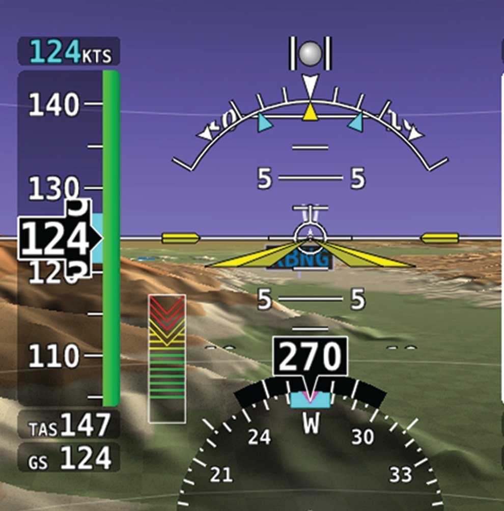

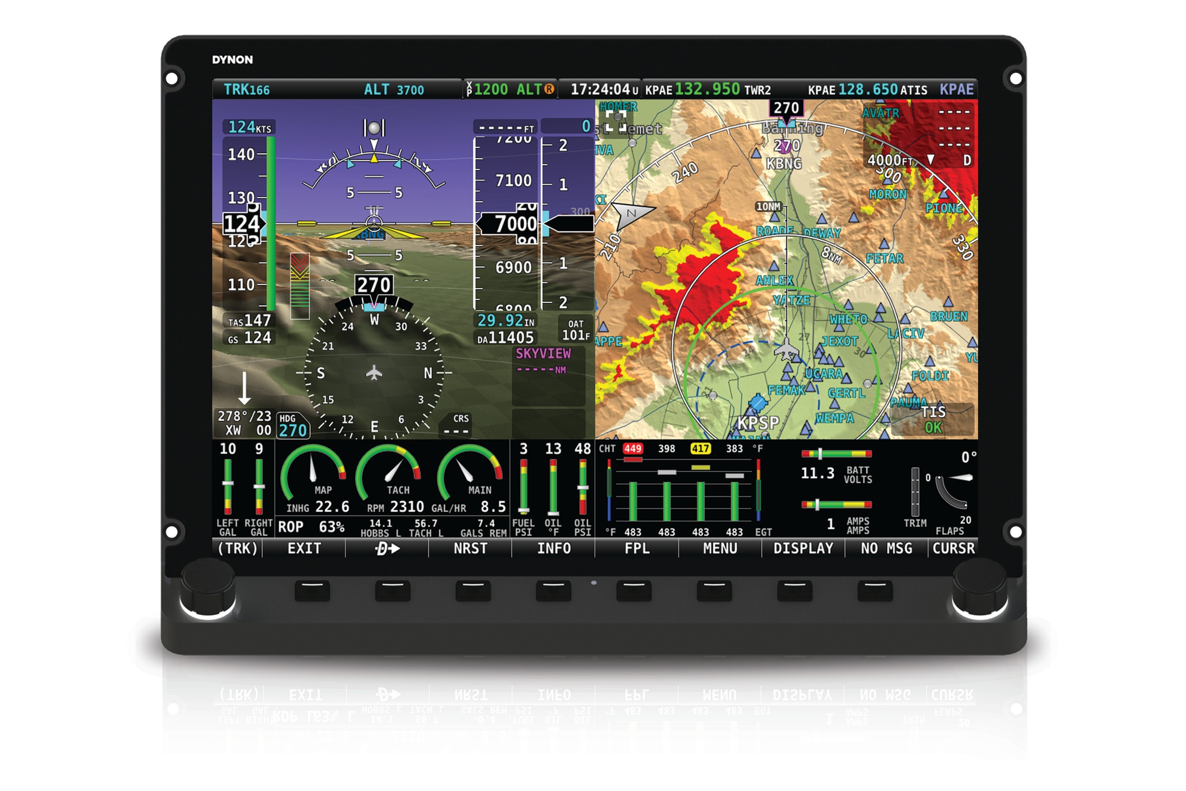

Without an angle of attack indicator, the only readout we have from the changing angle of attack is the airspeed indicator, which unfortunately suffers from some delay due to the inertia of the airplane’s mass. An angle of attack indicator reacts instantly as the stick is pulled back, while the airspeed indicator takes a second or so to respond. On a Dynon SkyView HDX, for example, it appears as a colored bar beside the airspeed tape. Likewise, a slow airspeed alone is not enough stall warning, since the inevitable question is, how slow is too slow? Loading affects this magic number considerably, either in terms of gross weight or the additional G-loading of a turn or pull-out. When the wings are asked to support more load, extra lift must come from somewhere. Angle of attack can be increased, producing more lift up to the point the stall burble begins, or speed can be increased to bring more energy-laden air across the wing. If the angle of attack is already at the stall angle, only an increase in airspeed is available as a means of ensuring flight.

A true stall is manifested by an increase in rate of descent, or an inability to maintain altitude, despite further application of up elevator. In other words, if you try to pull the stick back farther and get no response, you are, practically, stalled. Certificated aircraft should demonstrate aerodynamic indication of stalling. Normally, the uncontrollable dipping of the aircraft’s nose, or a sudden roll-off, signals recovery time. There should be no delay in recovery after the stall occurs, unless the instructor desires to demonstrate controllability in a prolonged stall. However, care must be taken in gusty, turbulent air not to mistake a jolt from rough air as the stall.
Recovery should be accomplished by moving the stick forward to lower the angle of attack positively. This can be done by releasing the back pressure being held, or shoving forward against trim forces, whatever it takes to get the nose down! While nose attitude is not a definite guide to being out of the stall, if the nose is lowered from where it was at the stall, angle of attack should be lowered as well. The exception is in a delayed recovery, where the airplane has started to settle in a nose-high attitude; a much lower nose attitude than normal will be required to achieve recovery. In any event, if stall symptoms persist, such as stall warning, uncontrollable pitching and rolling, or shuddering of the tail surfaces and airframe, lower the nose still further with a healthy shove on the stick, even if it looks plenty low already.
Emphasis should be placed on minimum altitude loss as a guide to effective stall detection; catch it early and little altitude is likely to be lost. However, this technique can prevent students from lowering the nose sufficiently to break the stall, in an effort to conserve altitude. A fine line must be drawn between diving away altitude in the recovery and prolonging the stall by not lowering the nose enough. Nose attitude should be at or below that of level cruising flight, as a guide to full recovery, so get that horizon up above the cowling. All available power should be applied to assist recovery, of course, taking care to break the stall at the same time. Otherwise, torque and P-factor may roll a high-powered airplane into a spin if throttle is suddenly applied while still in a stall. Directional control should be as important a criterion of judging stall recoveries as altitude loss; recovery should be completed on or near the same heading as when the stall occurred.
