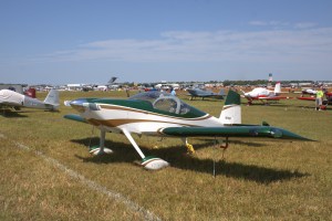

A Different Office for New Certificates
The second change is less welcome in some places. FAA Certificate Management Sections, the offices formerly known as MIDOs, now have primary oversight of all original airworthiness applications, a duty they previously split with Flight Standards District Offices.
Designated airworthiness representatives who work under a FSDO, known as DAR-Ts, can still issue original certificates for amateur-built aircraft. But the Certificate Management Section gets the first opportunity to issue the certificate itself or delegate the inspection. It can hand the job to a FSDO inspector or a DAR-T through the FAA’s Airworthiness Certification system, but only after the section manager contacts the gaining FSDO and confirms it will accept the work.
In practice, a builder seeking an original airworthiness certificate should start with the Certificate Management Section, not the local DAR. EAA reports member concerns about delays, particularly in areas where the familiar local DAR is a DAR-T who must now receive a delegation first. Builders and DARs who run into trouble are asked to email EAA at govt@eaa.org.

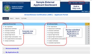

Amending is optional. It is only necessary if you want to use a light-sport repairman’s inspection rating yourself or hire a repairman with a maintenance rating to do the work. An owner or authorized agent can request the amendment through the local FSDO or online, using the Amended Certificate application in the FAA’s Airworthiness Certification applicant portal. The amended limitations are updated to match the current table of standard limitations in Order 8130.2, so they also pick up the new flight-test wording. That matters if a major change ever sends the airplane back into Phase I.
Because the portal is not always intuitive, EAA recorded a step-by-step video with FAA DAR Joe Norris, “How to Amend E-AB Operating Limitations,” available on EAA’s website.

Green and white Van's RV-14 parked on grass at Sun 'n Fun
Builders finishing projects such as this Van’s RV-14 now start certification with an FAA Certificate Management Section. Photo: ZLEA/Wikimedia Commons, CC BY-SA 4.0
FAA Airworthiness Certification applicant portal dashboard with the Amended Certificate option
Owners can request amended operating limitations through the Amended Certificate link in the FAA’s Airworthiness Certification Applicant Portal. Image: FAA
