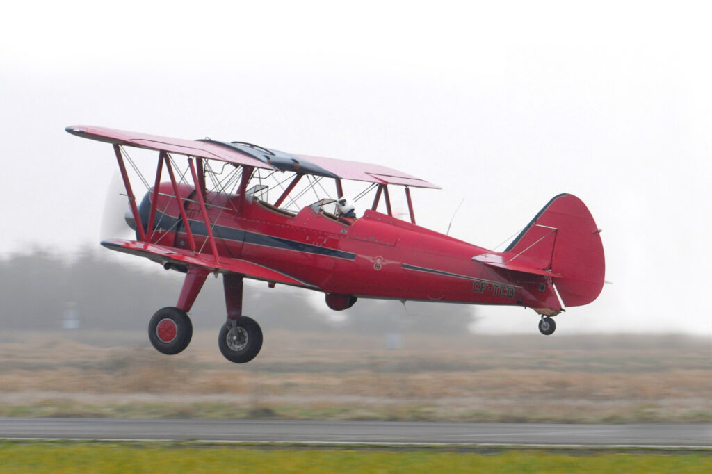

Years went by and the airline’s rules regarding eyeglasses changed. Today he is a senior captain and training officer flying the Boeing 777. He maintains his love for both warbirds and aerobatics. His tenacity and sense of purpose in all things led him to start and complete what became a 30 year project; the restoration of a 1936 Model 75 Boeing Stearman, serial number – 003 now registered as CF-TCQ.

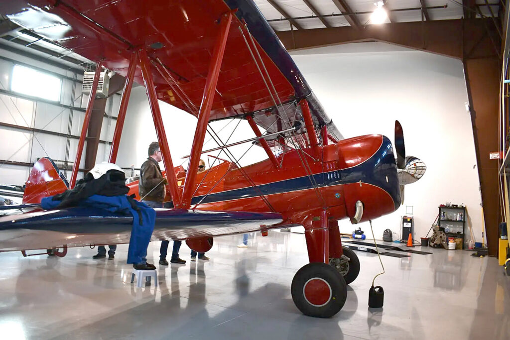

Spraying for 34 years and then being stored outside for another 12 didn’t do anything to make the restoration any easier. However, work wouldn’t start right way as the project spent a further 3 years in a container. Kevin says that of the 6700 hours, at least half was spent learning and the other half actually restoring. Many parts had to be made with some requiring both special tooling and skills . All of the work was all done at home except for the painting. He sprayed the primers in a rented shop spray booth but left the spraying of the distinctive red and blue colours to be done by professionals, one of the few tasks jobbed out to others.
This was not an easy project with many components needing either repair or as in the case of the four wing panels; new ones had to be built as had been replaced some time in the 60’s, most likely due to an accident but time and glue failures had taken their toll. Kevin did use some wood salvaged from the spars to form the ribs, so yes, some of the wood is original. Many components had to be either rebuilt or replaced.
The changes made, such as adding the second set of ailerons, required STCs–a total of 14. While some were easy such as the fabric and spin-on oil filter, others were not so simple. The installation of the big P&W is particularly noteworthy in spite of the fact that Boeing had done it in the 1930’s. He had the engine overhauled by AeroRecip in Winnipeg, Manitoba, a company with over 30 years of experience with large piston engines. While that was being done, Kevin had to engineer and certify the entire engine installation from scratch. Many “in the know” said it couldn’t be done and they may have been correct but for the help of the very talented DAR, Jim Watson.

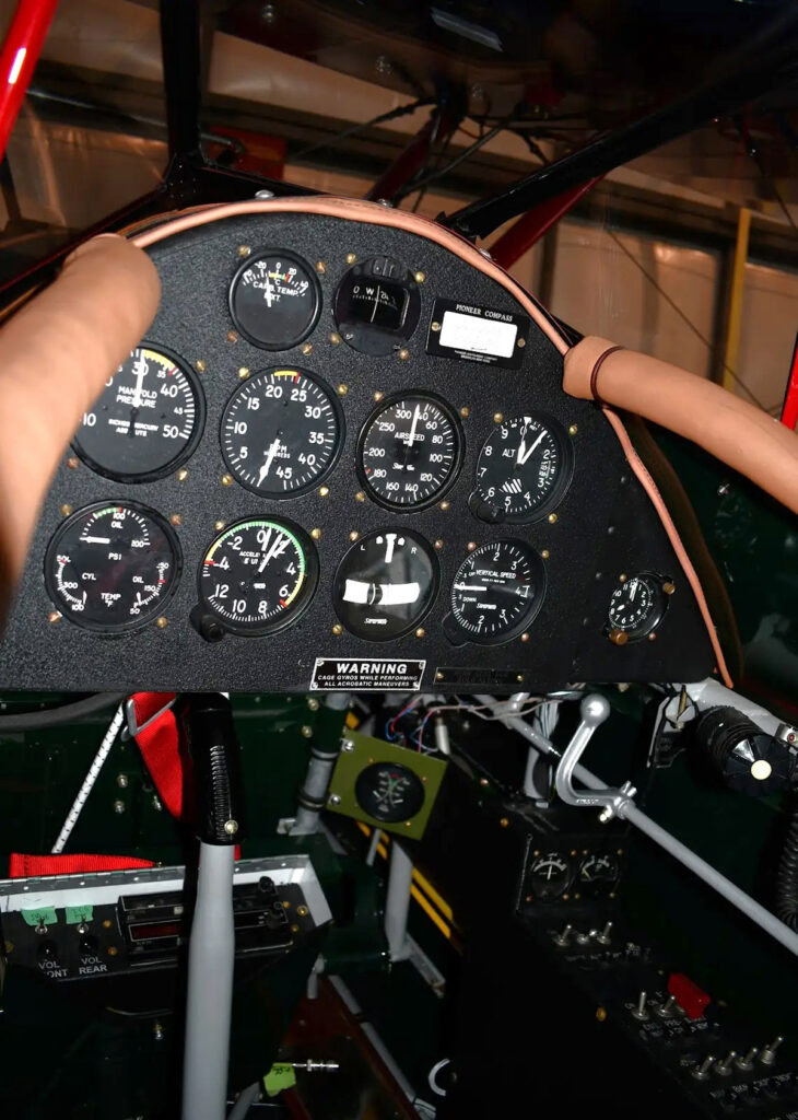

Kevin had to learn how to make smooth round aluminum parts such as the cowling, the wheel pants and others such as the fuselage fairing. The front and rear instrument panels, fabricated from new material have a distinct lack of square openings as Kevin elected to go with the more traditional ‘steam gauges’ in keeping with the vintage look. There may be a bracket for an I Pad but….

Once a rigorous flight testing program was completed and with 12 hours on the ‘new’ Stearman, he flew her from Victoria on Vancouver Island to the Boundary Bay airport where he invited friends to a well attended unveiling. Later that same day, after a delay caused by some local fog, he flew her to a new home in the Okanagan Valley. He did have one complaint. He found it a little chilly at 10,000 feet in January.
