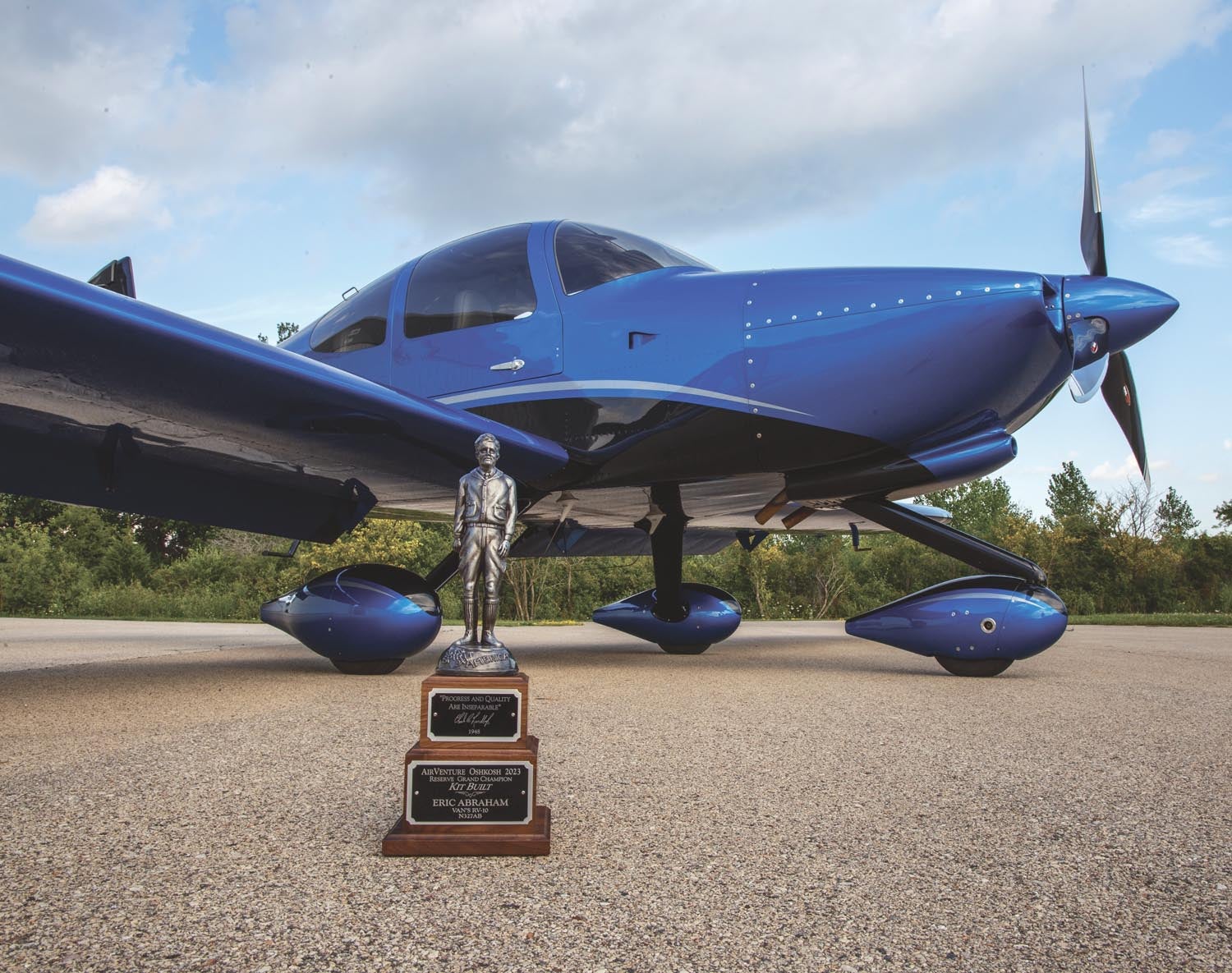

Silver Lindy RV 10 12“Don’t print this—the perfect fit of the luggage door was an accident. The RV-10 luggage door doesn’t fit well from the factory. Trace was applying pressure to it and it bent. When he put it in place, it fit perfectly.”
What compels some people to reveal their invisible errors while showing off their superb craftsmanship? Whatever it is, Eric Abraham has it. But then he and his building partner, Trace Blakely, also have the Kitbuilt Reserve Grand Champion (Silver) Lindy from AirVenture 2023 for their Van’s RV-10, the one whose minor imperfections Eric was pointing out. “We built it to get it done, not to win an award.” That said, the RV-10 was not their first trip to the AirVenture homebuilt awards stage. In 2021 Trace was presented an Outstanding Workmanship plaque for his RV-7, which Eric helped build. “When the RV-7 was inspected,” said Eric, “the DAR told us, ‘You should show this at Oshkosh.’ We were like, ‘Really?’ We didn’t know anything about that.” They do now.

Eric and Trace both credit their Lindy to their execution of the details and the fact they did all of the work themselves. Eric said, “What’s funny is I didn’t even want to take it to AirVenture this year because of a cosmetic flaw around the windows, which appeared after it was painted and needs to be fixed. I was thinking, ‘That’s so ugly. It’s so ugly,’ because that’s all I could see. I tried to improve upon something, but it failed. But it’s fixable.” Of course, Eric pointed out the blemishes.

The gear leg fairings received careful attention, which helped draw the attention of AirVenture’s homebuilding judges.
Trace said they never had to reorder a part. “If we did make a mistake, which was seldom, we found a way to correct it or we made a replacement part ourselves.” When asked his reaction to being awarded Kitbuilt Reserve Grand Champion, Trace was quick to answer: “I couldn’t believe it. We figured maybe another Outstanding Workmanship plaque, then we’d both have one with our name on it. When they finished passing out the Bronze Lindys I thought, “Well, I’m going home with my tail between my legs. We got nothing. Then they called Eric’s name for Reserve Grand Champion.”
