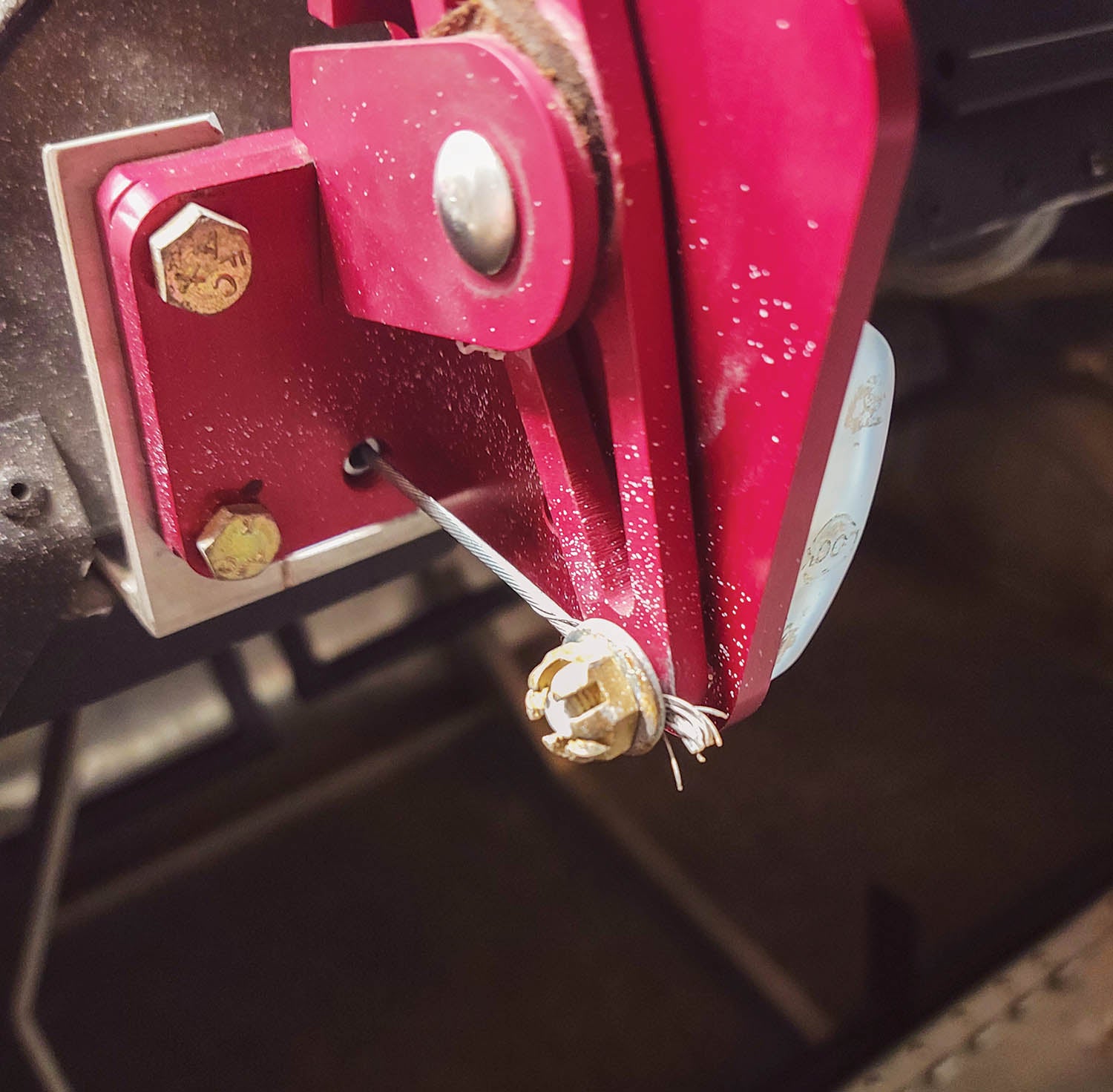

One Monday morning I opened an email from the second owner of a Onex. It was sent at 8:12 p.m. on Saturday. An attached photo showed a rudder drive rib separating from the rudder drive plate. (The rudder drive rib is simply the bottom rib in the rudder that is riveted to a flat-aluminum control horn.) If it had succeeded, rudder control would have been severed. My response to the customer was sent at 7:08 a.m. It included items to check and, as always, questions.
By 8:25 a.m. the customer responded with a link to a video he shared online the day before. The video recapped how he had a gut feeling he shouldn’t fly and how he found the failing assembly when he lifted the tail to clean the bottom of the fuselage. He notes that the airplane had a prebuy inspection, had passed a condition inspection two weeks prior and had had one previous condition inspection since he purchased it. Comments on the video were accumulating. Many praised the pilot (and rightfully so) for going with his gut feeling and not flying. Others said they were rushing to inspect their Sonex. Others were questioning the design. “Well, poop” (or words to that effect), I thought, “this is not going to be an easy day.”
I’d fought speculation before so I knew what to expect. By day’s end, my inbox, the video and the Sonex community would be abuzz with worried owners, builders, pilots and potential customers. There would be more speculating than California experienced in 1848. A proper investigation of the failure hadn’t even begun by those most qualified to perform one, the aircraft designers, yet suggestions for alternate designs were already being bandied about by people who didn’t know they were staring at a builder’s modification. To squelch the flames, I commented on the video, “We [Sonex] are in contact with [the owner] on this issue. Before knee-jerk reactions and wholesale panic sets in among the Sonex community, please read this…” I identified two plans deviations, one significant, which were visible in the video.
Inspection and Diagnosis
Sonex identified a modified tailwheel pushrod as a primary suspect in the failure. Whoever installed the non-conforming pushrod couldn’t have done a better job setting up the drive rib for failure. Essentially, they built a pry bar. The bottom of the rudder also appeared raised above where it should be on a properly built Onex. That changed the linkage’s geometry and further increased leverage on the drive horn. (The rudder hinge was also short one lug, though that would not have prevented this failure.)
Two days later, on Wednesday, the Onex’s owner reported, “The [tailwheel] drive rod seems to be the primary problem at this point…moving the rudder pedals to the rudder itself did very little to separate the horn from the rudder, however when the wheel was turned in one direction it caused severe pushing-down effect on the control horn. When I tried to resist it manually it was almost impossible. I’m thinking when it was still firmly attached any ground operations were probably causing a tremendous amount of force on that assembly.” He posted a follow-up video, but with a less dramatic title than the first: “So What Went Wrong? (Sonex Onex 090)” was the sequel to “I Almost Died—Sonex Onex.”

The drive horn failure was the result of a series of events that can strike any Experimental/Amateur-Built aircraft. It began with a builder’s deviation from a manufacturer’s parts and plans. The Experimental/Amateur-Built (E/A-B) category allows this, for better or worse. The current owner executed due diligence by having a prebuy
inspection, though we don’t know the inspector’s qualifications to inspect a tailwheel Onex. The initials “A&P” are not enough. The failure may not have been in progress at the time of that inspection, but the builder’s deviation was in plain sight. It could have been caught if the plans had been referenced during the inspection, or if the inspector was familiar with the design.
The most recent condition inspection also failed to discover the problem. But here’s the thing—even if the plans deviation had been noted by either inspector it is not within an inspector’s right to ground an E/A-B aircraft because something deviates from the plans. An inspector can point such things out and refuse to sign off an inspection, but they can’t force plans compliance.
There is nothing a kit manufacturer can do to ensure their parts and construction documentation are used. To think otherwise lacks any understanding of this hobby. They try, however. Van’s Aircraft issued Service Letter SL-00062 (a must-read for every E/A-B owner), which states, in part, “Any changes, enhancements, or modifications made by the builder, owner, or any other person are made at that person(s) own risk, and the person making the changes as well as anyone who operates that aircraft anytime in the future, bears the responsibility for evaluating, understanding, and accepting any consequences of such deviations from the plans.”
The owner of the aircraft found the defect, through pure luck, when he lifted the tail to clean the bottom of the fuselage. After so many inspections by, we assume, professionals, his discovery fell right where the FAA places ultimate responsibility for the airworthiness of an aircraft: 14 CFR section 91.403(a) of FAR Part 91, subpart E, states, “The owner or operator of an aircraft is primarily responsible for maintaining that aircraft in an airworthy condition, including compliance with FAR Part 39 of this chapter.” This regulation applies to all GA aircraft and I’d argue it particularly applies to owners of E/A-B aircraft, of which no two are the same.

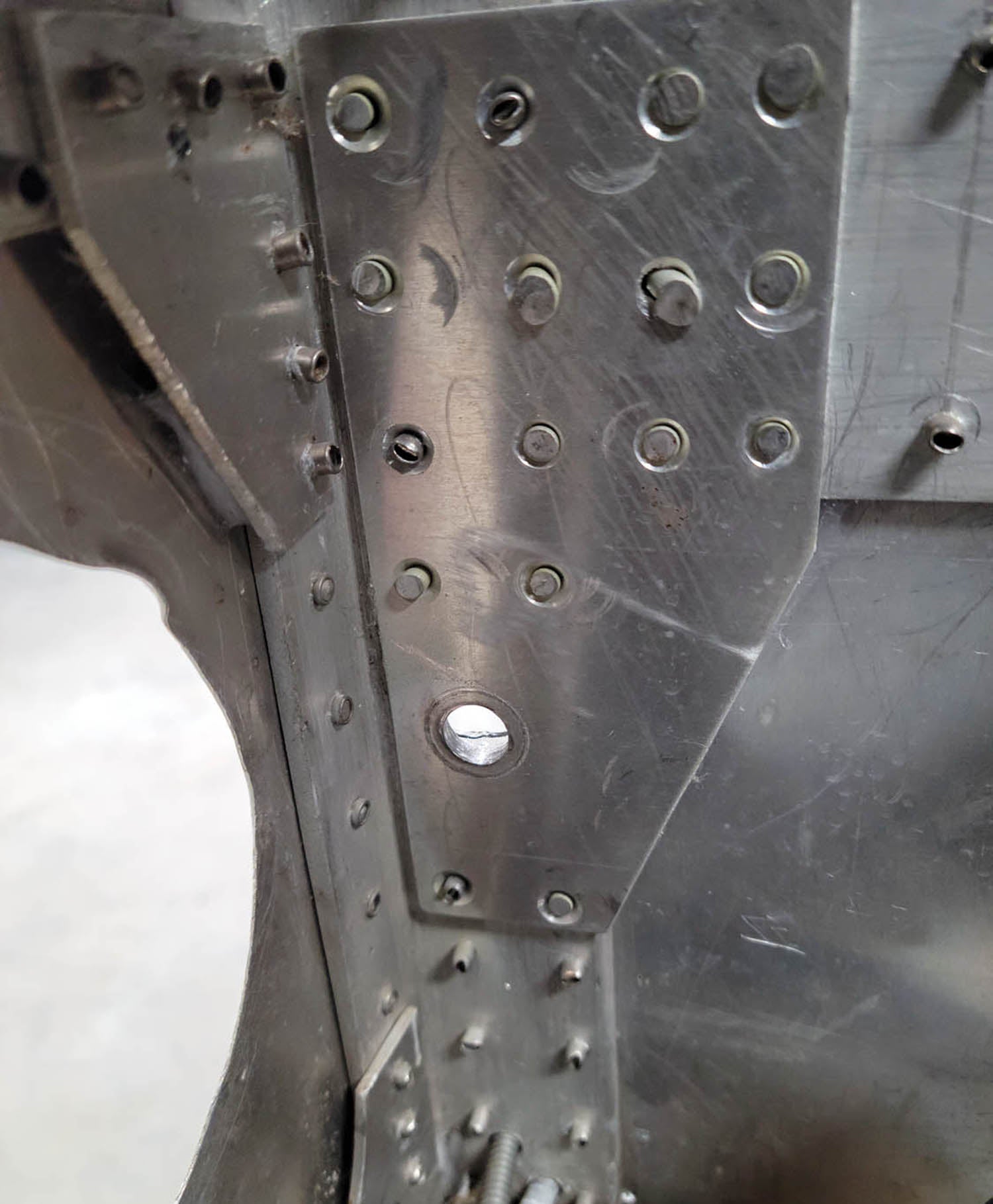

I was disappointed that the article ‘A Cautionary Tail,’ didn’t focus more on the really poor workmanship seen in the photograph. Those solid rivets were terrible. If that assembly passed the inspections noted in the article, either; the homebuilt workmanship standards leave a lot to be desired or, the inspectors really suck (IMHO).

Thank you for reading and commenting. I didn’t focus on the multitude of sins in the photo with the rivets because riveting wasn’t the focus of the column and I have a word limit for my columns. I can expand here, however. In addition to the solid rivets being poorly set, if built to the plans there shouldn’t be ANY solid rivets anywhere in that photo and the shop end of each rivet in the gusset plate should be visible, as they are in the angle below the gusset. Also, none of those visible holes should be countersunk.
The current owner (not the builder) is correcting a host of builder errors and assured me that airplane was signed off and flying.
~Kerry
What blows me away is that the proper assembly uses pulled rivets, and you have to try awfully hard to screw up as bad as the rivets in that bracket. So glad the new owner caught thee issues and fixed them.
It would have been easier and faster to do it properly, than the disaster that bracket became.

As a EAA Tech advisor, I wouldn’t call that shoddy workmanship, I would call it total crap..how any one would perform that kind of work and think is would be ok is beyond me. Surprised they didn’t ask for the help .
Agreed, that mess of a bracket took far more work to get wrong, than it would have taken to get it right. People never cease to amaze me sometimes.

Ditto to all of the above. The worst rivets I drove getting my A&P were orders of magnitude better than the worst rivets on the rudder plate. If my rivets were as bad as these, I would have flunked myself!
Many years ago, a technical counselor at an EAA Chapter meeting said the best way to inspect an EA-B when you don’t have unlimited time is to look at the workmanship in areas that aren’t normally visible, such as safety wiring. If he did a good job where no one can see, he probably did a good job everywhere. It doesn’t look like anyone looked at that area of the plane, as it was probably difficult to get to. I hope the current owner went through the plane with a fine-tooth comb because the overall workmanship stinks!

To clear one item up, the photo with the poor rivets is not associated with the failed Onex rudder. That plate is a wing spar tunnel support gusset on a Sonex. The large hole is where a main spar pin passes through to secure the wing in the fuselage. Different airplane, different builder, but equally serious possible consequences. Thankfully the current owner is making right all the wrongs hidden in that airframe and knew what they were buying before they bough it.
