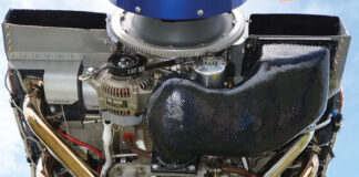

Andrew Angellotti is using his O-200 powered KR-2S as a test bed for his growing line of Experimental aircraft test equipment. As we see it here at the Mojave Experimental Fly-In, the KR was clearly benefitting from some experimental work to the cowling.
