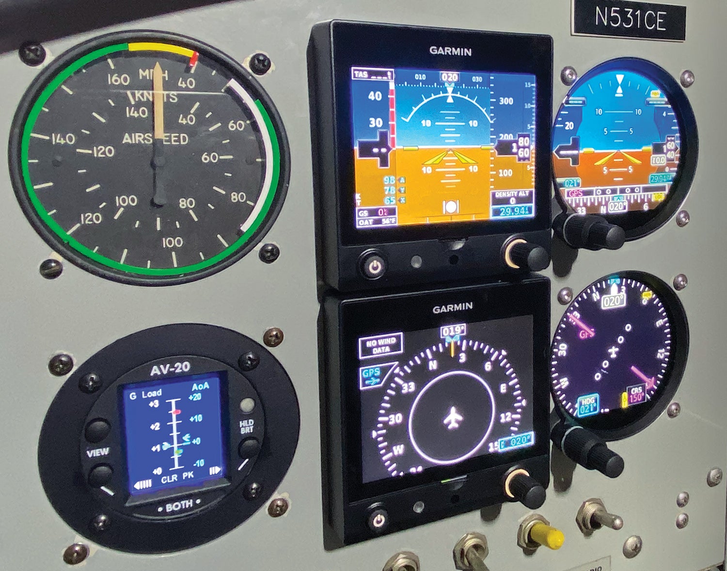

Because reliability is difficult, many of us resort to redundancy whenever possible. (The general exception to the redundancy rule is aircraft structure. Redundant structure is heavy, and structural design is actually a pretty well-known science. Building a reliable structure is pretty easy if we are not trying for the ultimate in lightness.) In fact, I generally design with the explicit assumption that any system I build is going to fail in flight. I then ask myself the simple question, “What is the backup plan?” If I require the ability to fly a precision approach to minimums, I might put in an ILS system. If it fails, how about a second one? Or… I could limit myself to flying where I am assured to never need better than a non-precision approach—or always flight plan so that a PAR approach is available within available fuel reserves. There are often alternative, creative ways of creating functional redundancy that don’t even add anything to the aircraft!
