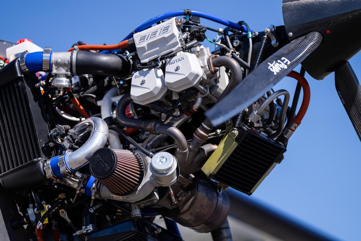

Second, Rotax has scored a big hit with the 916. Yes, it’s also expensive, but that extra increment from 141 to 160 hp has opened the door to new performance in several designs that were good on the 915 but are significantly better with the newer engine. Some of those airplanes would be even better with more power.

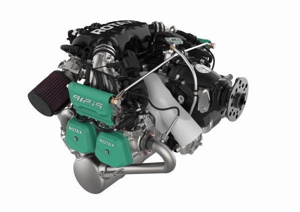

It’s worth looking at where the Rotax line currently fits to help see a potential future. Of course, the 900-series engines are small four-stroke, flat-four engines with a gear reduction drive and liquid-cooled heads. The gear drive allows these small engines, which displace just under 83 cubic inches, to rev higher and make more horsepower. Our traditional engines, unburdened by gearboxes are, in effect, burdened by the inability to rev much higher than 2700-2900 rpm with any usefully sized propeller. As anyone who bases at an airport with a Cessna 185 present, as I am, you know that a big Continental spinning 2850 rpm for takeoff with a large propeller is a gloriously noisy thing. But it’s not something you’d aim for with modern sensibilities or worldwide acceptance in mind.
By gearing the 900-series engines, Rotax allowed them to make more power than their displacement suggests but also to turn their propellers more slowly, which is good for noise and, to some extent, aerodynamics. The downside is weight and complexity, but the relative simplicity of the 900-series engines and their small size more than makes up for it. More advantages to the 900-series designs include modern combustion chambers—especially compared to the ancient chambers found in parallel-valve Continental and Lycoming engines, a good reason these engines need high-octane fuel to make decent power—and liquid cooling. In short, you can run a modern design harder—more compression ratio, more turbo boost—before destructive detonation begins to impact power and the liquid cooling further adds to the detonation margin.

But the 916 is. With 160 hp on tap for takeoff (limited to 5 minutes, then it’s 137 continuous), it’s working really hard. First of all, power-per-cube is a really impressive 1.93 hp/cubic inch. For that power, the engine has to make 145 foot-pounds of torque at 5800 rpm, a big jump from the 912’s figures, and that requires a BMEP of 263 psi. That is a huge number, one that really stresses the engine’s ability to resist detonation, which it surely only does through strict electronic control. If you’re old enough to remember the Cosworth DFV Formula 1 engine, you may be surprised to know it made its 500-ish-hp on a BMEP of just 230 psi. Oh, how our heroes have fallen. (And, yes, I know the DFV was not turbocharged…)

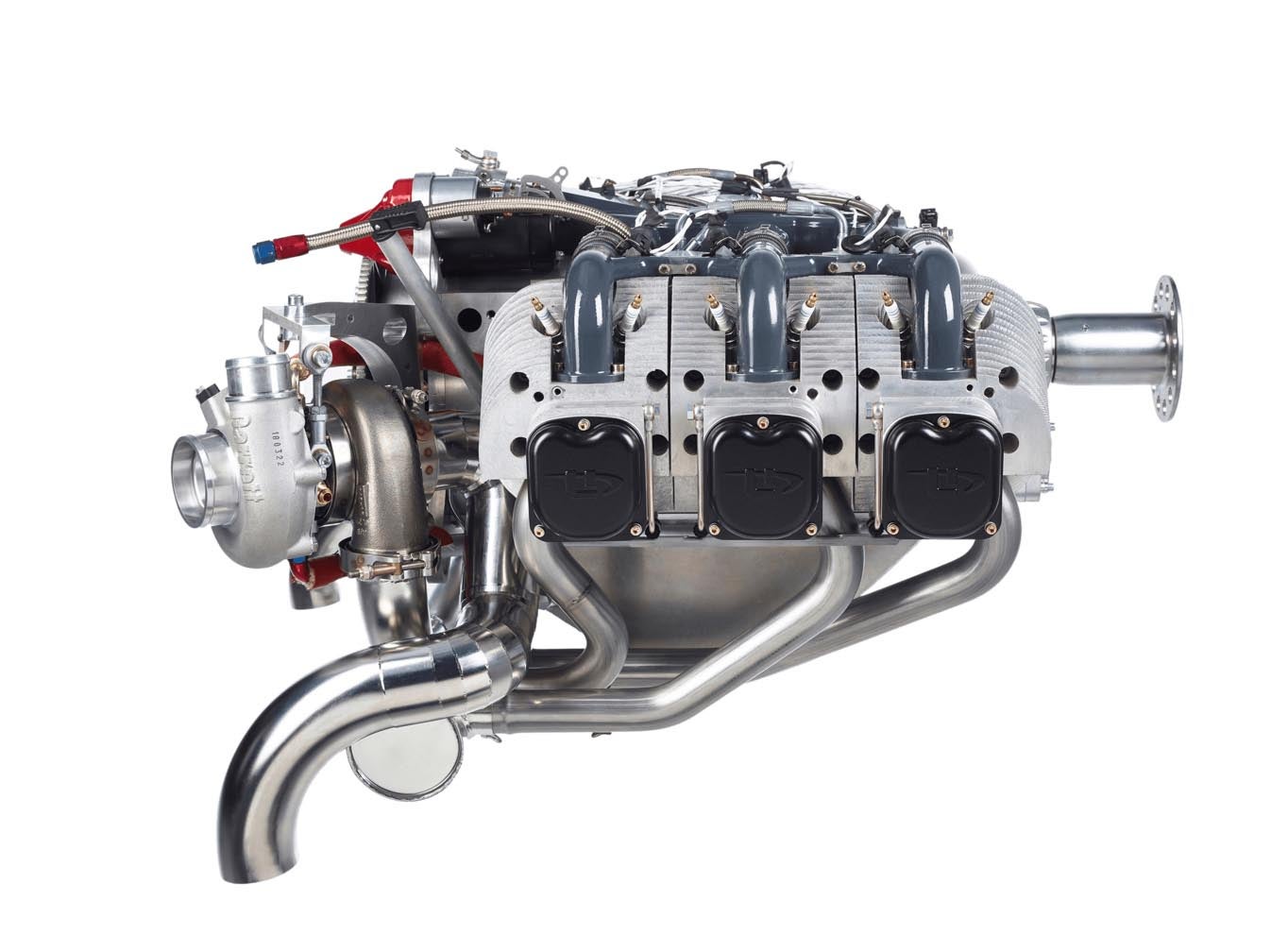

It’s worth noting that Rotax is not the only player in this space. The ULPower 520T engine is impressive in its own right. It’s a 321 cubic inch six-cylinder engine with, like the Rotax, two pushrod-operated valves per cylinder. (Truly, until you decide you need high revs, a two-valve head is plenty; until then, you’re just adding weight and complexity.) The 520T uses a modest amount of boost, just 38 inches for takeoff, and makes 220 hp at 2700 rpm. To do so, it’s making a phenomenal 428 pound-feet of torque from an almost-square bore/stroke ratio of 1.056:1. Heck, even a Lycoming is more “over square” than that, with a bore/stroke ratio of 1.717:1.
The ULPower’s BMEP is a modest 201 psi, above the naturally aspirated Rotax 912’s but well short of the turbo Rotaxes. I think in part this has to do with the ULPower being air cooled. No matter how nice the fins and effective your air-cooling scheme is, it’s really hard to beat the efficiency of liquid cooling. The offset is the weight and complexity of a cooling system, of course, but you have the opportunity to make much more power from any given displacement.

Already a 200 hp Rotax and it’s produced by Edge Performance in Norway.
Yep. “Tested to 202 hp,” and with a 1200-hour TBO. No doubt these are good engines, but the OEM market is going to want something with a 2000-hour TBO and not as highly tuned.
I’ve wondered if Edge is proving out Rotax’s concepts for them but per the numbers in the article, 200hp on the 900 series architecture is a reach too far, or at least farther than many single-engine pilots would be willing to make.
