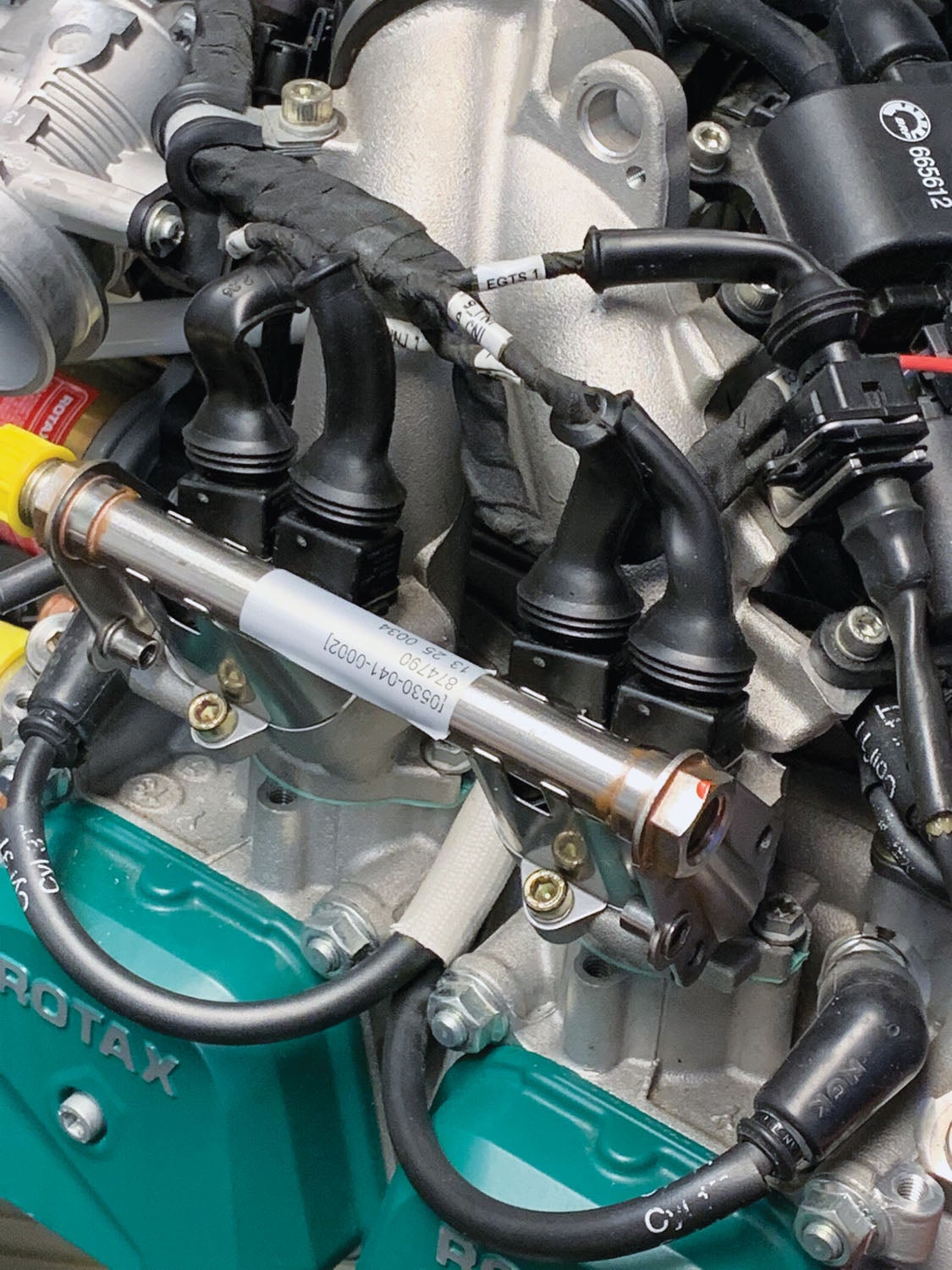

Boy, that first photo looks awfully familiar. OWW?
Yes.
