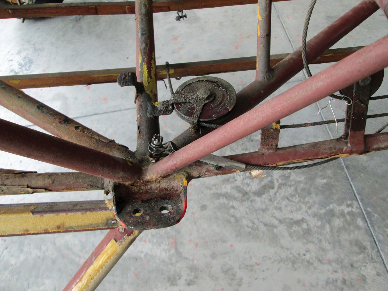

Before the tear off, take detailed photos of where the drain grommets are, where the inspection plates are, and where cable guides and other features are—and how they are handled as they come through the covering. You can even use the old fabric panels as a template if you tear it off in large sections.
Be sure to remove all of the fasteners and/or stitching before you start taking the fabric off. Take the time to find every single one. You can drill out rib rivets. Use a sharp utility knife to remove fabric, being careful not to damage the understructure. Take your time and take more pictures than you think you need. Keep a notebook with things you think of while you disassemble everything. Attach labels to parts. You’ll be glad you did later.
Once the fabric tear-off is complete, identify corrosion. Take pictures of the areas you’re going to repair for a before- and-after contrast to go in your eventual presentation notebook. Remember that one of the quality criteria the judges consider is, is the airplane equal to or better than a new aircraft? If the answer is yes, then you’ve got an excellent chance of getting attention. The way to do this is to assume you’re going to produce a cover job that looks even better than professionals in a factory could create.
If you’re building a homebuilt and the cover job is fresh and new, you won’t have to worry about the repair advice here, but you might need it later if you need to re-cover.
After repairs, get the structure as clean as you can and prime against corrosion. Epoxy primers are tough, long lasting and compatible with nearly all covering systems. Use the primer that is approved for the system you are using; most of them will also go nicely over existing epoxy and varnish. If you use the one-part spar varnish from the hardware store, the fabric cement will lift it…destroying all your hard work getting the frame ready.
Preparation is a great time to get intimately familiar with the instruction manual for your covering system. It is very specific on exactly what materials to use and how to use them. The reason that “preparation” is the number one mistake area is because people wing it. Don’t!
Now look for dents and imperfections. While these areas may not look bad now, once the covering is on, they will attract a critical eye as soon as you hang the “judge me” tag on the airplane. Use an epoxy-based filler—not Bondo—for imperfections. SuperFil works great.
If you’re conducting a restoration, consider replacing or rebuilding wings if the damage is extensive. While it indeed is a lot of work, the smooth lines and structure for a show plane finish will be there. It will also raise the resale value of the airplane.

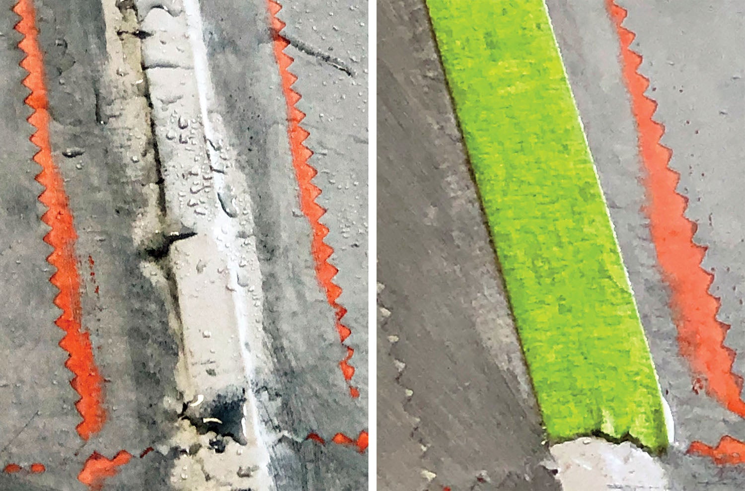

First, prevent problems in the first place by taking extra care in your sanding technique. All will go well until you come to a bump, a rivet, a clip or any other hidden protrusion that causes the pressure from your hand over it to shoot up. You don’t have to be as wary on the flats, but keep a lookout for surprises.
Oops! Stop and look. After this round of sanding, let everything dry and then use some Poly-Spray (silver) over the bare spots. The silver coats have aluminum solids embedded in them and protect the fabric from ultraviolet light. UV light will age fabric in a hurry, so we want to make sure the silver coats are adequate.
A trick you can use is to place a high visibility, good-quality masking tape over protrusions. It will stop you from accidentally hitting the high spots.
One welcome feature of the Poly-Fiber system is that you can eliminate much of this sanding by using heat smoothing before the Poly-Spray coatings. In fact, the more heat smoothing you can do ahead of Poly-Spray, the less work you will have. Use the small iron set at 225° and gently run it over the edges of the pinked tapes, any drips and on bubbles. Over time you will develop the feel for exactly how much pressure to apply. When you run your hand over the pinked edges, you’ll be able to immediately tell when you’re done. This will reduce the chances of you sanding through to the tapes later, especially in these areas.
After the pinked-edge tapes have been applied and are dry, apply another coat of Poly-Brush on the tapes. When this coat is dry, use the small hobby iron to smooth the pinked edges. Two more coats of Poly-Brush are then sprayed on prior to silver.
