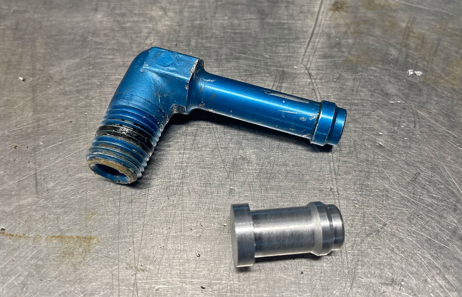

Occasionally, having the ability to turn or mill a part is handy, especially when you get to doing modifications or prototyping. Take, for instance, the other day when I was doing some temporary plumbing work on one of our airplanes, and decided to cap off the fuel return line which is no longer being used. You never want to rule out potential future use, so I figured I’d leave the plumbing in place but disconnect and block off the hose after removing the fitting from the tank. But how to plug a hose that was designed to fit over a barbed fitting? Hmmm…
With a lathe, it was simple enough—I measured the barbed end of the hose, chucked up a scrap of aluminum rod in the lathe, and duplicated the barb in solid form, leaving a “button” on the end to make it butt up against the end of the hose. The same cable clamp used to secure the hose to the barbed fitting secures the plug in place.
