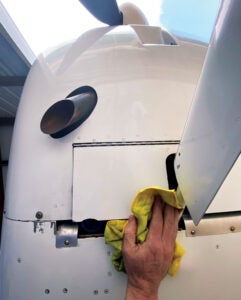

The typical aircraft engine—whether that’s a true-blue Lycoming, a so-called clone or even a similar large-displacement, air-cooled powerplant—might start out dry and clean, but it is not uncommon for leaks and drips to develop after a hundred or more hours. Things shift, seals take a set, and eventually you find that before you can do a decent inspection, you have to buy a jug of Stoddard solvent and a cleaning gun.
That engine cleaning is the first step in tracking down any leak. Airflow underneath a cowling goes in odd directions, which means leaks are not necessarily where you think they are. I have seen leaks from rear-mounted accessories show up as drops of oil on the starter—it’s all about how the air carries the oil around.
So clean things up—and I mean thoroughly, like you’re planning surgery in there—then go run the engine for a little while. If you think you have a big leak, run it just a short time or the leak will spread enough so that it is hard to localize. If it is a minor leak, clean it up and go fly for half an hour, then come back and de-cowl to check it out. If you started with a clean engine, the leak location should begin to give itself away.
