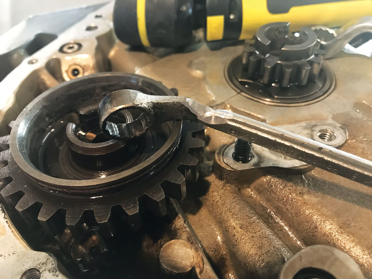

The infamous and legendary Lycoming Direct Drive Overhaul Manual is a wealth of information on disassembling, inspecting and reassembling these motors—but it doesn’t tell you how to do it. It is more of a reference manual than a step-by-step set of instructions and you’ll find yourself thumbing forward and backward frequently, trying to figure out exactly how things might be put together. A better resource is the Superior Vantage Engine Overhaul Manual, which was written to step you through the process and does an excellent job at exactly that.
The tricky parts of pulling a Lycoming apart are taught by one mechanic to another, but are covered pretty well in the step by step. The special tools you’ll want are cylinder-base wrenches and a slide hammer that has been modified to screw on to case through-bolts. Everything else can be done with standard tools. By the way, that little nut hiding under the camshaft gear can be removed with the 9/16-inch cylinder base wrench—though you might have to grind a little off the outside diameter of the wrench to get it to fit. Grinding wrenches is almost a tradition among Lycoming mechanics.

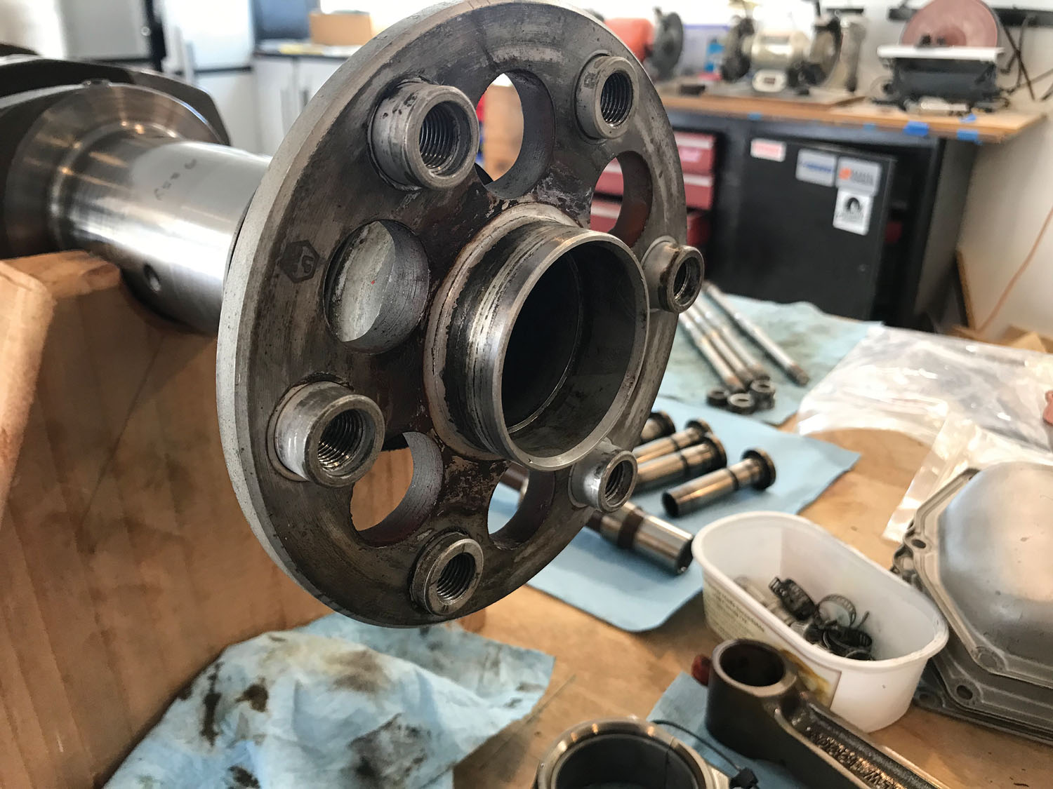

When taking the engine apart, it’s hard not to get pulled into the inspection mindset. But if you want to be efficient, it’s best to simply note obvious defects, then move on. Lay all the parts out on paper towels on a large workbench, and when you have things apart, photograph it all—or do it in groups. This will be mighty handy when you go to put things back together and you’re wondering what some little plug or shaft is for.
Organization is important because you’ll eventually be pulling all the steel parts together to go to one shop and the crankcase will be going somewhere else. Then you’ll have a bunch of stuff you need to hang on to while the expensive parts are at the machine shops. Keep it all organized!
Invest in a bunch of good shop paper towels—I like the blue ones—because every time you think you have all of the oil drained from something, you’ll tip a part and more will come out. Have some Stoddard solvent (mineral spirits is the same thing) handy for initial cleaning as you get ready to pack parts.
Lastly, grab a pad of paper and start writing down serial numbers and part numbers for everything you can find. The assortment of numbers on a Lycoming crankcase is astounding—but write them all down. The same is true for other expensive parts like the crankshaft, connecting rods and camshaft. You’ll want records of all these parts so you can verify that the right ones came back—and also in case you want to do any parts shopping because some parts only work with specific versions of otherwise identical parts.
Don’t forget to write down any numbers you can find on the bearing inserts for the crankshaft. These bearings have changed over the years and the parts department will need to know exactly what you have in order to send you the correct parts later. Lastly, if this isn’t the first overhaul of your engine, find out if the crank has been previously ground and figure out how much. This is so that, again, you know which bearings you have. The crankcase overhauler will grind to a new oversize regardless and tell you which bearings are needed. But it’s a good idea to know where you stand before they begin.

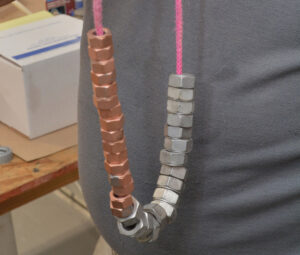

You can start with bags of nuts and bolts. One at a time, dunk them in solvent, hit them with a wire brush and do whatever you do to clean them up. I like to make a bolt block out of a piece of 2×4—just drill a bunch of quarter-inch holes in the wood—then stick all the bolts in and clean up the heads in my blast cabinet. Don’t blast the threads if you can help it—they won’t fit as well.
