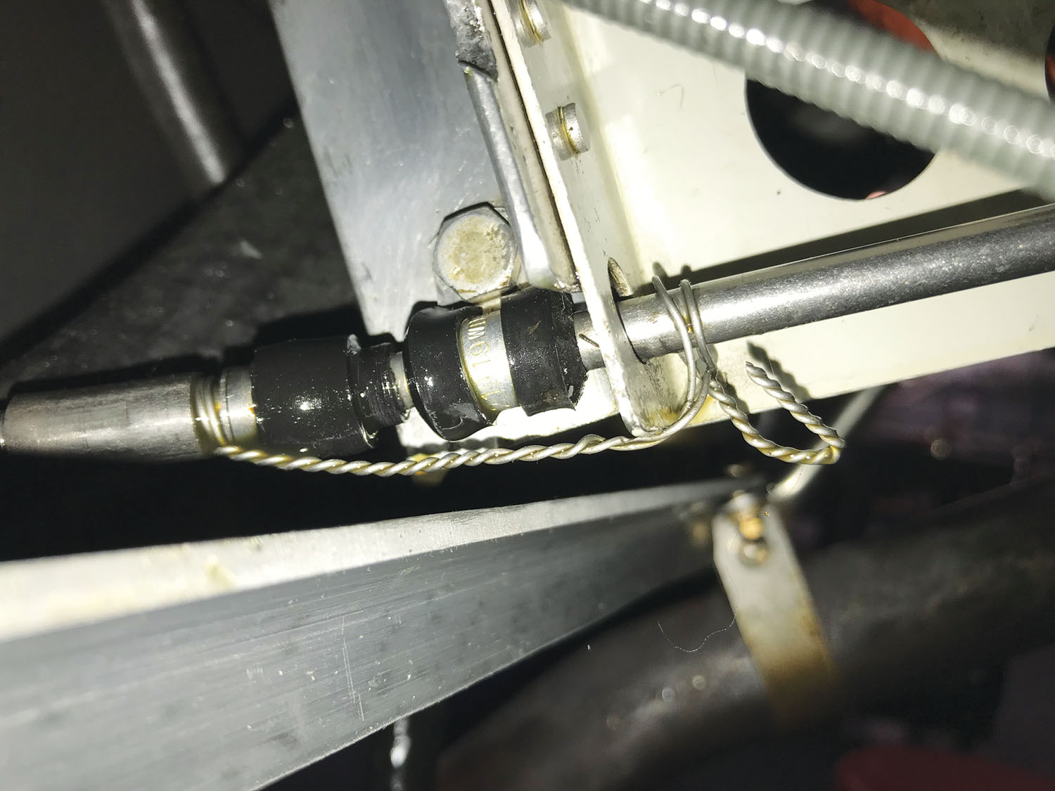

It began with a stumble. A normal takeoff, followed by turning off the boost pump, and the engine on our RV-6 stumbled. A quick look at the fuel-pressure gauge showed the problem—low pressure at full throttle. When the boost pump was switched back on, things returned to normal. A little experimentation (above the field) confirmed it: The airplane was ready for a new mechanical fuel pump.
And so it began.
Our Van’s RV-6, serial number 20004—that’s right, just the fourth kit—came into my future wife’s life about a thousand flight hours ago. The engine already had 1400 hours on it, and the prop had been resealed shortly before her purchase. She put a lot of cross-country hours on the plane, both before and after we met, and because of the higher-time engine (a first-run factory-new Lycoming), she started regular oil analysis with each oil change. We’ve kept that up in the years since.
This RV’s carbureted O-360 has been a reliable powerplant, with good compressions and excellent oil numbers for as long as I have cared for it. But with 2400 hours, it was only a matter of time before we started seeing signs that it might be getting tired. The fuel pump was telling us something—it was a sign that we might be getting to the end of a great run. With the airplane grounded until I replaced the pump, I ran it up and did the compression checks. Three of four cylinders were at 72/80 and one at 68. That’s a bit of a drop since the previous year, but within a range most owners would find acceptable. Still, it was another sign.
Pump It Up
I ordered a new fuel pump and steeled myself for the swap. The back of the Lycoming is pretty close to the firewall on the RV-6—not as bad as on our RV-3, but bad enough. It was an honest four hours’ work to get the new pump installed and safety wired, but since the airplane was due for its condition inspection the next month, we decided to do more than just the fuel-pump swap. We decided to go through the RV’s front half while it was opened up. And that, of course, was when we found the cracks in the engine mount.
The RV-6 (especially early versions) is known for experiencing cracks at the lower corners of the engine mounts, right where the gear legs meet the mount and the mount meets the firewall. Gussets were added to later versions—as they were to the mounts for the RV-7—but this one had never been modified. We check it every year, of course, and had never seen any problems. This year, though, the crack on one side was painfully obvious, and the other showed suspicious bubbling of the paint. A little wire brush work confirmed it—the mount was going to need a welder’s torch.
That, of course, meant that the engine needed to come off. I was a bit annoyed that the fuel pump change would have only taken about 10 minutes with the engine hanging from a hook—so there were four hours of pain and scratched hands down the drain. But that was a much less significant issue to the obvious question—if the engine had to come off anyway, was it time that we go ahead and do the overhaul?
