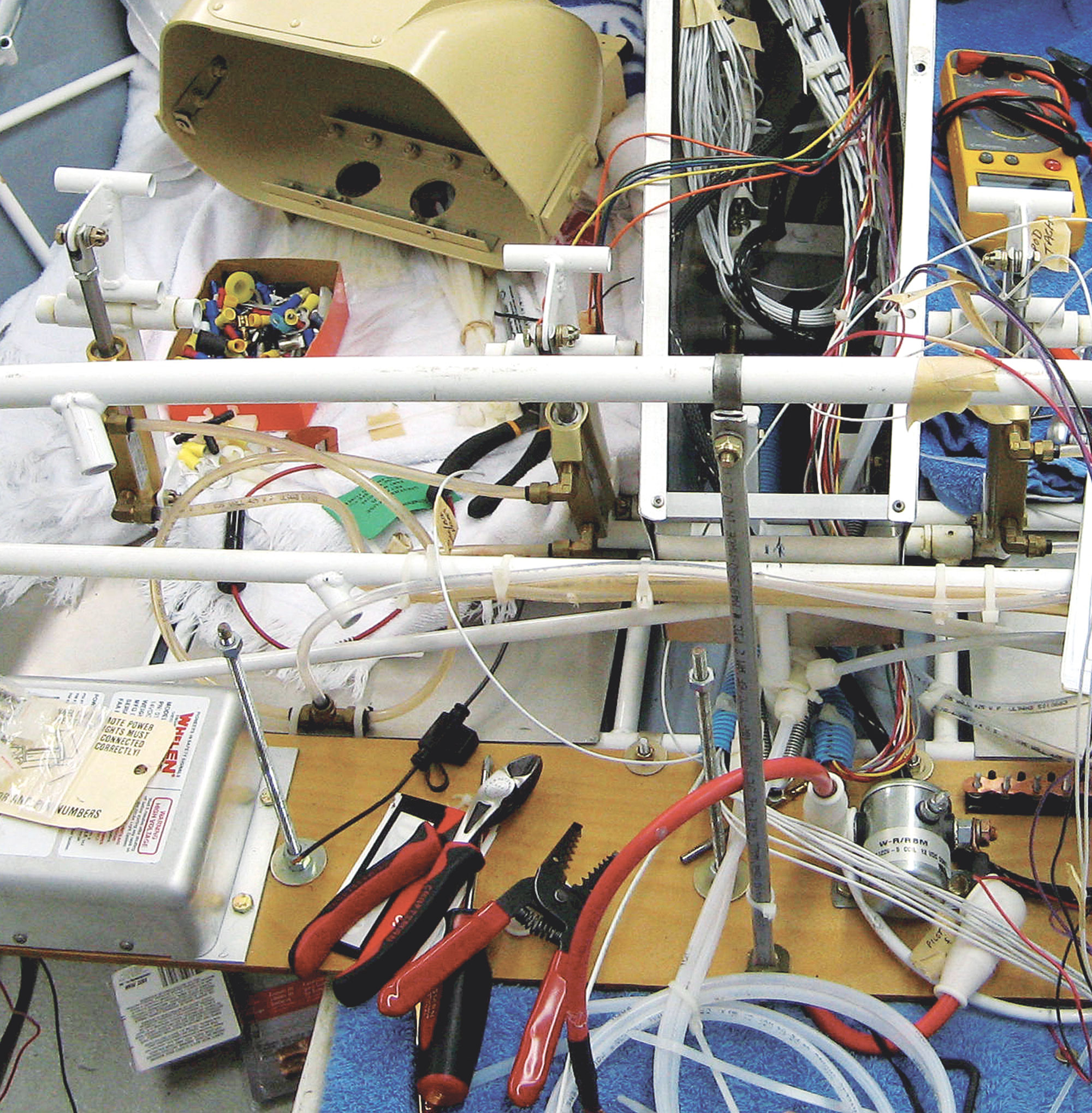

“I can’t figure out why the radio stopped working,” said Bill. The instrument panel was upside down on the top of the cowling.
Cindy looked at the mass of wires and shook her head from side to side as if to loosen stray cobwebs from her face. “That’s a rat’s nest.”
“Hey! Be careful with the praise. I’m no electrician. Everything was working. I only have 20 hours on the airplane.”
“Did anything strange precede the failure?”
“Yes. A hard landing.”
“Then I know what it is.” Cindy pulled her glasses out of her shirt pocket. She examined the wiring leaving the back of the panel. “Here it is.” She pointed to a bus bar with a disconnected wire. “You used fork terminals here; you should have used ring terminals. None of these are tight.”
It was time for Bill to shake his head in dismay. “OK. I’ll get on it.”
“Be glad it wasn’t worse than just losing radio power. I recommend tracing and labeling these wires and lacing them up so vibration doesn’t cause problems.”
What does the wiring in your project look like? Since you are reading this magazine, it probably looks excellent. Everything is labeled, wires are Tefzel or Teflon, you have bundled the wires neatly and used wire ties or lacing to secure them.
In my work as a technical counselor, I see all manner of strange things on airplane projects. The electrical systems contain an assortment of automotive wiring, multiple power and ground blocks, a mix of fuses, a lack of labels and plastic hobby-type terminals. If one ground wire is good, lots of them are better.
Don’t misunderstand; 80% of the projects I visit have very good workmanship. But the rest need help. It’s not deliberate, either; it’s simply a lack of understanding around what the standards are and not taking the time to study the directions. Here are a few tips for electrical systems.
