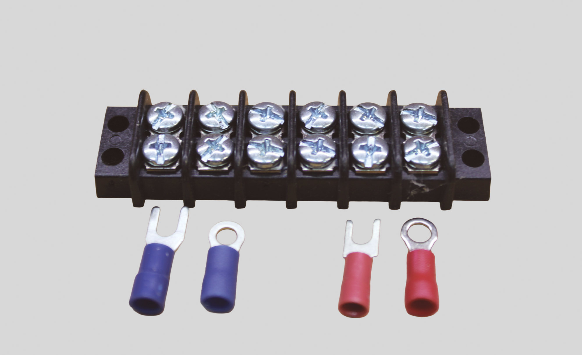

Tefzel or I-PVC, you still have to handle interconnects between wires other than with large expensive “twist lock” connectors. Especially with homebuilt aircraft, the capability of being able to remove one piece of electrical equipment and install another without completely rewiring the aircraft is a necessity. Born out of the requirement for a relatively simple way of changing avionics around during WW-II and thereafter, the lowly terminal strip has evolved from a large clunky hunk of pressed paper, rivnuts and such to today’s Bakelite and inlaid nuts in all screw sizes from #2 to huge. Crimp terminals also have evolved to a rather stylish combination of plated copper terminals with a PVC insulator.

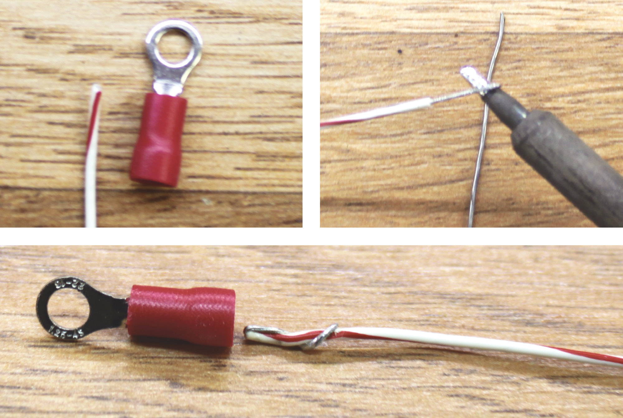

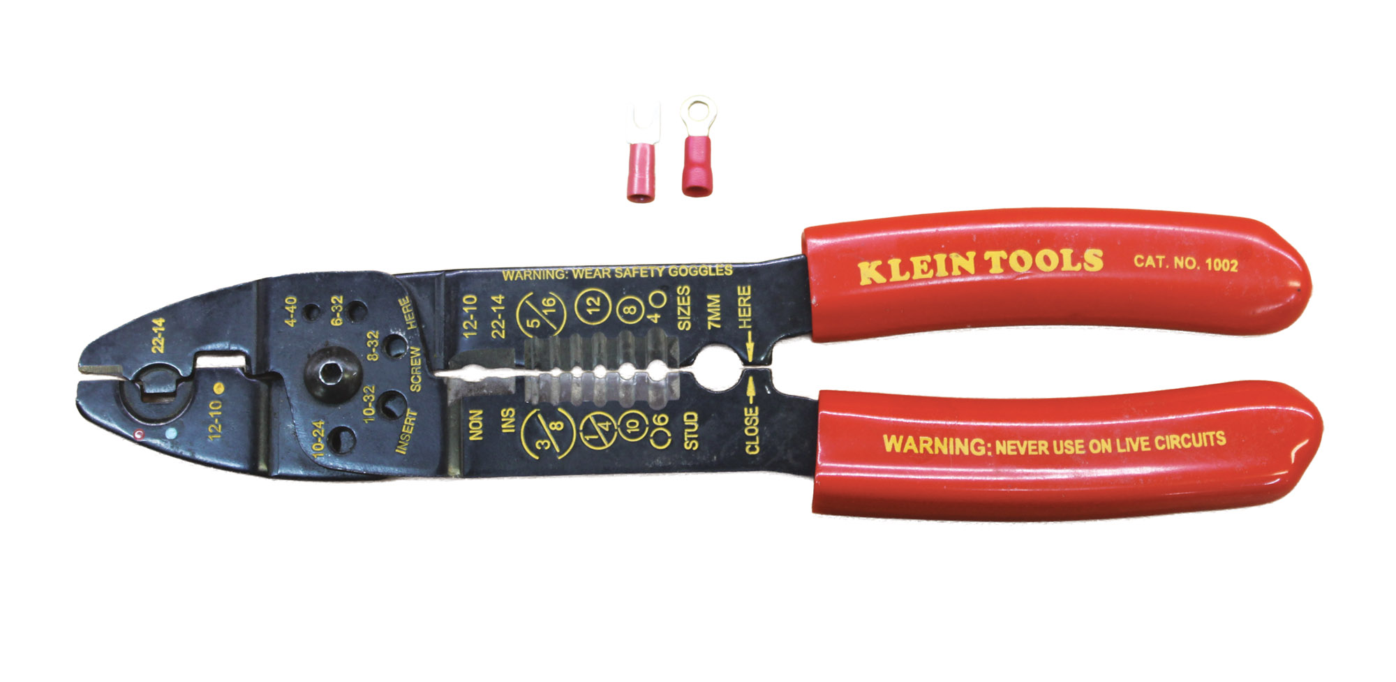

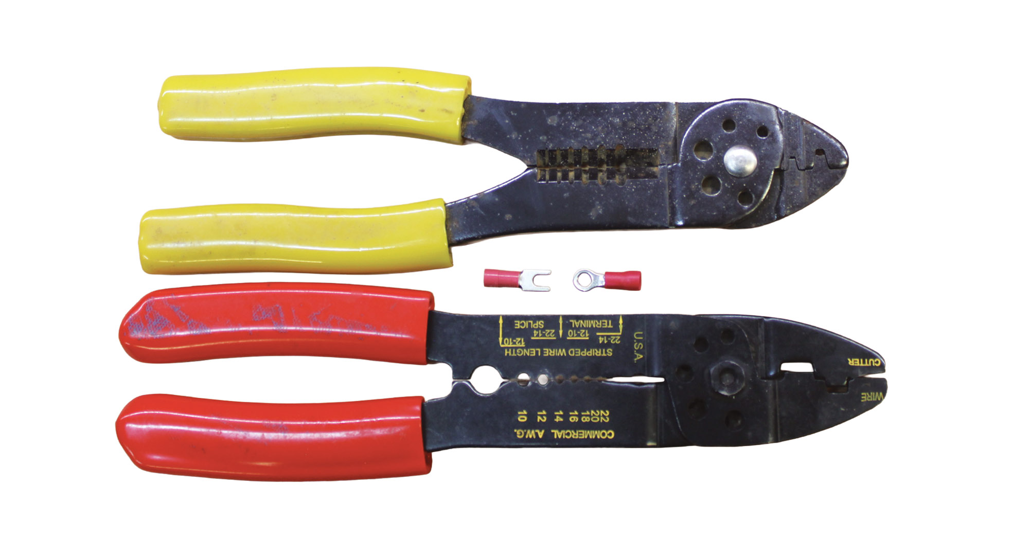

Trick #1. Crimp terminals stop at #22 wire, but #24 is common for very low power and signal wires in the aircraft. Trying to crimp a #24 wire into a #22 terminal is a recipe for failure unless you use an old-timer’s trick. Strip the #24 wire to the length of the insulator. Tin the wire. Bend the tinned wire back over the wire insulation. Now spiral the tinned wire over the wire insulation, insert the wire into the terminal until the wire is just visible at the end of the insulation. Now crimp the spiraled wire into the terminal.

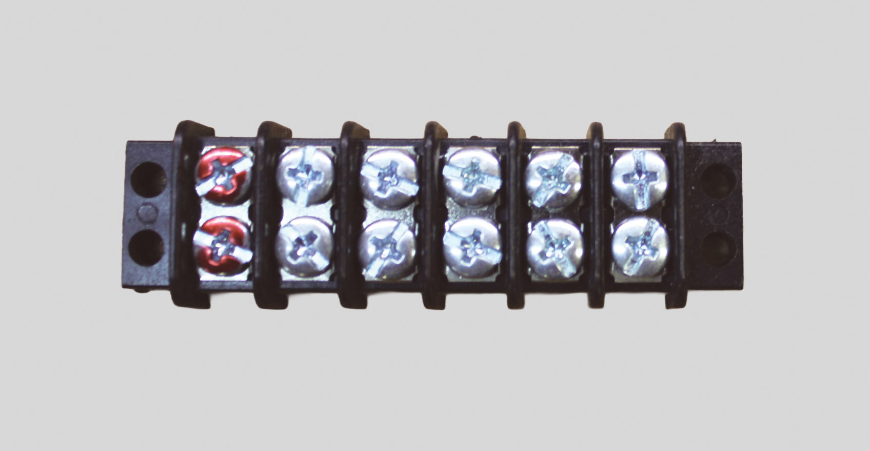

Trick #2. Trying to connect two crimped terminals to one terminal strip screw. Flip one of the terminals over so that the ring part of one terminal lies flat against the ring terminal of the other terminal. Now put the screw through this assembly and fasten.
Trick #3. Trying to connect a lot of wires to the same circuit. Generally, this involves trying to connect a lot of wires to the +12 power supply and also to ground. Daisy chain the +12 wires to adjoining terminals on one side of the terminal strip and then connect the equipment, one or two wires at a time, to the opposite side of the strip. Same trick for all of the ground wires.
