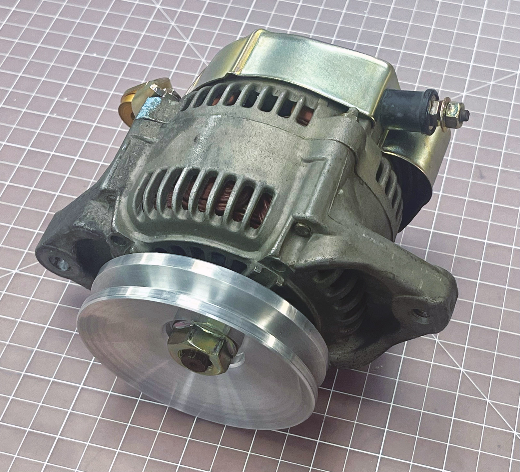

The alternator uses a pretty straightforward mount. In fact, my engine came with a mount that puts the pulley in the right location, perfect. This particular unit with the stamped steel bracket attached can be located as an OEM replacement for a 1986 Suzuki Samurai (BBB Industries N14684).

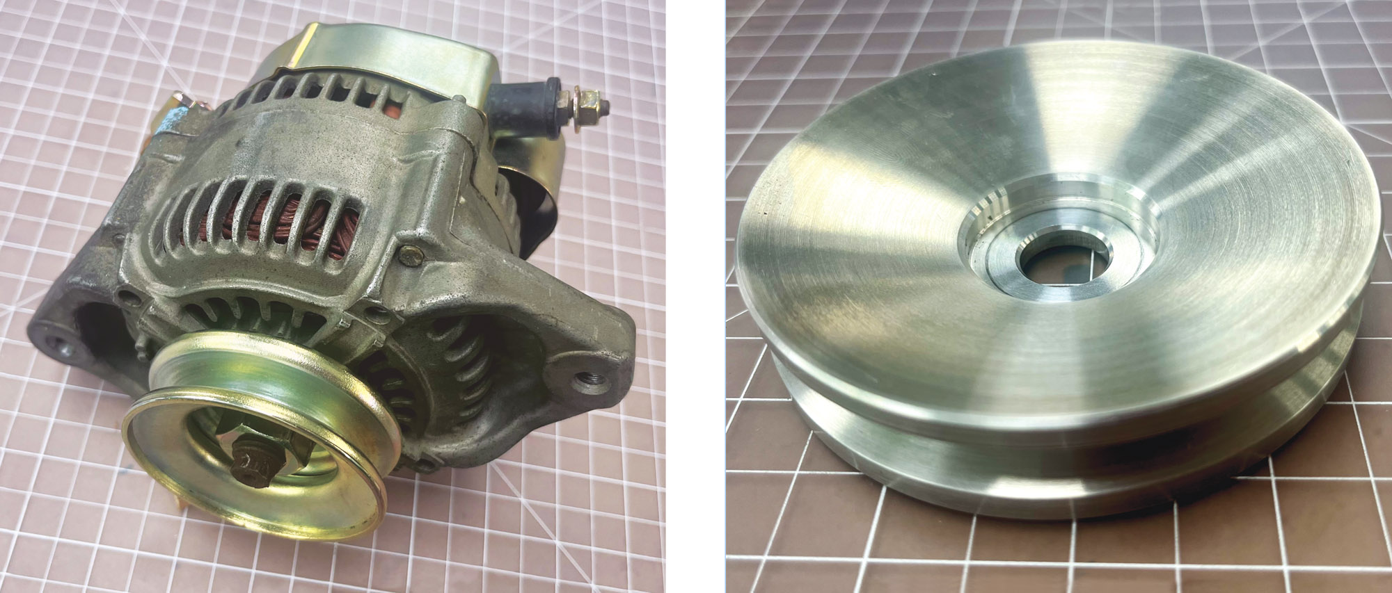

Next is the belt connection, or pulley. Once again, I am not immune to the gravitational pull of forum rabbit holes and my searches revealed sparse accounts of premature bearing failures and even fewer regulator failures for these alternators. More searching found one or two instances of machining a custom pulley, but no dimensions were given.
I researched further into these Denso alternators and found the recommended max operating rpm to be around 9000 and that full current output (60 amps in this case) occurs at around 5000 rpm. It should be noted that Denso advertises a torture test that cycles between 0-22,500 rpm. Some hand calculations based on automotive pulley sizes reveal that 5000 rpm at the alternator occurs when automotive engines reach 2000-2500 rpm due to the crankshaft pulley measuring about twice the diameter of the alternator pulley, roughly speaking. This all makes sense and perfectly matches the application. The alternator will spend most of the time near full current output during normal driving while being limited to short bursts at higher rpm and short periods at idle.

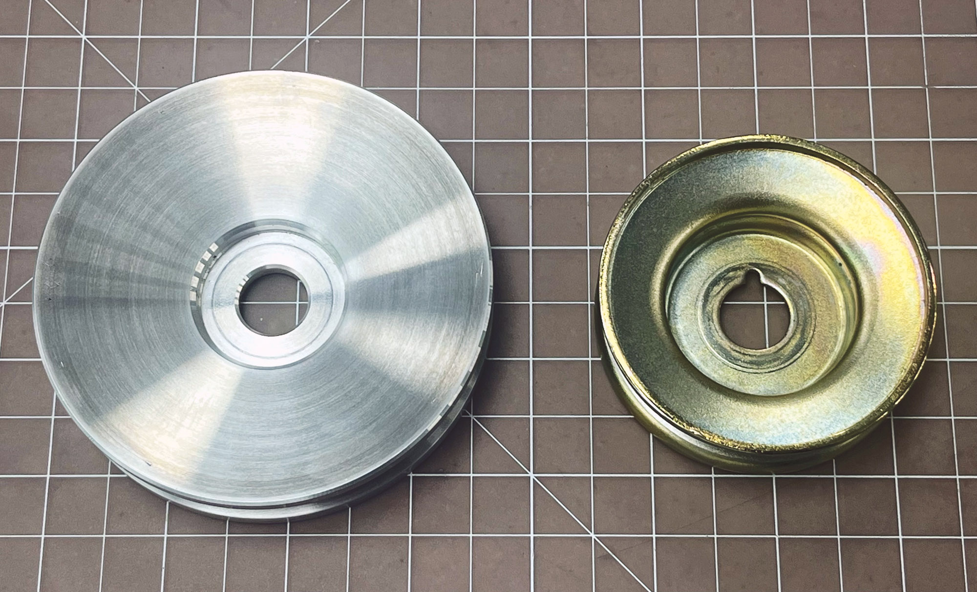

This means the alternator will be spinning near its max rpm, but continuously. The alternator will work just fine here; bearing operating limits are very well understood, and you can even plug these conditions into an online bearing calculator to estimate the bearing life. From my perspective, this operating condition means two things relative to the automotive installation case: shorter bearing life and more heat generated in the alternator. Let’s solve both of these with a new pulley.

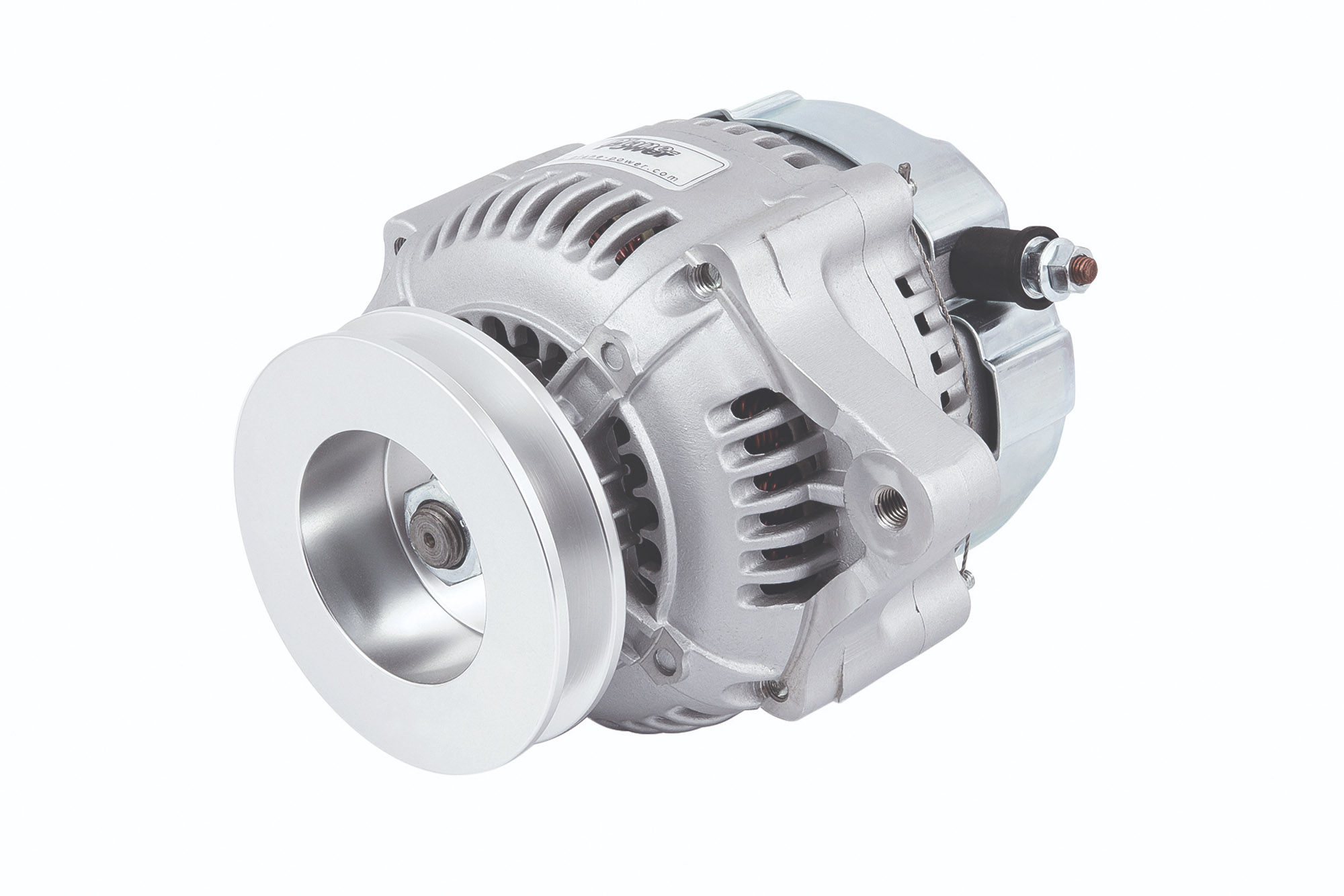

If you look around at aviation alternators based on this design, you’ll notice visually the difference in pulley size compared to the original automotive one.

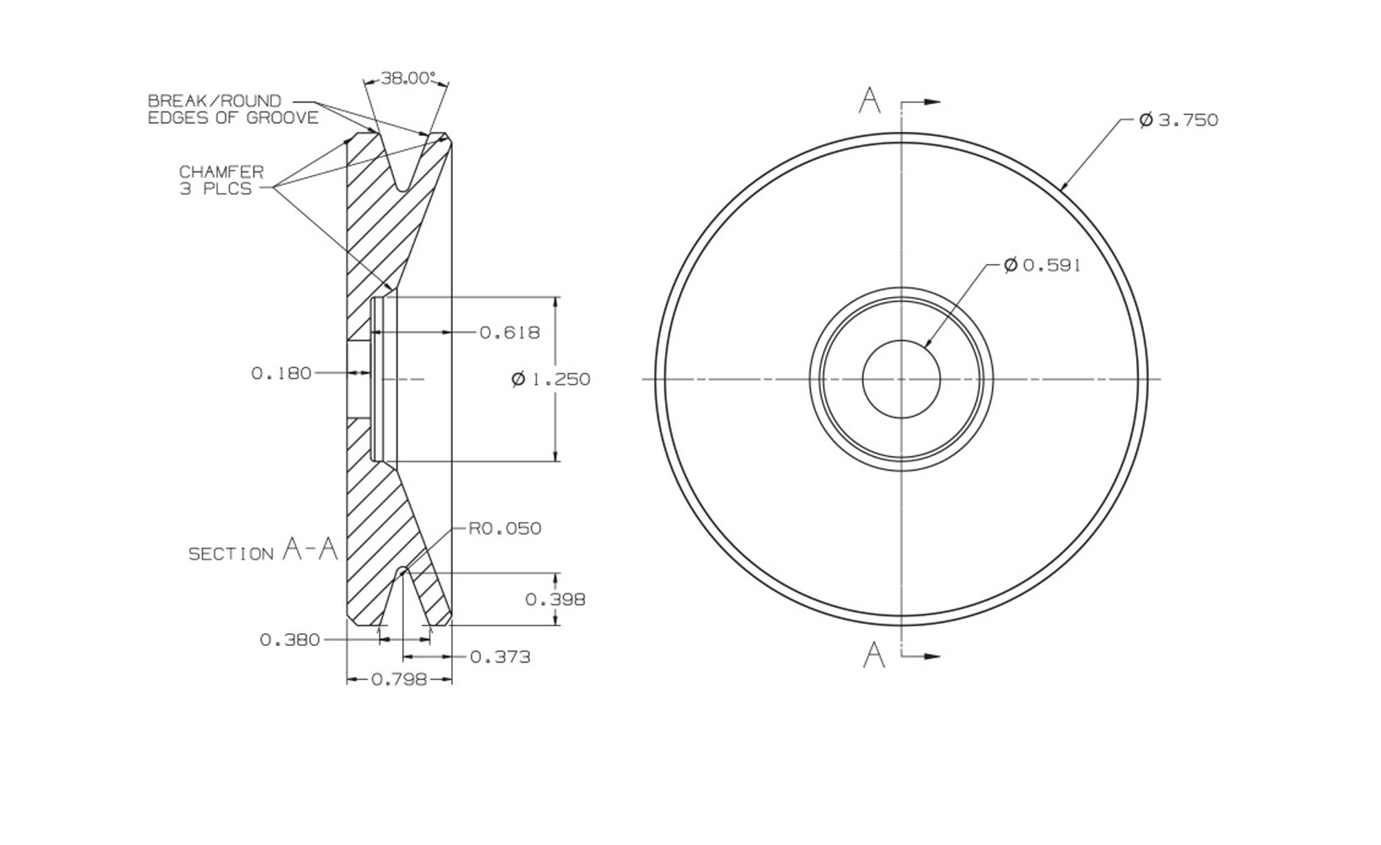

I decided to shoot for a more moderate 6500 rpm for the alternator in cruise flight. Some quick math determined the pulley must be 3.75 inches diameter to achieve this.
I designed the back flat and left the maximum thickness on the bolted interface while ensuring proper nut engagement. Make sure the counterbore is large enough for the socket, not just the nut. One variable that was a challenge to determine was the included angle of the pulley groove. Various sources report numbers from 34° to 40° for standard V-belt pulleys. I settled on 38° as a compromise.
This turned out to be a pretty simple lathe project: bore, counterbore and use the compound for the angles (a form tool of this size risks causing chatter in a plunge cut).

The pulley looks great, should be plenty strong being from 6061-T6 and will drop the rpm as desired. If during testing I find I am completely wrong and decide the current output is not enough in cruise or at idle, then a slightly smaller pulley can make the compromise. The last step is to drop it off for gold anodizing, which I need for, uh, corrosion protection. Nothing to do with fancy appearances, I assure you.
