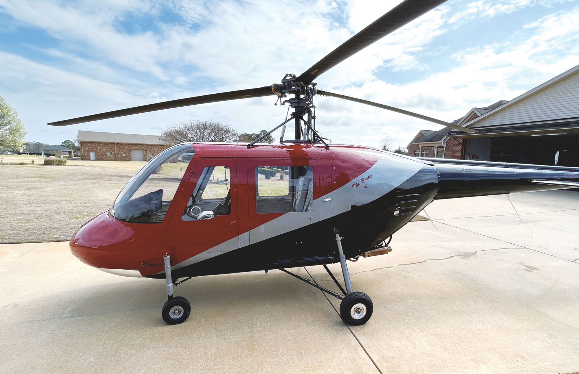

So it happened on February 21, 2023, just a year and a few weeks after I started construction, that N300VC was granted a Special Airworthiness Certificate!
Yes, I’ve been through this eleven other times, but this time it felt surreal. I had just built a helicopter, and much of it was a learning process, which is why I wanted to do it in the first place. With all the other aircraft I had completed, I was ready to fly them right after the inspection. Not so much in this case. Truth be told, I had a little gnawing in my stomach as to whether I should even perform the first flight, as I was still a low-time helicopter pilot.
