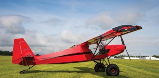

On aircraft with folding wings, such as those from Kitfox and RANS, one needs to be careful to mount all wires and tubes on the forward side of the aft spar bolt. If not, when the wings are folded, any wires or tubes on the aft side of the bolt will be crushed, as evidenced here.
—Vic Syracuse
