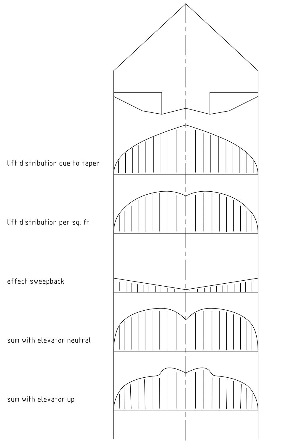

The aerodynamics of the delta-wing configuration are unusual. Verhees says, “Tailless designs need sections with pitching moments nose-up. Together with a center of gravity that is ahead of the aerodynamic center, it gives a stable aircraft. There must always be an aerodynamic moment keeping the tail down.” With increases in airspeed from inadvertent descents, he wrote, “aerodynamic forces will win over the mass forces and put the tail down—and vice versa.” With a (symmetrical) NACA 63018 airfoil at the root and 63010 at the tip, Verhees says, pitch-up comes from upward deflected elevons—more so at slower speeds.
To quote him directly, “The aerodynamic center with zero pitch moment is at one-quarter chord with every section. The delta has a tapered wing with sweepback; some of them have multiple sweepbacks. So, finding the aerodynamic center is not so easy. If you take the quarter-chord line and take into account every lift distribution along the span as [the] equivalent of the chord, things can go wrong because the lift distribution is not proportional with the chord. There are parts of the wing that have a higher load than others. This depends on the planform.”
Center of gravity is not so critical, he says, because of the wide chord. Still, he recommends launching flight tests with a forward CG “to be sure of positive stability.”
For a variety of complex aerodynamic reasons (Bart would be happy to elaborate for you—his English is very good), stall behavior in designing a delta-wing configuration requires specific attention. “The delta wing is not so safe when it comes to stalls. [It] will first occur somewhere between half span and the tip, resulting in a wing dip and spin. This unsafe stall behavior is counteracted in the D2 by making the planform more elliptical and placing the elevator at the outboard section of the wing.”
