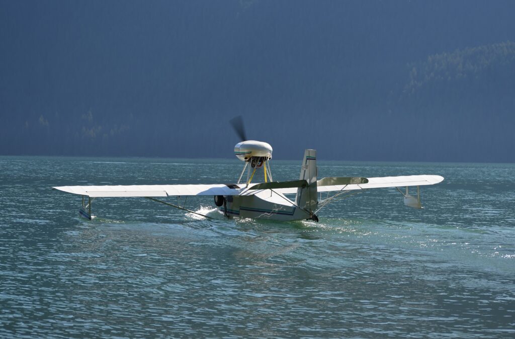

Volmer VJ22 Sportsman
This wooden amphibian, designed by Volmer Jensen in the late 60’s and built by Bill Eby over a period of five years. First flown in 1970, 55 years ago and he flies it to this day. The Sportsman was built in Kitchener; Ontario beginning in 1965 and finished 5 years later in 1970. The black and white photos show the complex nature of a plans built wooden aircraft. Every part had to be painstakingly handmade from the designer’s drawings.
Colin Walker next to his Volmer VJ-22 Sportsman fuselage during construction.

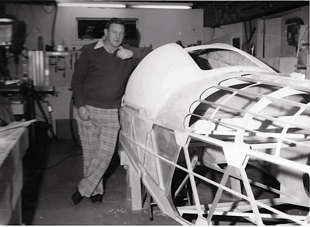

Colin Walker next to his Piel Super Emeraude fuselage during construction.
Eby who now makes his home in the skier’s mecca of Whistler, BC is able to land on Green Lake and taxi to his private dock.
Powered by a tractor mounted 125 hp converted GPU (Ground power unit, purchased for $250.00) As recommended by the designer, Champ wings located, purchased, repaired, and covered before being installed.
Among the modifications, the most noticeable is the change from a pusher to a tractor mounted engine requiring that Eby design a totally new mount. Less noticeable is the gear retraction method. The original design called for a large lever located between the seats that had to be raised and latched to a fitting near the roof. He designed a crank and chain mechanism that while it requires 35 turns to raise or lower the wheels, is much easier to operate than the afore mentioned lever.
Cost to build in 1970 dollars: $5,000.
Eby updated his amphib in many ways after a time in storage as he was preoccupied with building a 40 foot catamaran. Included in the updates was the installation of some “glass” and an autopilot capable of following a preset course and all important 180 degree turn.

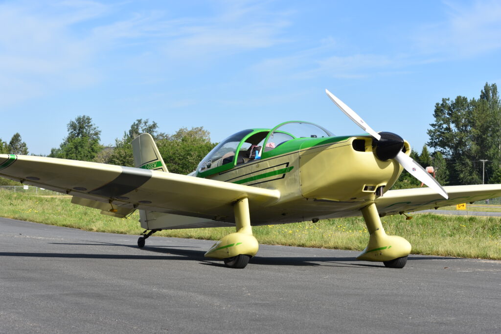

Piel SUPER Emeraude:
A cabinet maker who was renowned for his woodworking skills, the late Colin Walker hand crafted this all wood beauty over a period of ten years, completing it in 1980 at a cost of $10,000.00. (this converted to 2025 dollars would be north of $36,000)
Another classic home build by Colin Walker, this one the Piel Super Emeraude.
I had the opportunity to visit his basement shop in suburban Vancouver and admire the complex elliptical wing then under construction. I recall some lighthearted discussion about finding a transparent covering as it would be a shame to hide his exemplary woodwork. However the final covering and finish is more conventional and remains unchanged to this day.
Today the Emeraude is owned and flown regularly by his son Sean who has known the plane since birth. In addition to the usual local flights to flyins and airshows, he has flown numerous trips to Ontario, a round trip distance of 8600 kilometres; that’s 5300 miles for the metrically challenged.
Sean, while adding some 600 Emeraude hours to his logbook is carrying on with his father’s reputation for skill and tenacity as he nears completion of an exceptional Glasair Sportsman 2+2.
