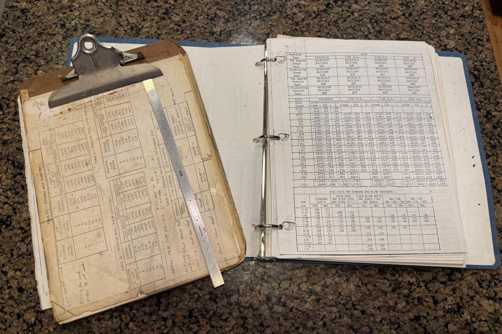

![My 36 year old clipboard from when I started at Boeing. Engineering ruler and fastener/fastener hole cheat sheets. [Credit: Andrew Robinson]](https://www.kitplanes.com/wp-content/uploads/2026/08/Liaison_clipboard.jpg?resize=1024,682)
