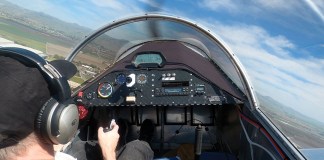

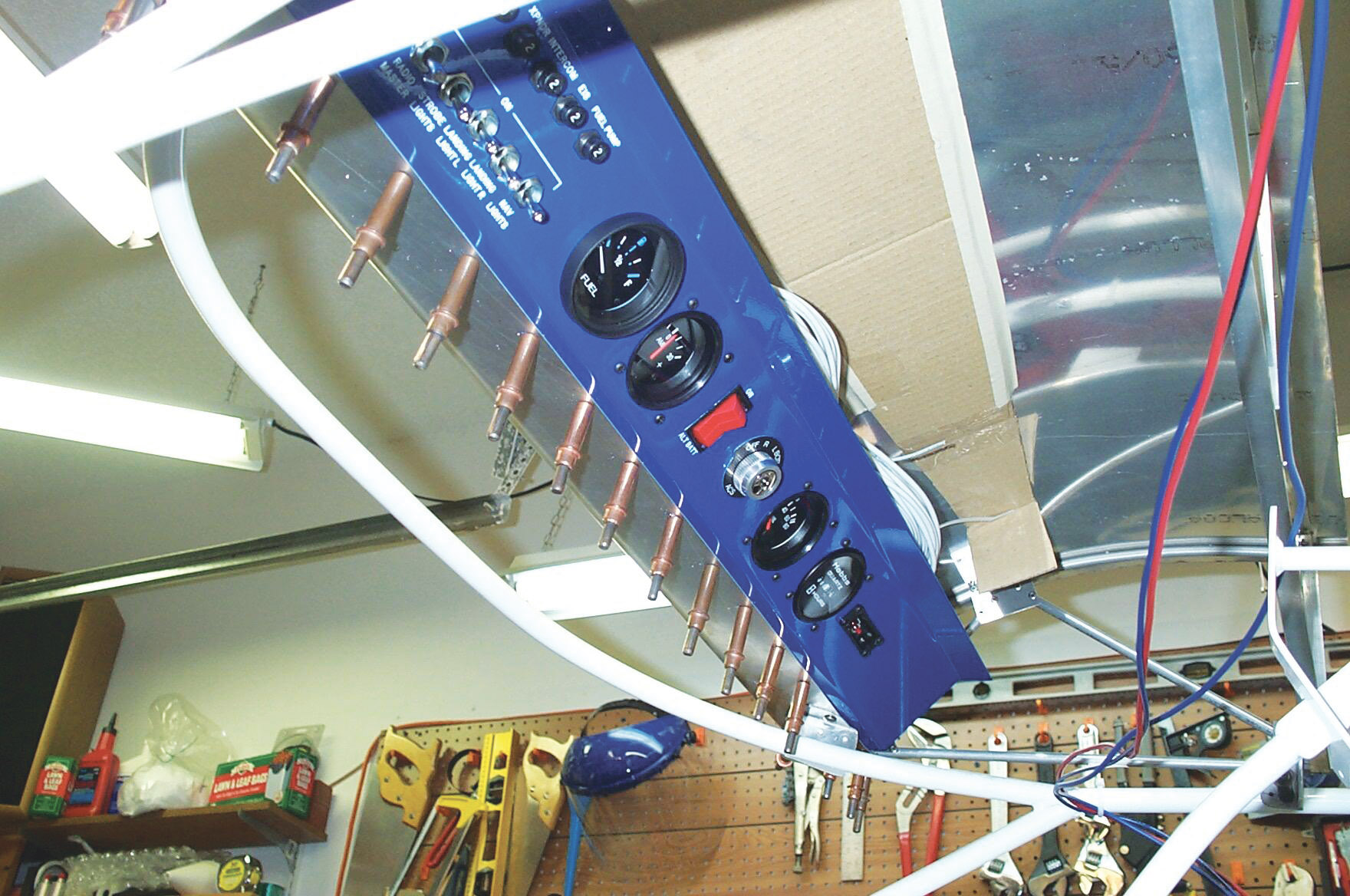

Overhead panel or a reconfigured main panel. In an airplane without a sliding or hinged canopy, you may have some room overhead. In my Kolb, I placed the ignition switch, breakers, and gauges overhead. It looked cool and turned out to be very handy.

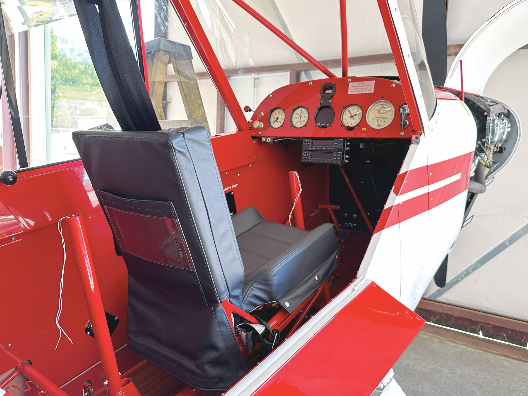

Seat cushions. If the seats in your homebuilt are not adjustable—and many are not—make up a variety of cushion sizes to accommodate both yourself and your passenger. This is also a selling point; make the seat big enough (think legroom) so that the next owner can easily fit, using the cushions to adjust.
