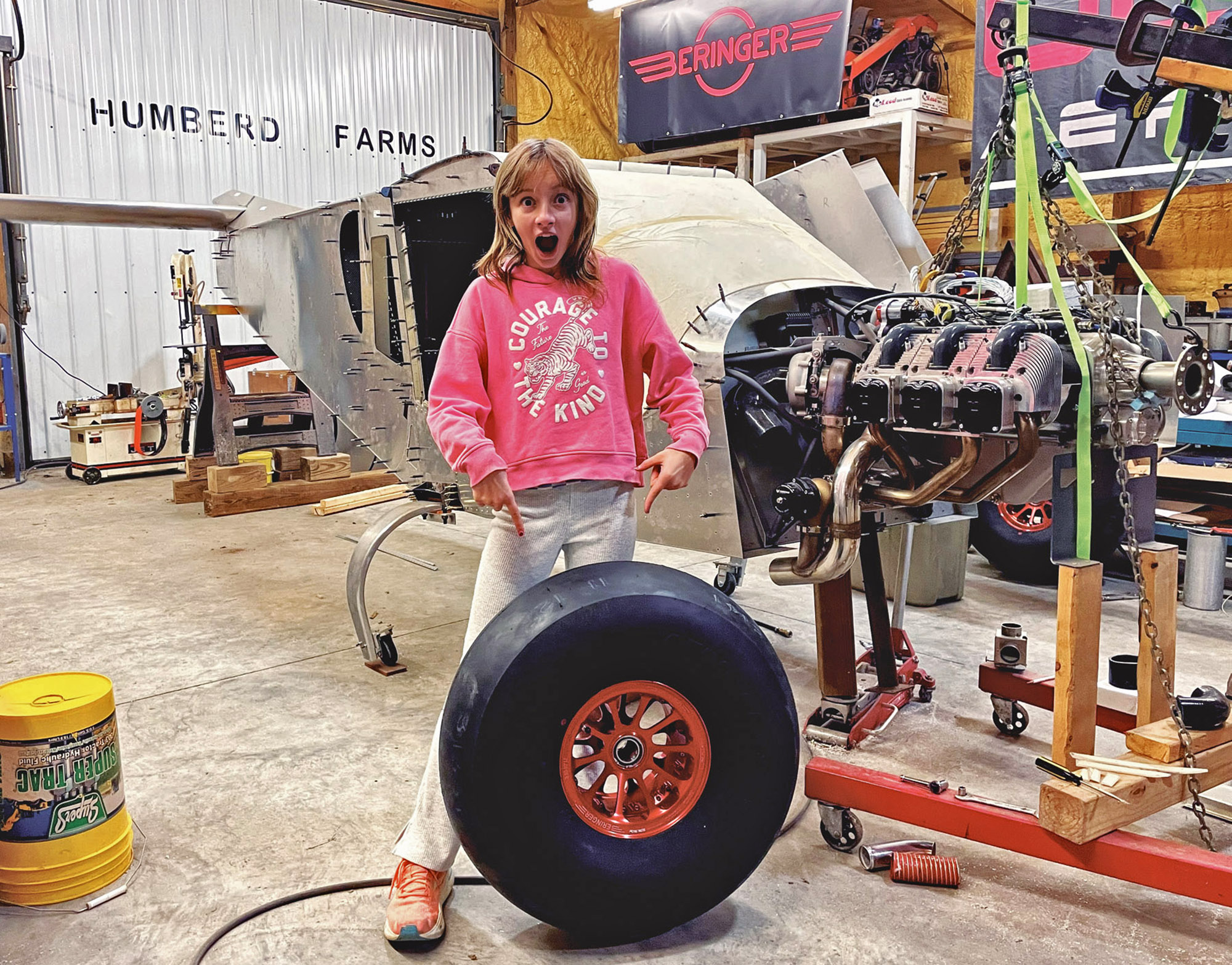

High power and low weight already help performance but I’ve gone a bit further. The short engine mount I’ve designed and built moves the engine back 6 inches from the original, which will make a considerable difference in the empty CG. I have noticed that Zenith airplanes are designed and usually built with an empty CG that is pretty far forward. When the airplane is loaded with fuel, passengers and cargo, the CG moves toward the middle of the range. Note that there is a fairly large envelope for the CG range in these Zenith airplanes. This is smart design on Zenith’s part for the typical mission the 750 SD will see.
Its aft CG is one reason the Super701 has performed so well in demonstrations and competitions, so I’m following the same approach with the 750 SDX. I have pulled information from several weight-and-balance spreadsheets of built 750 SD airplanes and have done all kinds of calculations to try and get an idea of how mine might come out. But it is really a best guess at this point. Even though I am still quite a ways from it, I cannot wait to get this thing on the scales so I can begin to see where it is actually going to fit within the wide CG range.
On a closing note, the long awaited 29-inch tires have just arrived as I am turning in this article, so next time we will indulge in the special tires, wheels and brake system—and the modifications required to make them all come together for this 750 SDXtreme.
