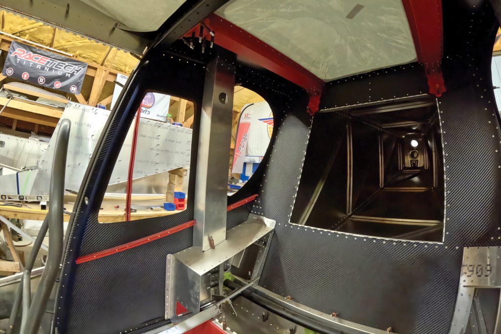

You might wonder why I need a new skin since you have already seen this plane’s fuselage mostly assembled for quite some time. This all pivots around my indecisiveness and ongoing debate of whether I actually want to incorporate the bubble top window into the rear fuselage. I have gone back and forth with this decision many times since I started the CH750SDXtreme build.
My most current train of thought is telling me to get rid of the top window completely and replace the rear top skin with a new skin that does not even have a cutout for the window. Simpler, lighter, and less plastics that would ultimately need to be replaced at some point down the road. I would have to give up a little headroom in the rear jump seat area, but to be honest, the actual need and desire to carry a 3rd person will likely be very rare. Also, the short engine mount along with the goal of trying to shift the center-of-gravity rearward for better STOL flying, might limit the jump seat area’s weight capacity to a smaller sized person anyway, so the lack of the bubble top window could be a non-issue for headroom as well.
The rear fuselage is currently clecoed together, so changing the top skin will not be too difficult of a task. The only disadvantage for now is that I will have to clean, prep, and paint the ceiling area of the new skin like I already did with the current top skin. Most of the CH750SDXtreme interior will have a foam rubber insulation or a vinyl covering, for both sound dampening and aesthetics, but I do not intend to adhere any plastics overhead because of all the experience with farm equipment over the years. I just do not trust the films and insulation materials to stay stuck to the overhead surfaces for the lifetime of this airplane.

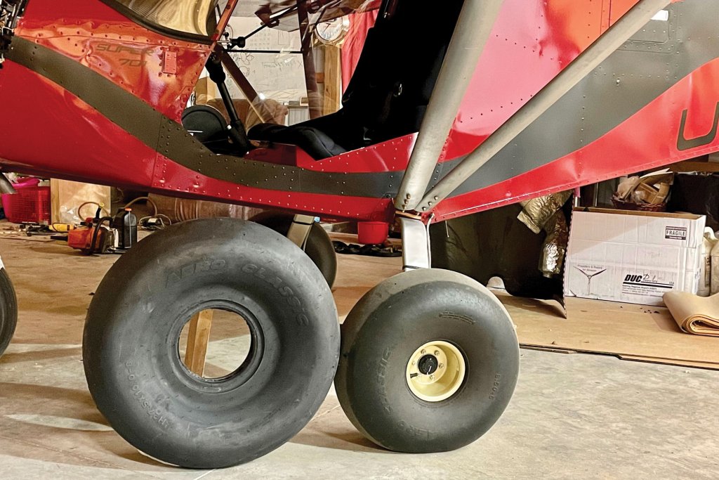

Zenith also dropped off a set of 27.5” Super Duty tundra tires that I was considering for use on the single-seater Super701/half. There is no doubt these beefier tires would look amazing on the 701 build, but they are substantially heavier, which goes completely against my super light weight theories and goals for the plane. I am still undecided on this one, but as of now, I am leaning toward sticking to 22” smooth tundra tires like I use on the original Super701 because they are much lighter and have always been plenty of tire for the various abuses I put the plane through. I believe the nose gear and tire is the limiting factor for extreme off-airport abuse anyway, which is why I have been pushing so hard to include a better shock/damping system for the front of these two builds.

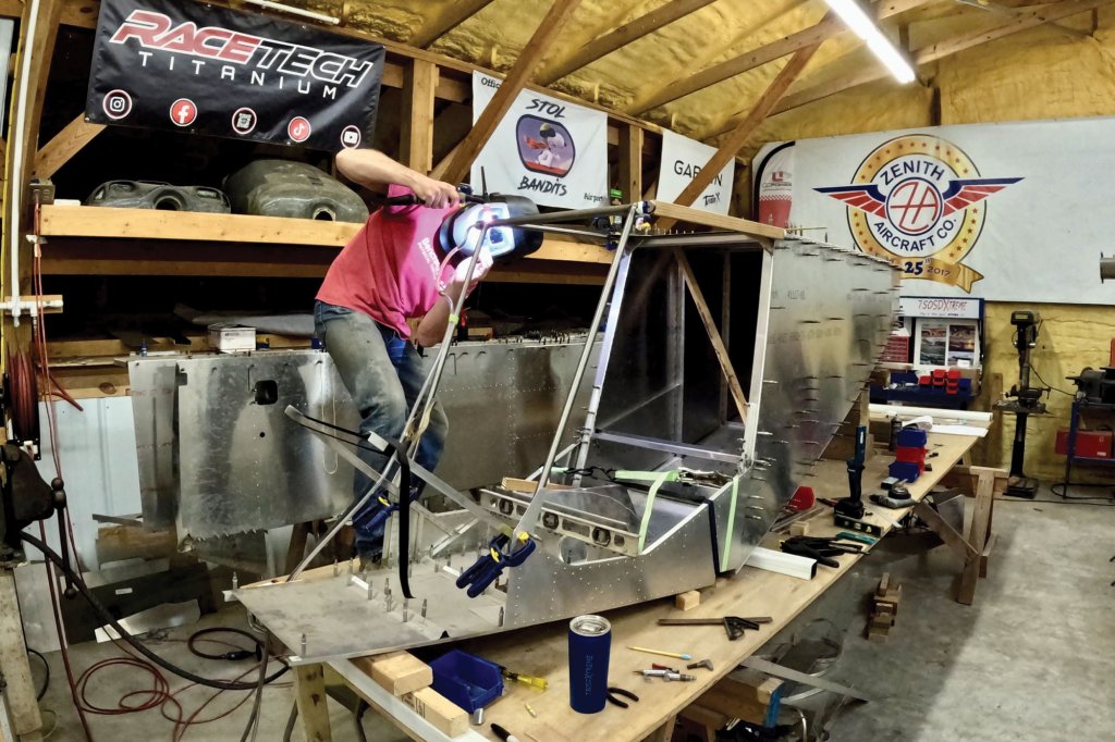

Since our last visit, I have worked on getting the first pieces of the titanium cabin frame cut, coped, mocked up, and Tig welded into place. These first titanium tubes were all meticulously fitted by hand to match the mocked-up fuselage. This is a process that needs to be done with precision and extreme attention to detail.
The first piece of this puzzle is the upper tube of the cabin frame, which also serves as the attachment points for the front spar of the wings. I went with a slightly thicker material for these pieces, which also had to be compensated for on the wing pickup templates’ dimensions. With a fair amount of time involved, these first five cabin frame tubes are now Tig welded together, clecoed to the fuselage, and are ready for the next pieces. Now comes a lot more planning, figuring, and mocking up ideas for a very custom engine mount, which will ultimately need to tie nicely into the firewall, front strut structure, and the cabin frame. In the meantime, you might catch me working on the custom front side skins for the fuselage.
