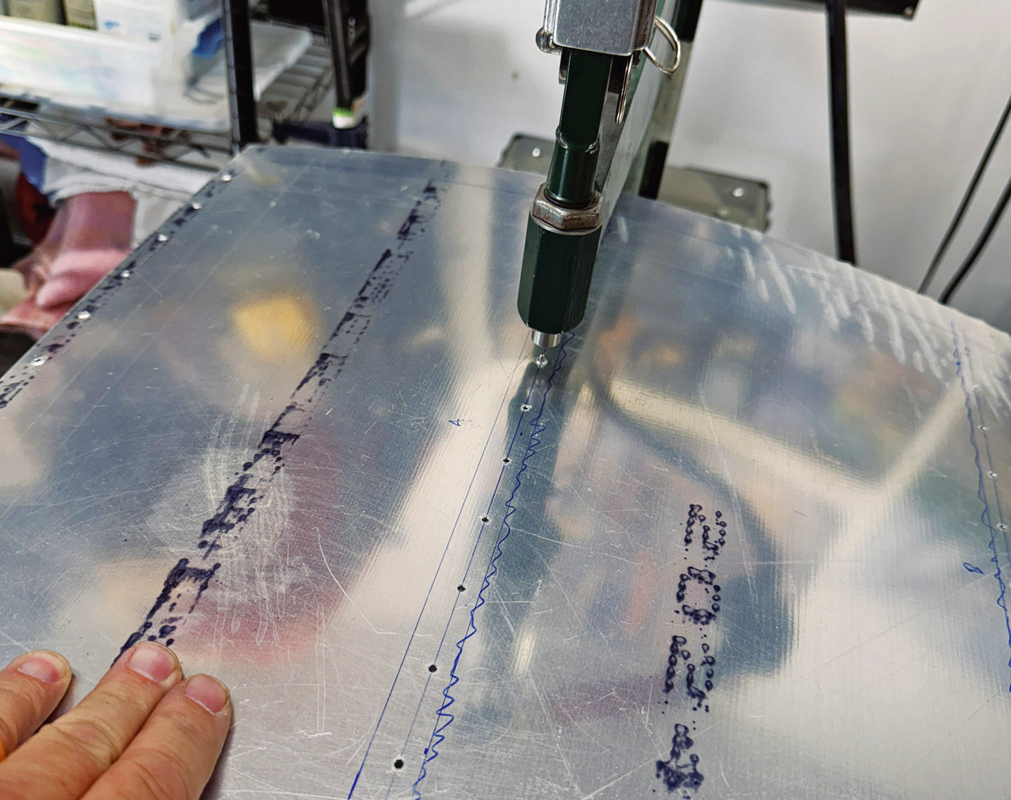

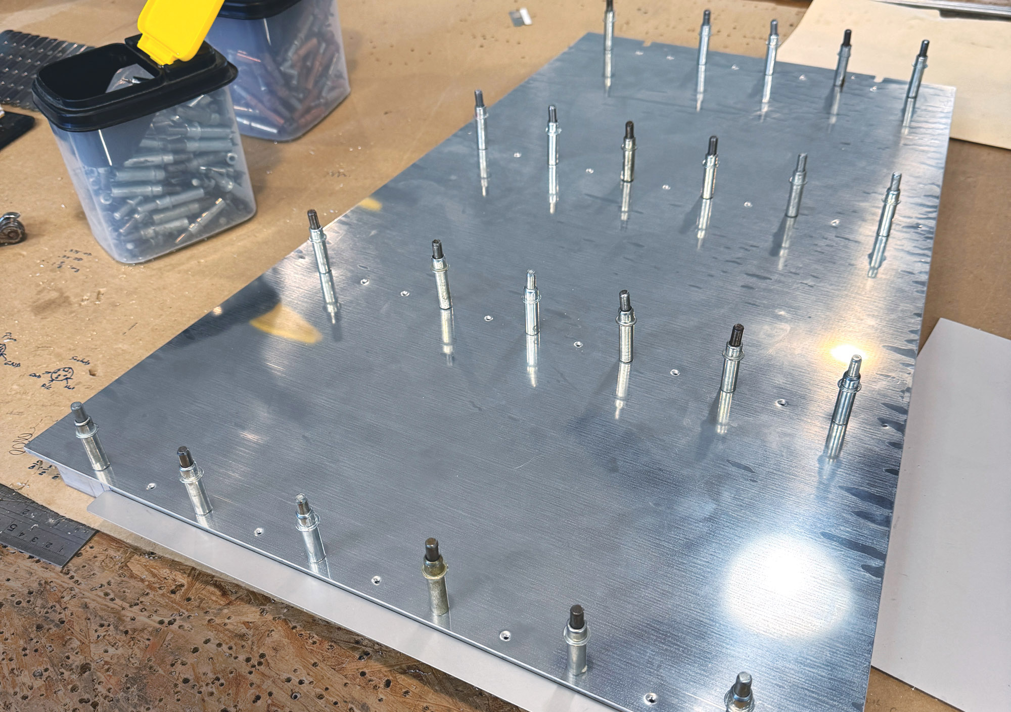

And the repetition doesn’t end with numerous similar parts. In a typical metal airplane you’re going to be drilling tens of thousands of holes, then deburring them, and then (if it’s a fast airplane) dimpling them. Then—and only then—do you get to start setting rivets. Endless quantities of rivets.

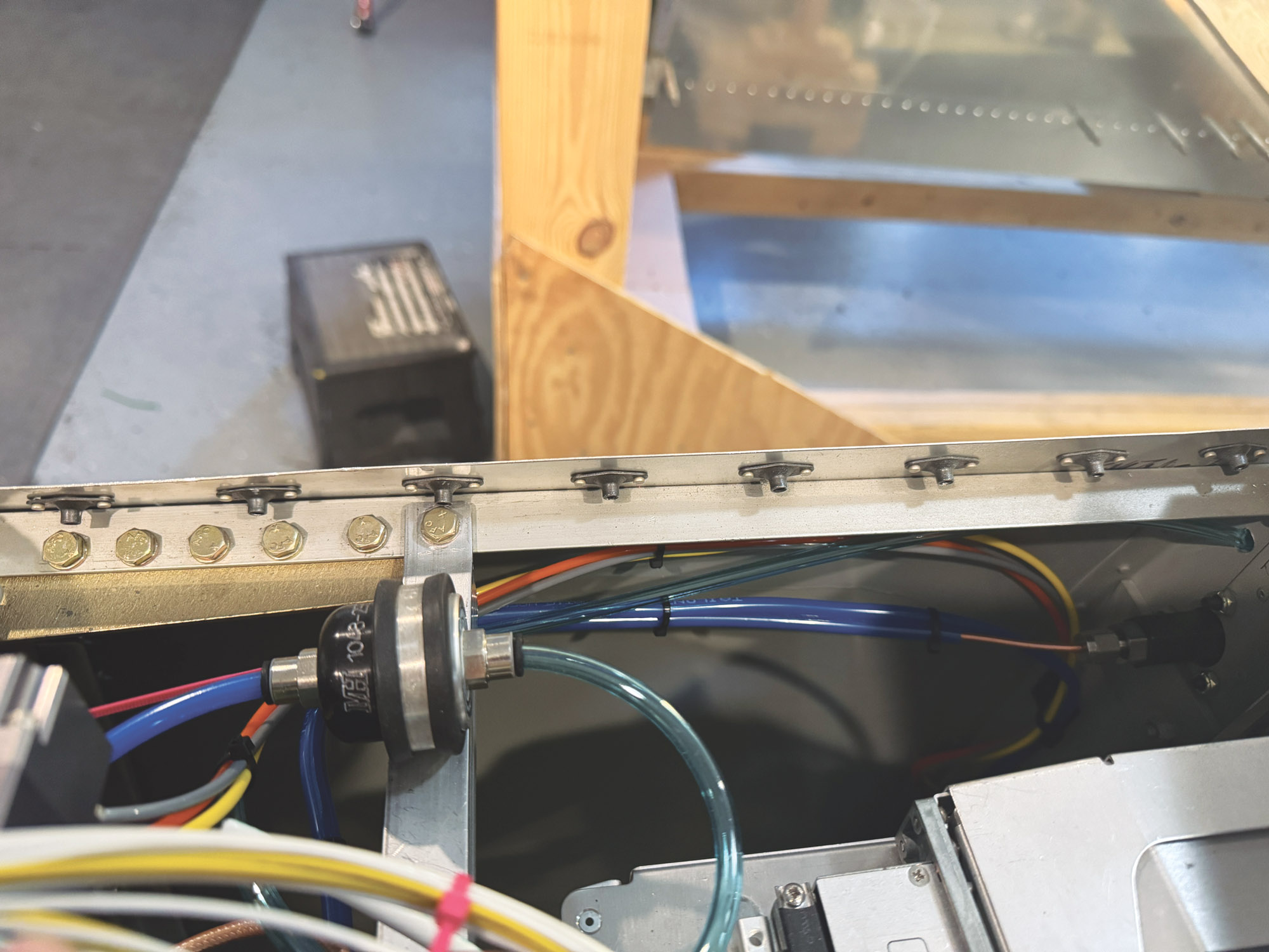

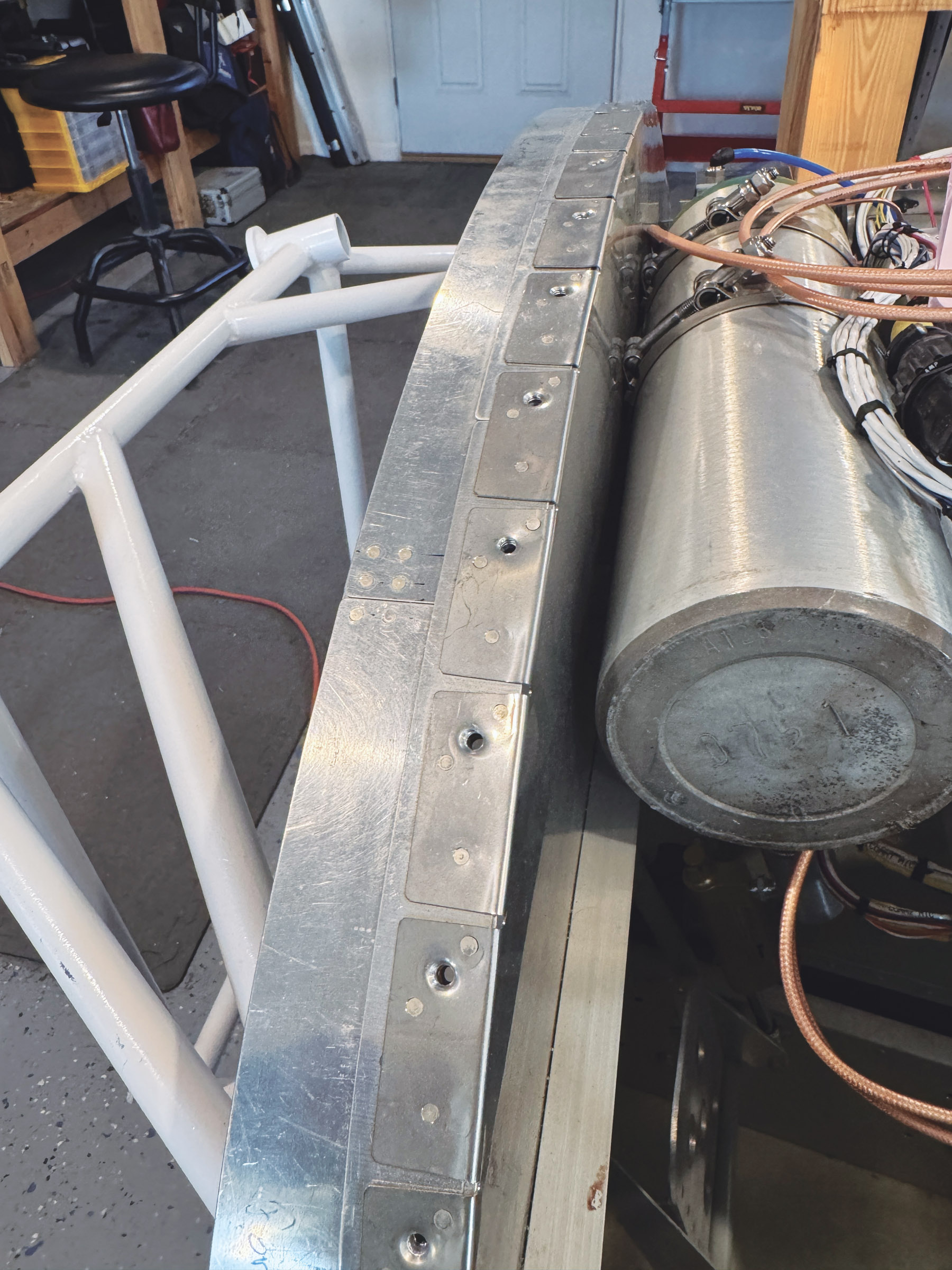

Once you have parts that look like airplane parts, you’re going to be adding all sorts of fasteners…and yes, Mr. Nut-Plate, I am talking about you! Nut plates are riveted on blind-mounted nuts that allow you to mount fixtures, components, or panels by simply screwing in a fastener and not having to hold a nut behind. Most airplanes have hundreds. A typical nut plate installation in a metal airplane involves drilling a pilot hole, then enlarging the hole to appropriate size for the nut plates you’re using. Then you use a nut plate jig to drill two “wing holes”—one on either side. Now debur all three holes. Grab a countersink tool of some kind and countersink the two wing holes so that you can use flush rivets.
Cleco one wing of the nut plates in place while lining up the other hole. Set up your rivet squeezer, insert the appropriately sized rivet in the empty wing hole, and squeeze it. Under-squeezed? It usually is because you have to sneak up on the right setting—adjust your squeezer and do it again until you have a Mil-Spec shop head. Remove the Cleco, insert another rivet, and do it again (except you already have the squeezer adjusted). Now repeat a few hundred times for all the other nut plates.
If I have good access, or am working on loose parts on the bench, I can do a nut plate in about a minute and a half—but I’ve been doing it for 50 years. The task is repetitive and sometimes painful as you contort your body to get into odd places or positions to reach the work site.

Oh…and nut plates? My design for the Rocket interior has me staring at 90 of them, all of the spots currently occupied with Clecos holding things in place. But I have a solution: I am going to cheat and use Click Bond nut plates. Drill a hole, clean the surface, spread some goo from a gun, and pop the nut plate into place—far simpler than all that riveting, and it just costs money. But in the big picture of the total project cost, no one will ever see it.
