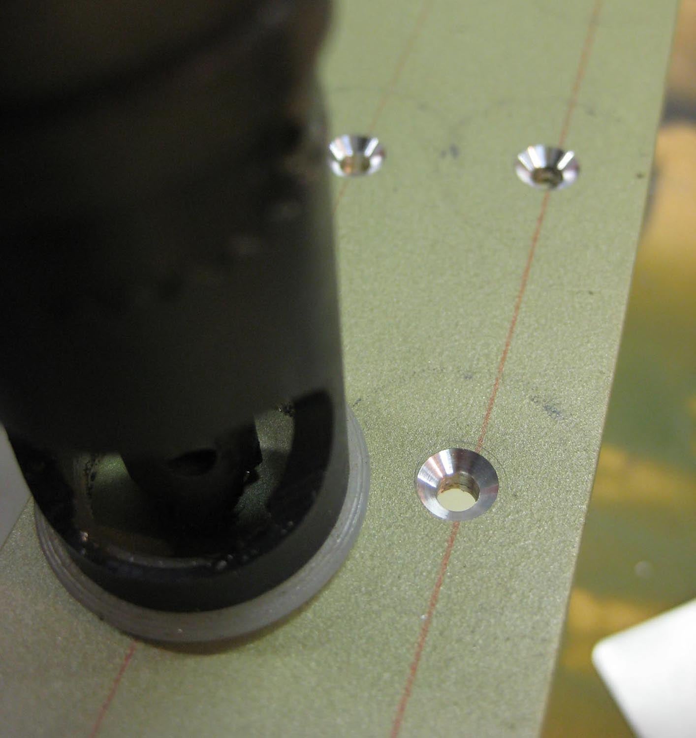

The cutting nose of a typical swivel deburring tool is actually a countersinking bit. We do not use this bit for countersinking as it is not precise enough for our needs, as you may have noticed when attempting to use it for such. If compared with the tips shown in the picture, you will notice that our deburring cutting tool does not have the pilot tip to keep the cutter precisely centered in the holes while cutting. A countersinking cutter must be matched in size to the hole size we need to countersink. But the principle is the same as the deburring tool: Cut too long or too deep and the rivet or screw will not have a proper fit. Therefore, we must install the countersinking cutter into a special cage that controls the depth of the cutting process.

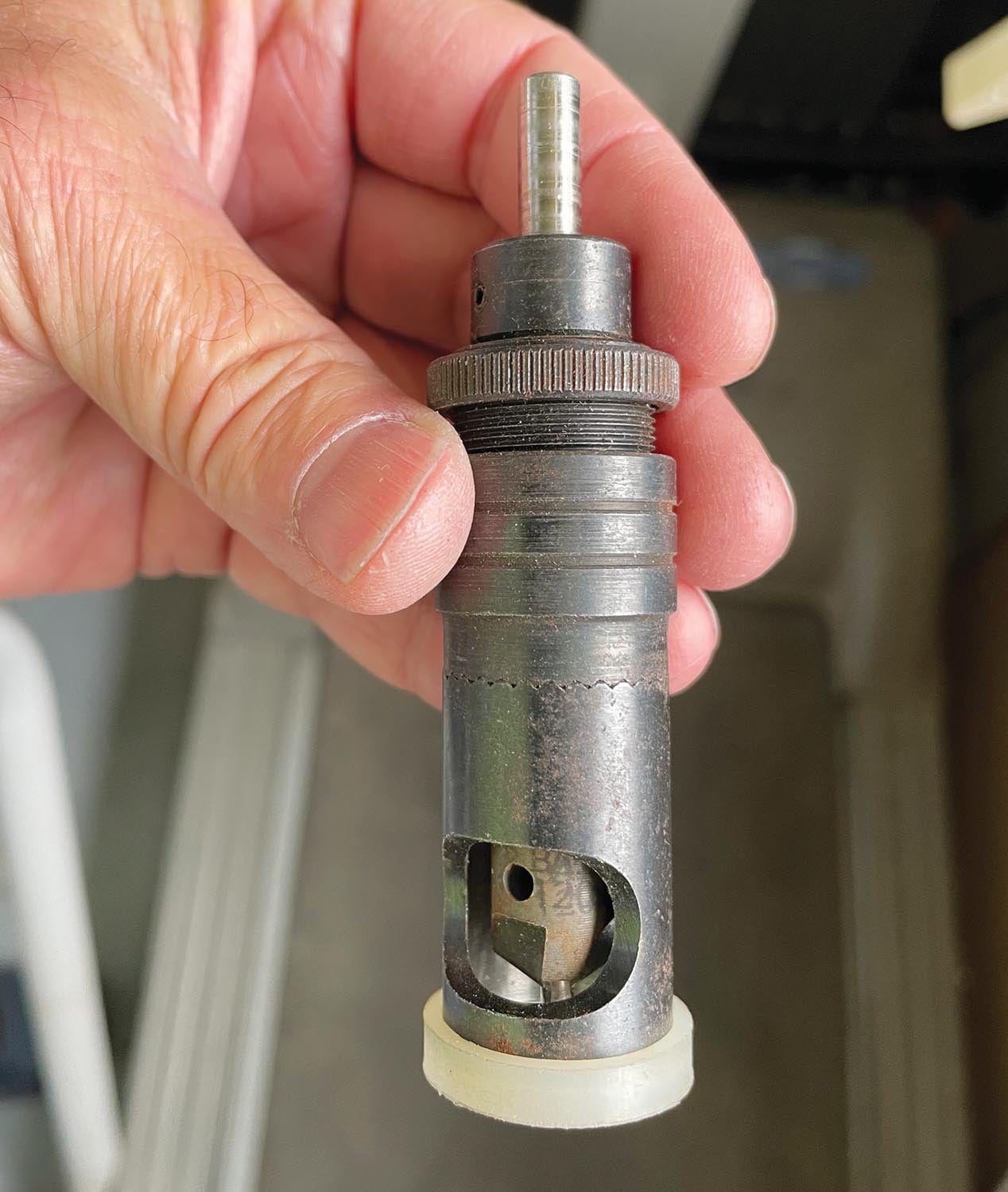

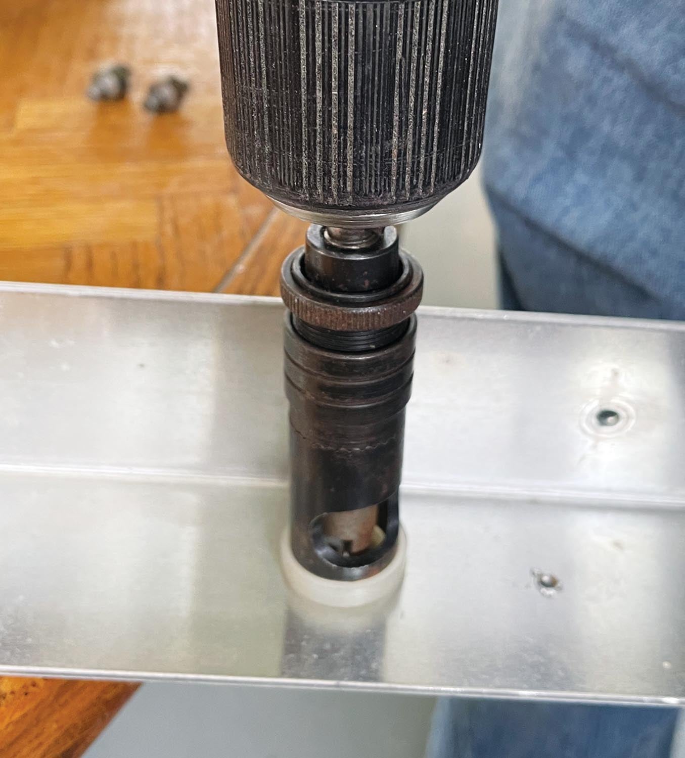

Looking at the cage in the picture, we can see that this device has a shaft at one end that fits into a hand drill. At the other end you can see the cutting bit (through the small opening) that gets screwed into the cage. What is hard to see is that the cage has a spring-loaded mechanism with an adjusting portion that determines how far the cutter can be pressed into the material. By rotating this adjustment on the cage, the cutter will countersink deeper or shallower for a perfect rivet/screw fit. You should experiment on scrap aluminum to make this adjustment. Once set, all subsequent countersinking operations will be consistent and precise.

In summary, utilizing flush-fit rivets and screws in your aircraft project requires a couple of special procedures and tools. Dimpling, countersinking and their associated tools will allow your components to accept flush rivets and screws. The most challenging skill (but not difficult by any means!) is learning to countersink properly. Notice the picture of my results while practicing countersinking, and you can see what happens as you adjust the cage for the best fit. Since each rivet/screw hole size requires a matched cutter, it is common to consider having a separate cage for each cutter bit—so that you do not have to remove and disturb the adjustment setting when changing cutting bits.
