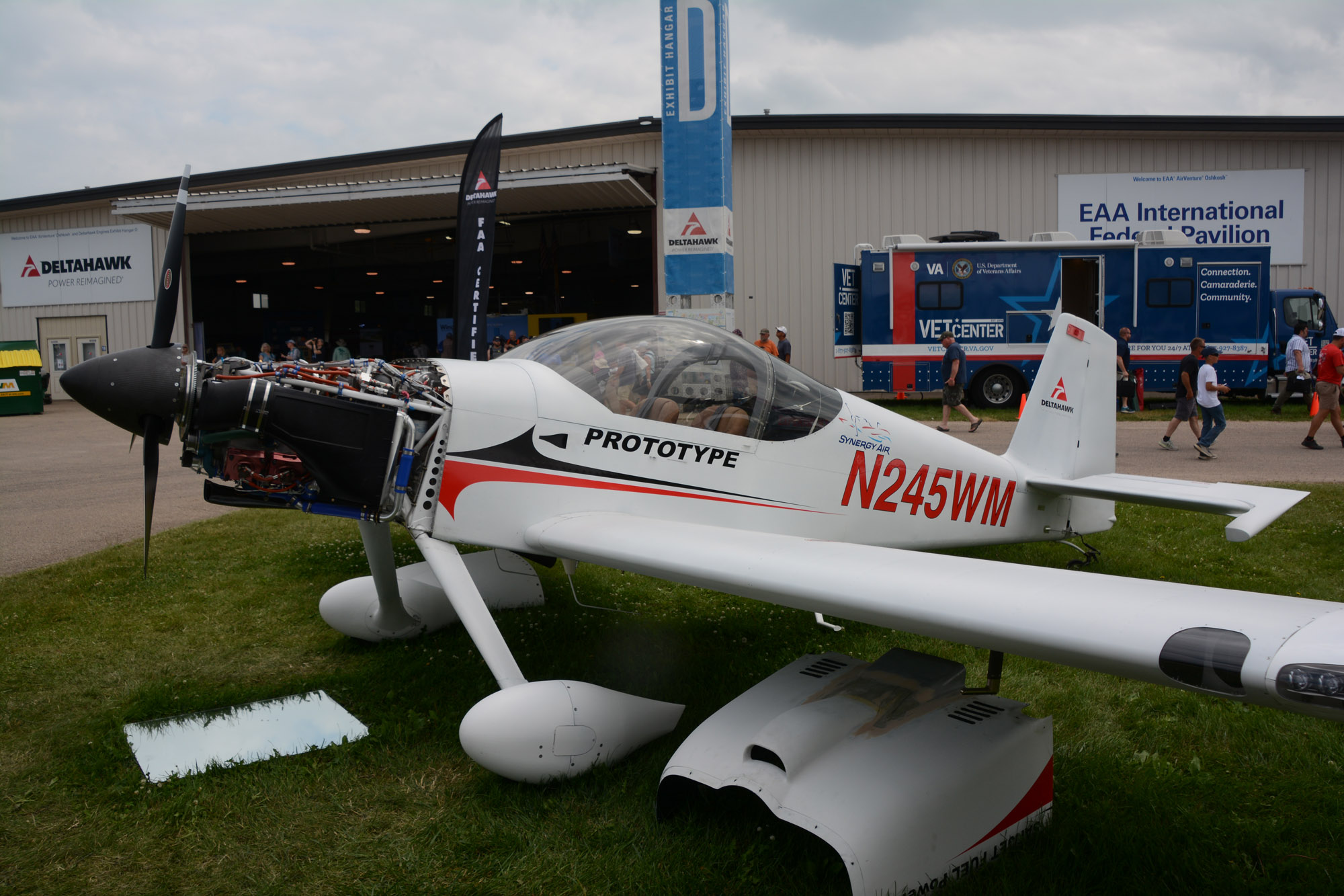

Craig Saxton’s DH-180 powered RV-14 is essentially stock from the firewall aft. A lightly modified James cowling and 6.00-6 tires are the most notable airframe changes.
Spectating the Deltahawk saga has become quite the sport over the decades but regular fans are increasingly convinced we’re close to an overnight sensation.
Best evidence is Deltahawk development builder Craig Saxton’s RV-14. Well, Craig’s RV-14 with the DH-180 Deltahawk engine in it. He has two RV-14’s flying (and third one building…) so the affable Craig can authoritatively speak to how the Deltahawk compares with industry standards. And those comparisons are definitely interesting.
To get right to the point Craig’s Delthawk powered RV-14 offers significant increases in range and fuel economy while maintaining all the speed and pleasant handling RV-14 owners expect. To wit, Craig reports a representative set of cross country numbers. At 11,500 ft cruising at 2390 rpm and 59.2 In Hg of manifold pressure fuel consumption was 7 gph and true airspeed 167 knots/192 mph. That calculates to 27.5 mpg.

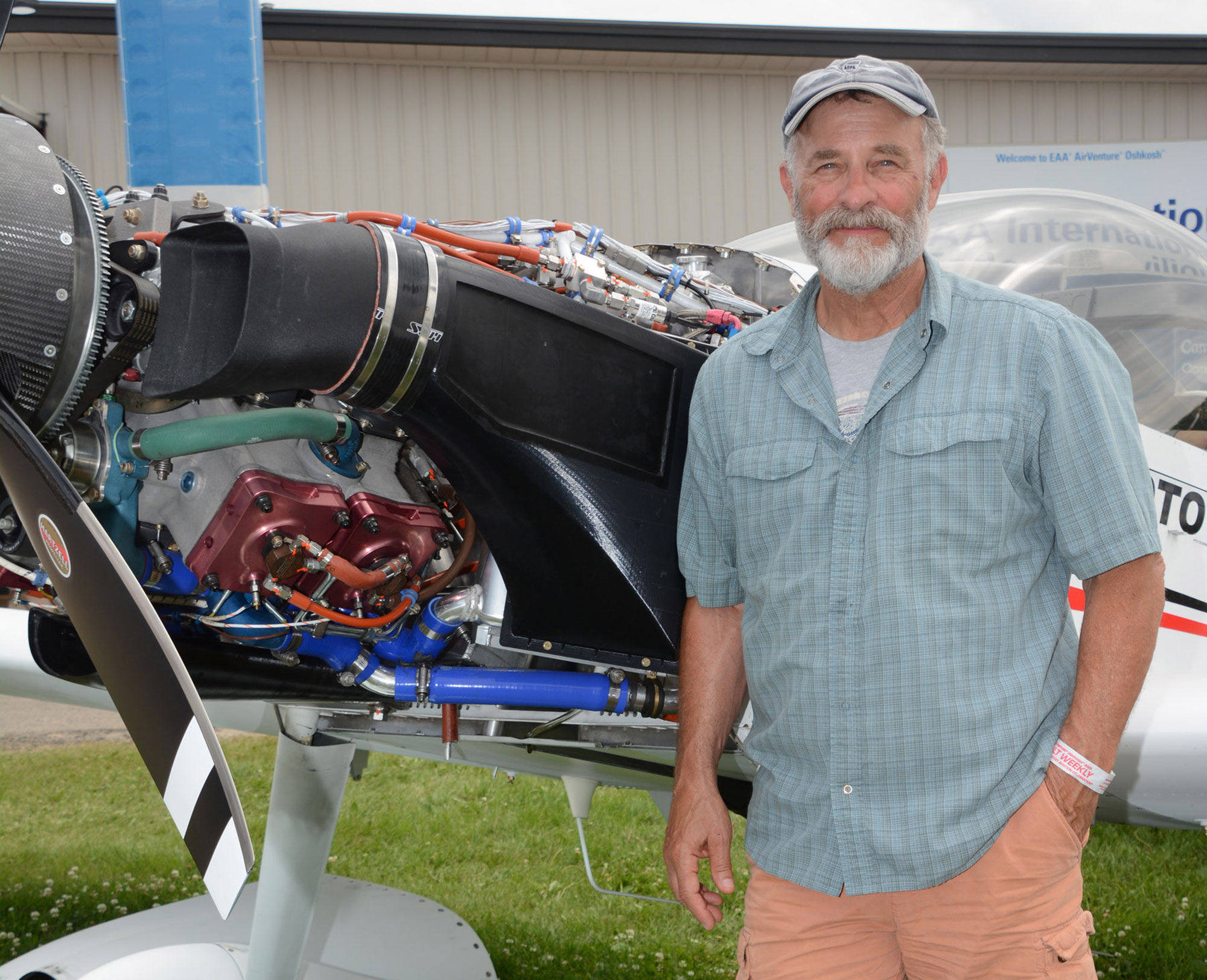

Craig Saxton and friend.
Craig says typically the DH-180 consumes 6.8 to 7 gph of less expensive Jet-A. He also speculates his Oregon to AirVenture jaunt could be done non-stop as something of a stunt, but quickly says a single fuel stop is the only reasonable tactic.
As for aircraft handling Craig says he can’t feel a difference between his Jet-A and gas RV-14s. His DH-180 engine does not have the most recent cylinder block (still being finalized) which offers a 15 lb weight savings, and the Deltahawk engine as installed is slightly heavier than his Lycoming fitment, the result being a small weight in the tail of the Jet-A airplane. That weight will be deleted in his third RV-14 because it will have the lighter block and detailed improvements to the oil cooler and other accessories bringing the Deltahawk installation to par with the Lycoming 390 weight.

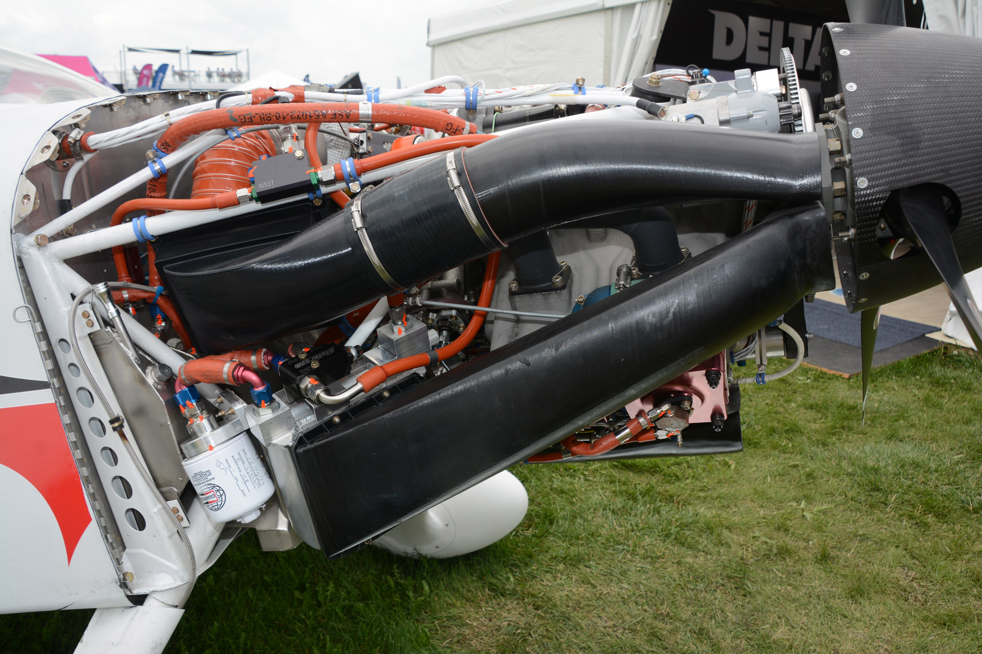

Deltahawk will sell engines as complete firewall forward packages. By complete they mean the engine bolted to its mount with all plumbing and ducting installed—about as plug and play as an engine can get.
deltahawk20250722 0003 scaled
Best view of an installed Deltahawk engine is invariably from the bottom up. The supercharger and cylinder heads show well here.

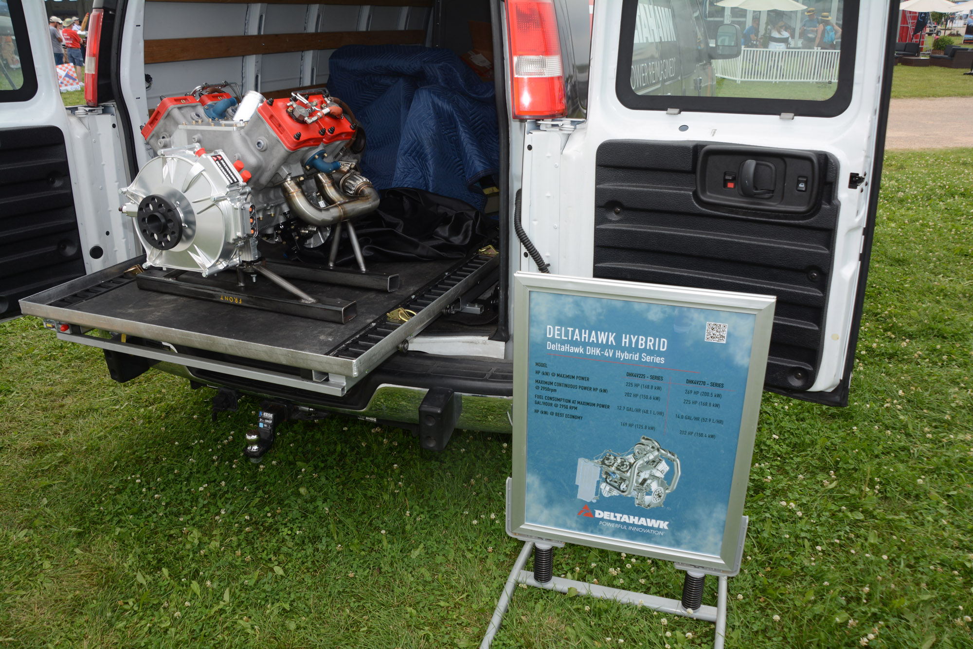

Quietly on display is the DHK-4V Hybrid application where a Deltahawk engine mates to a generator. An electric motor drives the propeller in this battery-less application.
