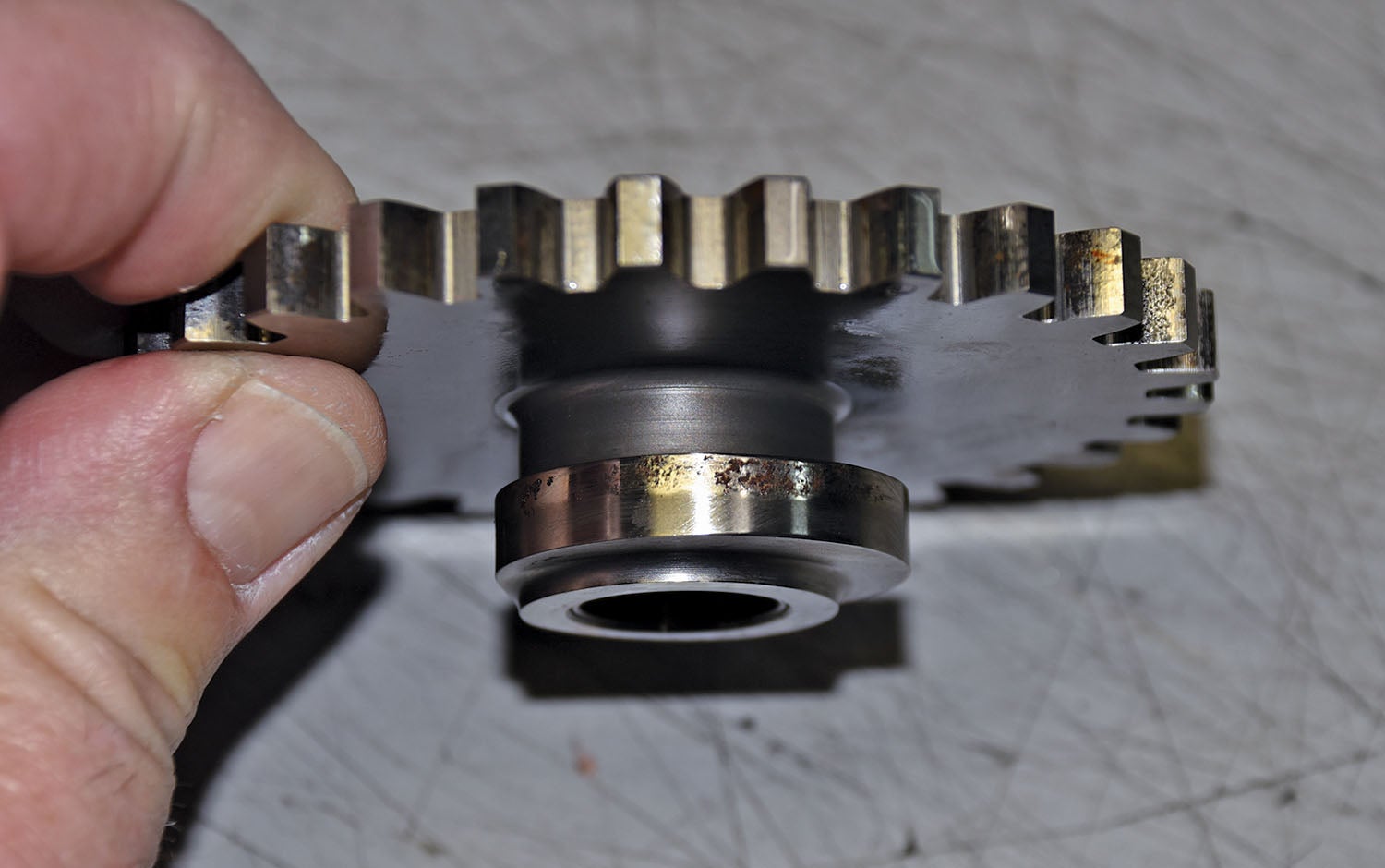

The valve covers, rocker arms and pushrods were removed. The pushrods were heavily corroded, so out they went. This is a rare cost to bear on a normal overhaul. As the case came apart, there was corrosion on the drive gear to the fuel pump, too. These accessory drive gears are rarely replaced, but this one showed clear signs of pitting. These little gears are expensive, or at least they seem so for such a small part. The crank and rods looked good, so they were set aside for Magnaflux inspection.

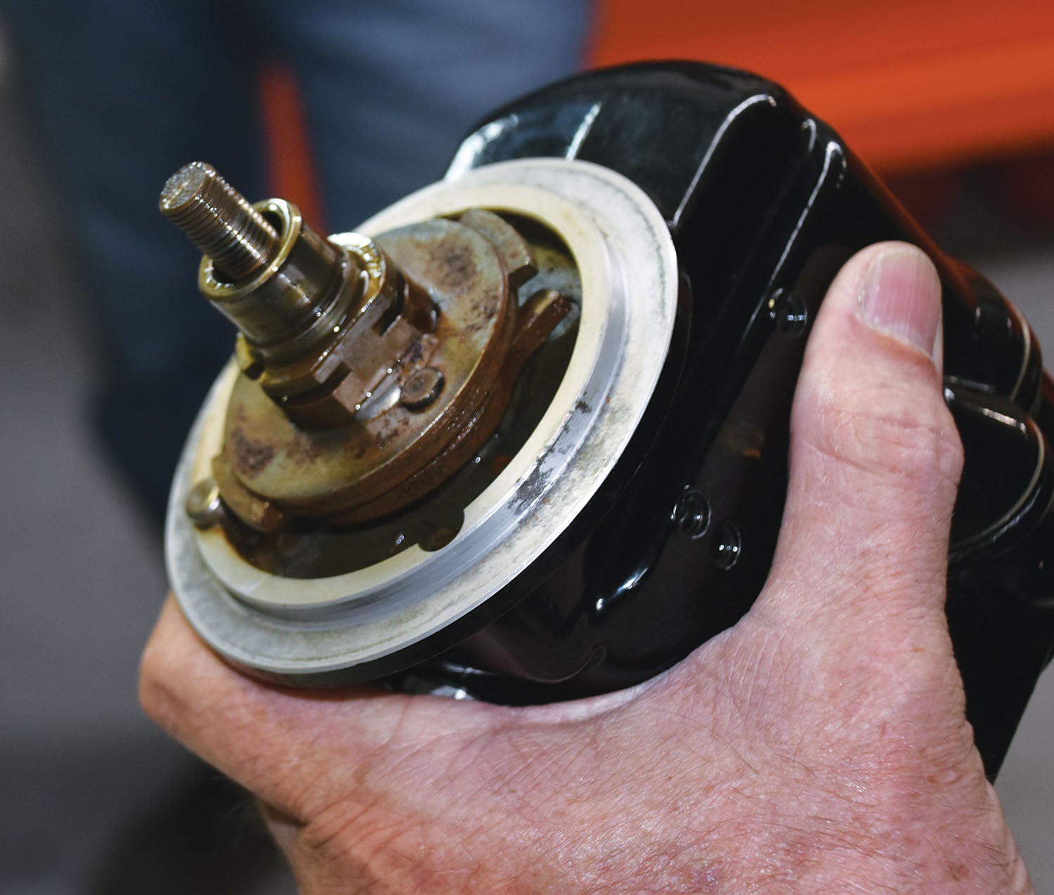

A big surprise was the amount of corrosion on the impulse couplers on both magnetos. Yes, this Superior engine had two magnetos with impulse couplers instead of the more typical one with and one without. Both mags went over to Aero Accessories for 500-hour IRAN inspection and cleanup. So much for saving money by not overhauling all of the accessories.

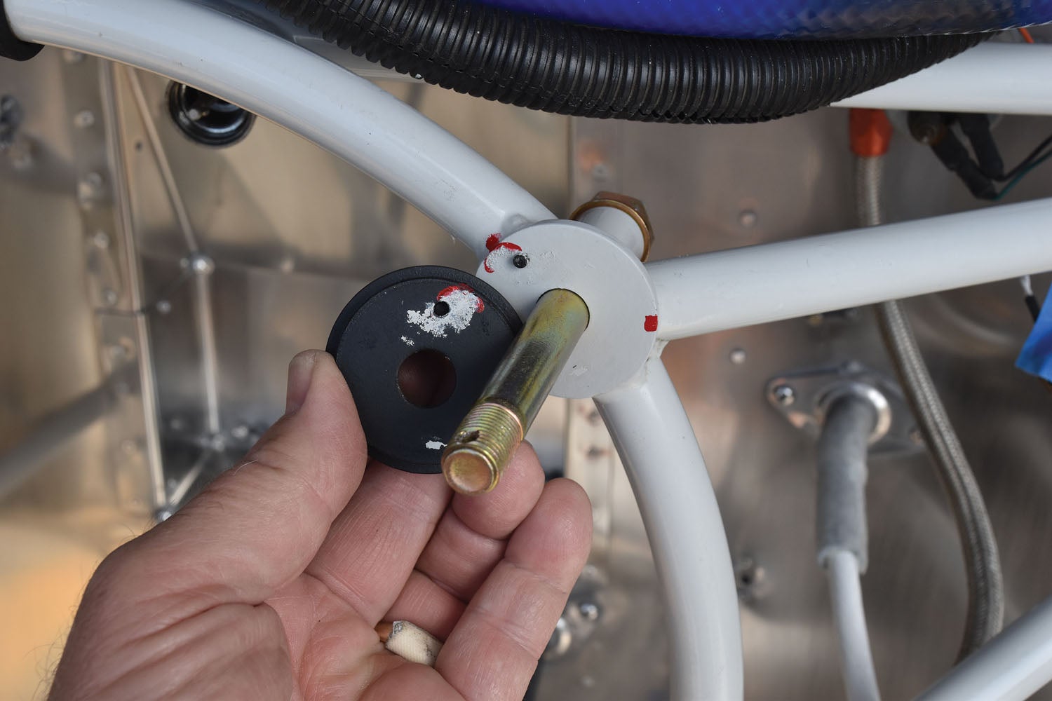

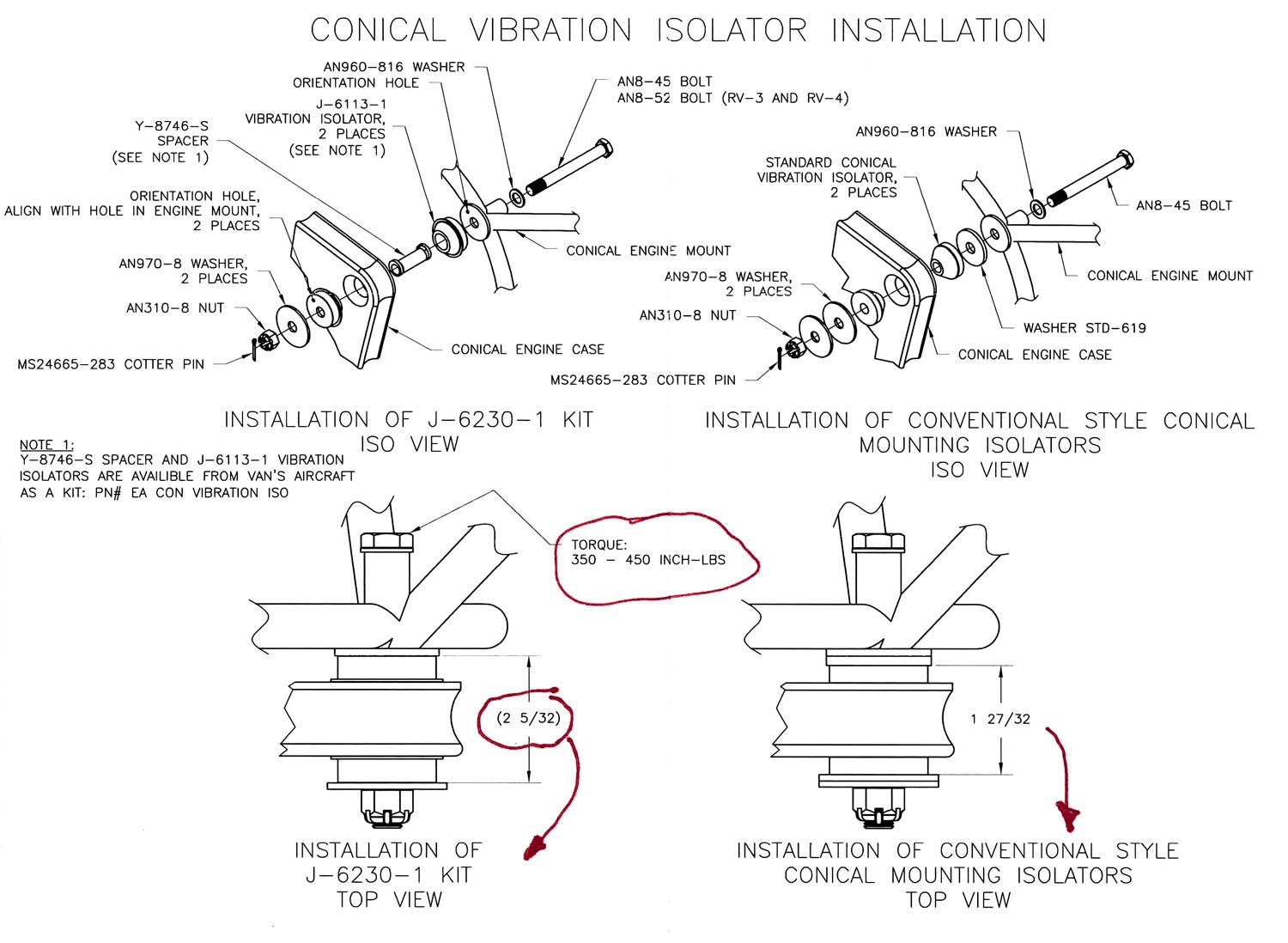

With all of the preparation out of the way, it was time to hang the newly refurbished engine back on the airplane. This required removing the left magneto due to clearance issues, but was otherwise straightforward. One difference seen with this plane was the use of conical engine mounts. We rarely see conical mounts except on old engines, but the original builder ordered the engine that way from Superior. The advantage of the conical mount system is that it limits engine movement, something that can be important in a closely cowled engine. This is not normally seen as an important issue with the RV-6A, but that was the builder’s preference. The downside to conical mounts is their tendency to transmit more vibration to the airframe.
The conical mount vibration issue was at least partly addressed by using some sophisticated (expensive) engine-mount bushings. These mounts require a specific orientation that is maintained by some roll pins installed into the engine mount and lock into the back side of the bushings.
