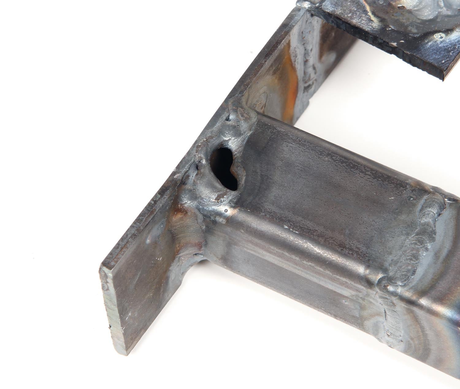

When to braze instead of weld depends on the job. For me, TIG welding thin sheet metal has always been problematic. Actually it’s not problematic—it’s impossible. I’m fine with steel 0.060 inch (16 gauge) or more thickness. Depending on the joint design, I can sometimes weld material as thin as 0.048 (18 gauge). An overlapping joint is usually OK. But a butt joint, forget it. I usually end up, eventually, if not immediately, burning through, which ruins both the weld and the part. The issue is, of course, one of practice and experience. I simply don’t weld enough on thin material to gain the necessary proficiency.
So when David demonstrated how easy it was to run a bead and get a clean “weld” on super-thin 0.028-inch (22 gauge) steel, I knew that TIG brazing had my name all over it.
