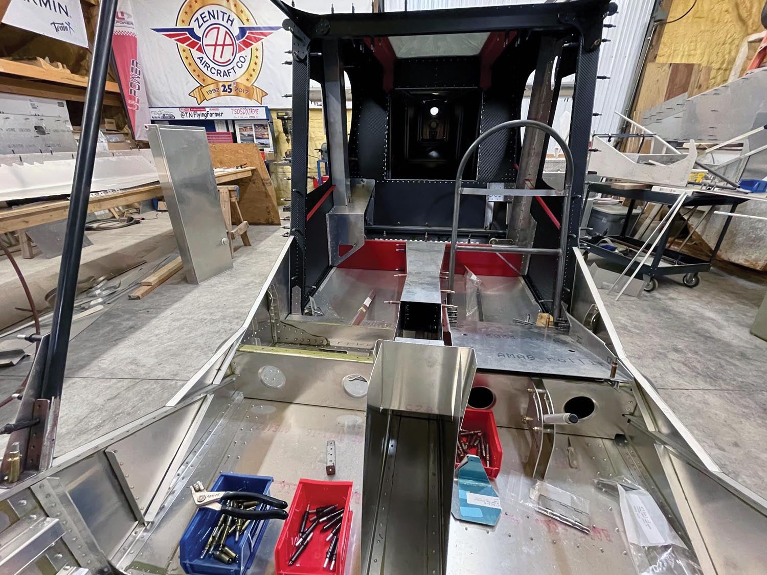

Rear fuselage access panel. I decided to move the horizontal access panel from underneath the airplane to inside the cabin on the vertical rear seatback. This modification took quite a bit of structural strengthening of the rear seatback/bulkhead. It is complete except for the final touch-ups and was discussed and shown in the second installment in this series (back in the September 2022 issue). I do not have a great reason for doing this modification except for cleaning up the bottom of the fuselage. Honestly, I may regret this one once I start doing maintenance in the rear fuselage with 100-hour inspections because it will be much more difficult to get in the back of the plane compared to the simple bottom panel. You will see more pictures of it as I get closer to completion with the fuselage and rigging.
Manual flap control. The CH 750 Super Duty kits come with electrically operated flaps. I decided before even ordering the 750 SD kit that I wanted to build it with a manual flap control handle that matched the feel of my Super701. This modification also required quite a bit of engineering and work to bring the linkages across and through the center tunnel in the fuselage. It is complete except for making the pushrod that goes from the handle to the bellcrank underneath the pilot’s seat. I will wait until the wings are installed and final rigging is underway to complete this because I will need to double-check all the flaperon travel limits closely. A description and pictures of this manual flaperon control system appeared in Part 2 of this series (September ’22 issue).
Lightweight adjustable seat attachment system. I ordered the optional adjustable seat sliders but decided to create my own variation for adjustable seating because of the extra weight of the available sliders and the mission I have in mind for removing seats and/or replacing the passenger seat with a custom hold-down system for specific gear. This modification is discussed with more detail in Part 7 of this series (in the September ’23 issue).
Engine mount. While there is now an engine mount commercially available for the Zenith 750 SD/ULPower 520T engine combination, there is not yet an airplane flying with this engine. If you’ve been following this series, you know that my biggest modification and challenge so far has been the time-consuming custom engine mount, which was discussed in detail in Part 7 and Part 8 of this series (September ’23 and December ’23 issues).
The engine’s exhaust system will also have to be modified slightly to work with the very short engine mount because of how close the engine is to the firewall with my scratch-built engine mount. I have also been researching intercoolers with hopes of finding a good solution for placement and function with this ULPower 520 Turbo and the 750SDX combination.
Engine cowling. The next biggest customization will be the engine cowl. It will obviously have to be a completely custom (and probably a one-off) because of the unique positioning of the various engine components like the air intake, intercooler, ducting, etc. There is still a fair amount of work with the engine installation before the cowling work is ready to begin, but it’s generally on my mind as I walk around the project. Yet another reason to build your airplane “stock.”
