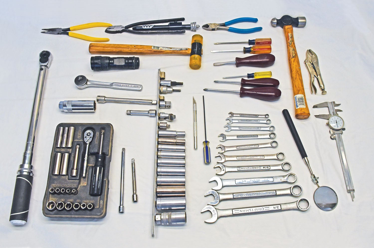

General Tools
Everyone needs a pair of safety wire pliers, a torque wrench and an assortment of general mechanic’s tools such as sockets, wrenches, pliers and the like. If you built your plane, you already have most if not all of these essential tools. If you didn’t build your plane, you might have to invest in some.
A good selection of general tools might include these items: 1/4-inch-drive socket set, 3/8-inch-drive socket set, combination wrench set through 3/4 inch (all of these in fractions of an inch dimensions), an aviation spark plug socket, select metric combination wrenches (10mm, 12mm, etc.), an assortment of extensions for socket sets, a plastic hammer and a ball-peen hammer, a small flashlight and inspection mirror, an X-Acto knife, a magnet with an extendable handle, a pair of precision calipers, a 3/32-inch Allen wrench for removing radios and an assortment of pliers and screwdrivers. You may need others that meet the specific needs of your airplane.
When it comes to tools, it pays to get good ones but not go crazy. Most of my tools are Craftsman, and they have served me well for a very long time. This is not to disparage the premium brands such as Snap-on or Matco, but they get pretty pricey and don’t necessarily provide greater value. Harbor Freight has tools at the other end of the price spectrum, many of which represent great value, but you need to use some discretion about what you buy there. The consensus is that occasional-use or odd-sized tools from Harbor Freight are fine, but your everyday tools are worth an extra investment.

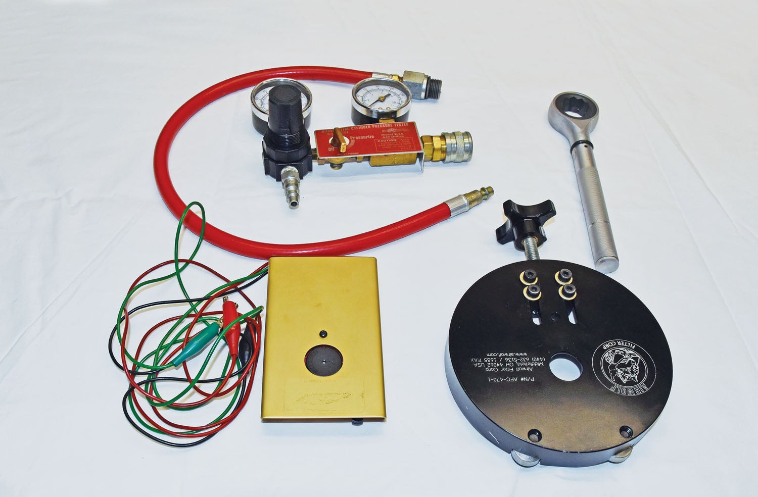

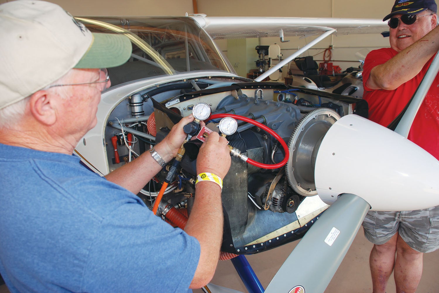

When we start talking about engine maintenance, we get to the need for special airplane tools. Here are the primary tools you will need, assuming you are not talking about taking the engine apart. The basic differential compression tester that will work on Lycoming or Rotax engines costs $106 from Aircraft Spruce. It includes an 18mm insert and a 12mm insert. If you are using automotive spark plugs, common with E-MAG and Light Speed ignition systems, you will need to get a 14mm insert that you can pick up at any auto parts store. You should perform a differential compression test yearly or whenever you suspect cylinder or valve problems. Of course, you will also need an air compressor to provide the compressed air needed to make the tester work.
You will also need a wrench to remove your oil filter. You can just use a 1-inch combination wrench that you pick up at Harbor Freight, or you can get a special oil filter torque wrench for $82. I suggest saving your money and going with the combination wrench.
While we are on the subject of oil changes, you will want to get or borrow an oil filter cutter so you can cut your filter open and inspect it for metal particles at each oil change. The best one is by Airwolf, and it costs $135. As a mechanic friend once told me, buy the best and cry only once. You are going to need this tool at least twice a year, so just do it.
Another once-a-year tool is the magneto synchronizer or buzz box. It is needed to check or set the timing of your magnetos. I have the least expensive one Aircraft Spruce sells at a bit under $70. It has worked well for many years. If you have electronic ignition, you will need to consult with that vendor for tool recommendations.

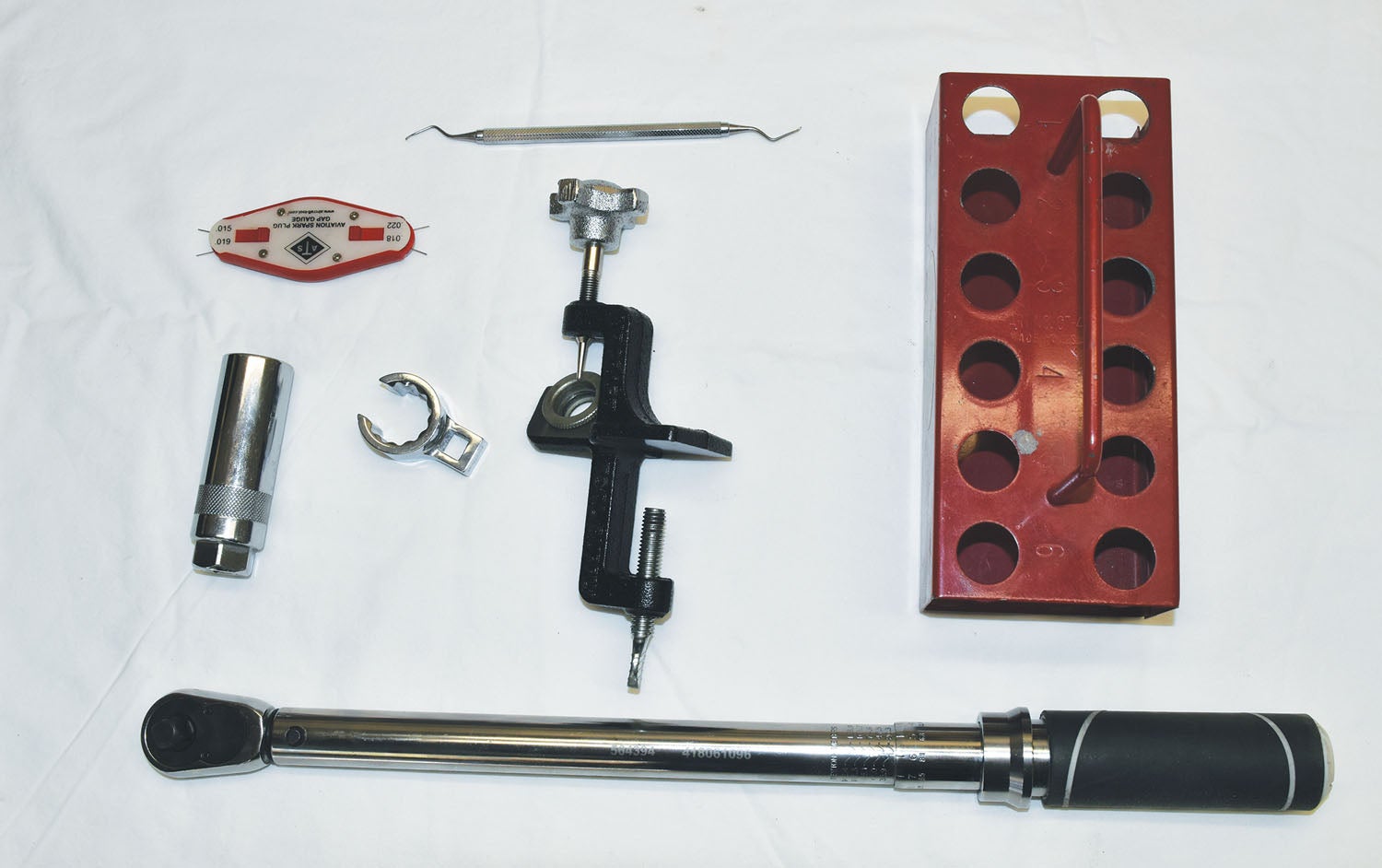

Again, for engines using magnetos and aviation spark plugs, you will need a few special spark plug tools. A spark plug gapping tool and gap gauge are required, and a dental pick to get lead balls out of spark plugs is highly recommended, as is a spark plug caddy. You already have a torque wrench, but you will need to add an aviation spark plug socket. With many RV-style baffle systems, it is also convenient to have a 7/8-inch crow’s foot to remove and tighten the rear plugs that can be hard to reach with the baffles in place. Anti-seize is also a good idea to prevent spark plugs from sticking in their threads.

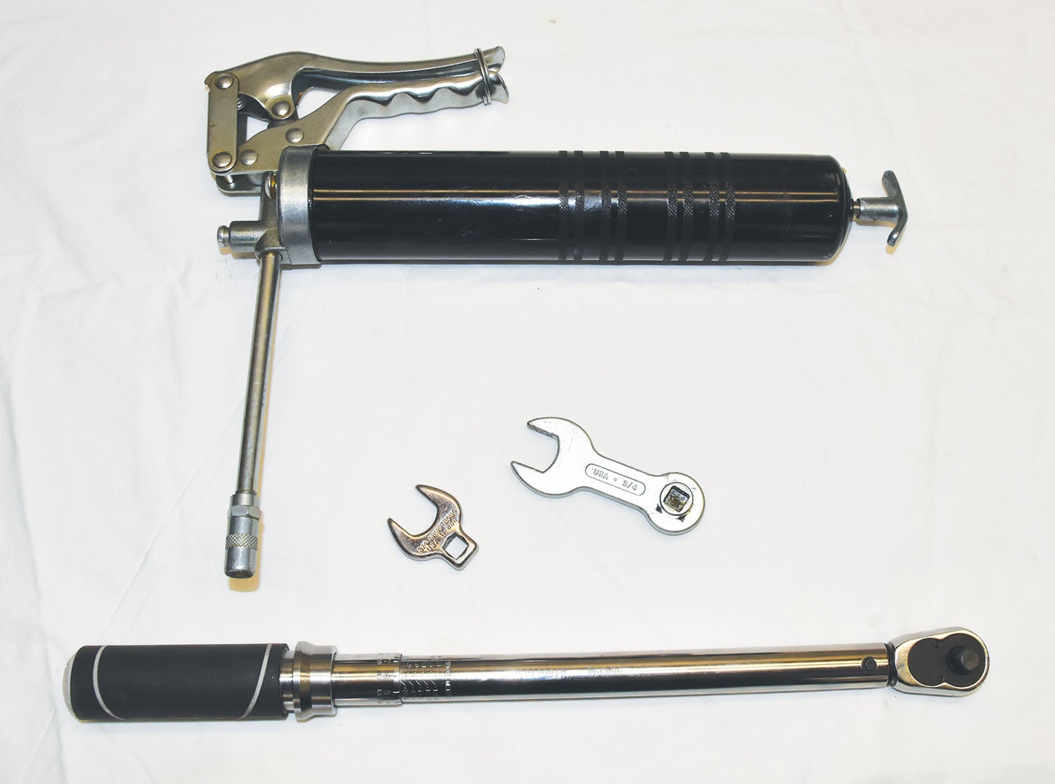

If you have a fixed-pitch prop, you only need a torque wrench to tighten the prop bolts and safety wire pliers to secure the bolts. If you have a wood prop, you will need these twice a year to make sure your prop bolts are tight. If you have a constant-speed propeller, you will need a Hartzell prop tool or some other crow’s foot attachment to access the bolts. If you do not have a reason to remove the prop, you don’t need the tool. Just wait to buy it until the need arises. With a constant-speed prop, you will also need a grease gun to lube the prop hub at the time of your condition inspection. Be sure to load it with an approved grease for your prop.

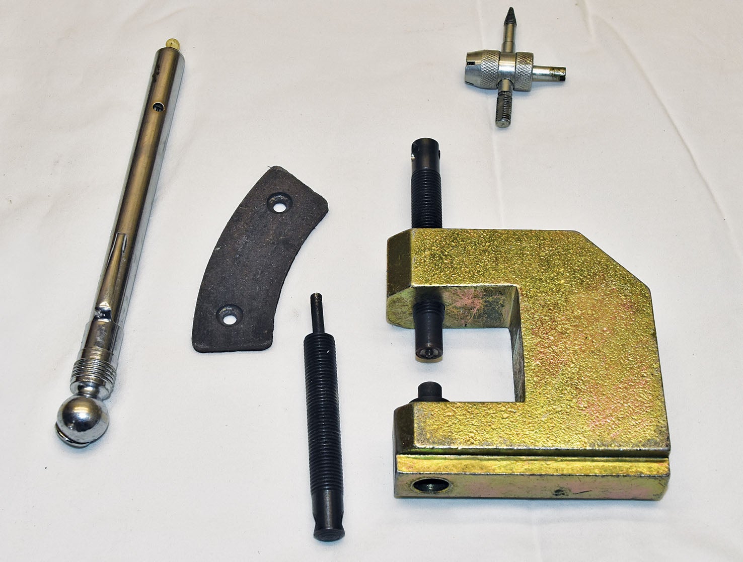

To replace worn brake pads, you will need a drill and a brake rivet tool. There is no need to buy these things until you need them, but when you do, you need to either buy or borrow the right tools. The rivet tool is less than $30 to buy, so it doesn’t inflict much financial pain. On the other hand, you will only need it every few years, so it is nice to share one among your airport buddies.

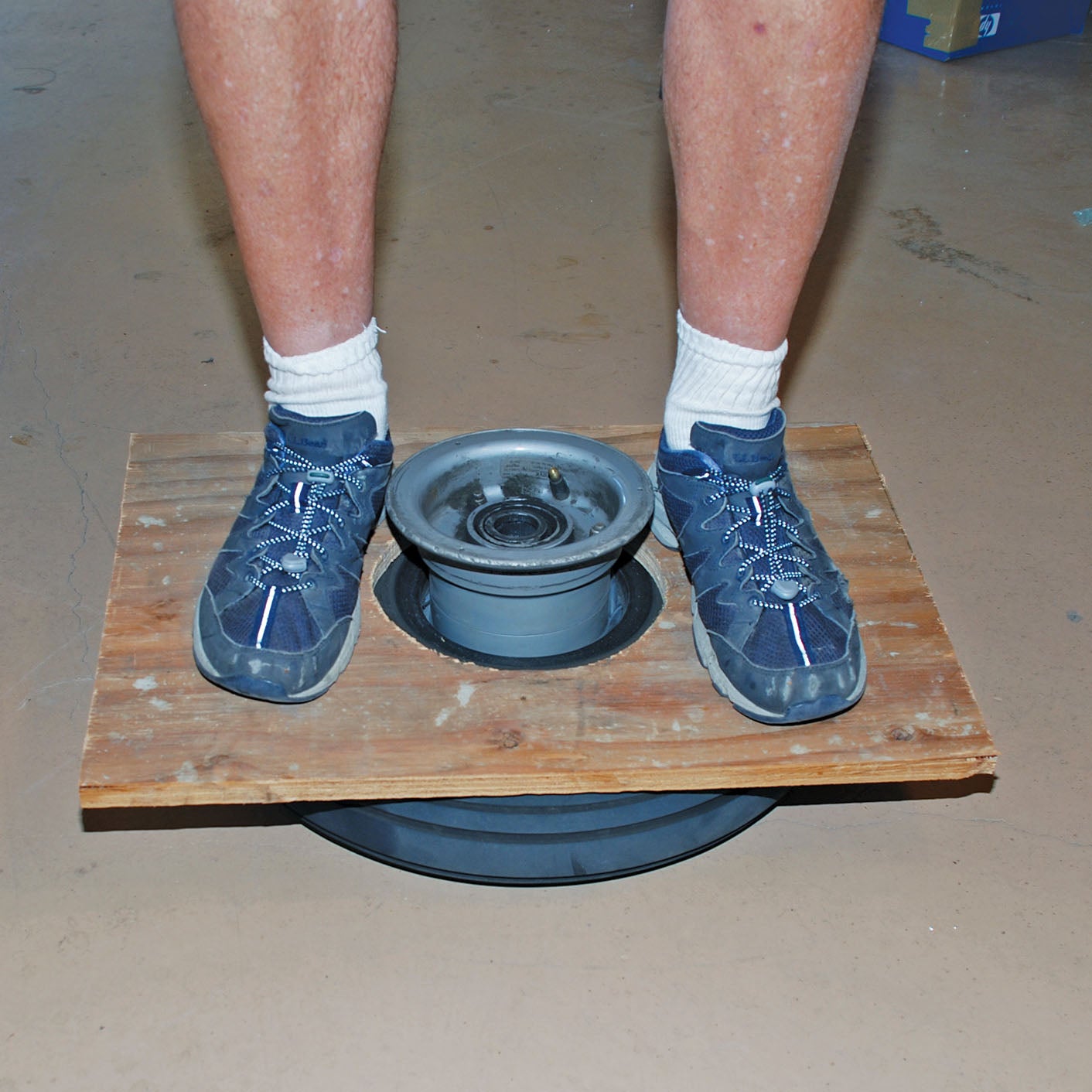

To change a tire, you will need a tool to remove the valve stem, an air pressure gauge made for tires and a bead breaker to free the tire from the wheel. I bought a bead breaker for about $150 several years ago, but I never use it. I recommend making one from a piece of plywood about two feet square with a hole cut in the middle to clear the wheel’s diameter. Place the plywood on the tire and step on it to break the tire loose. It works like a charm.

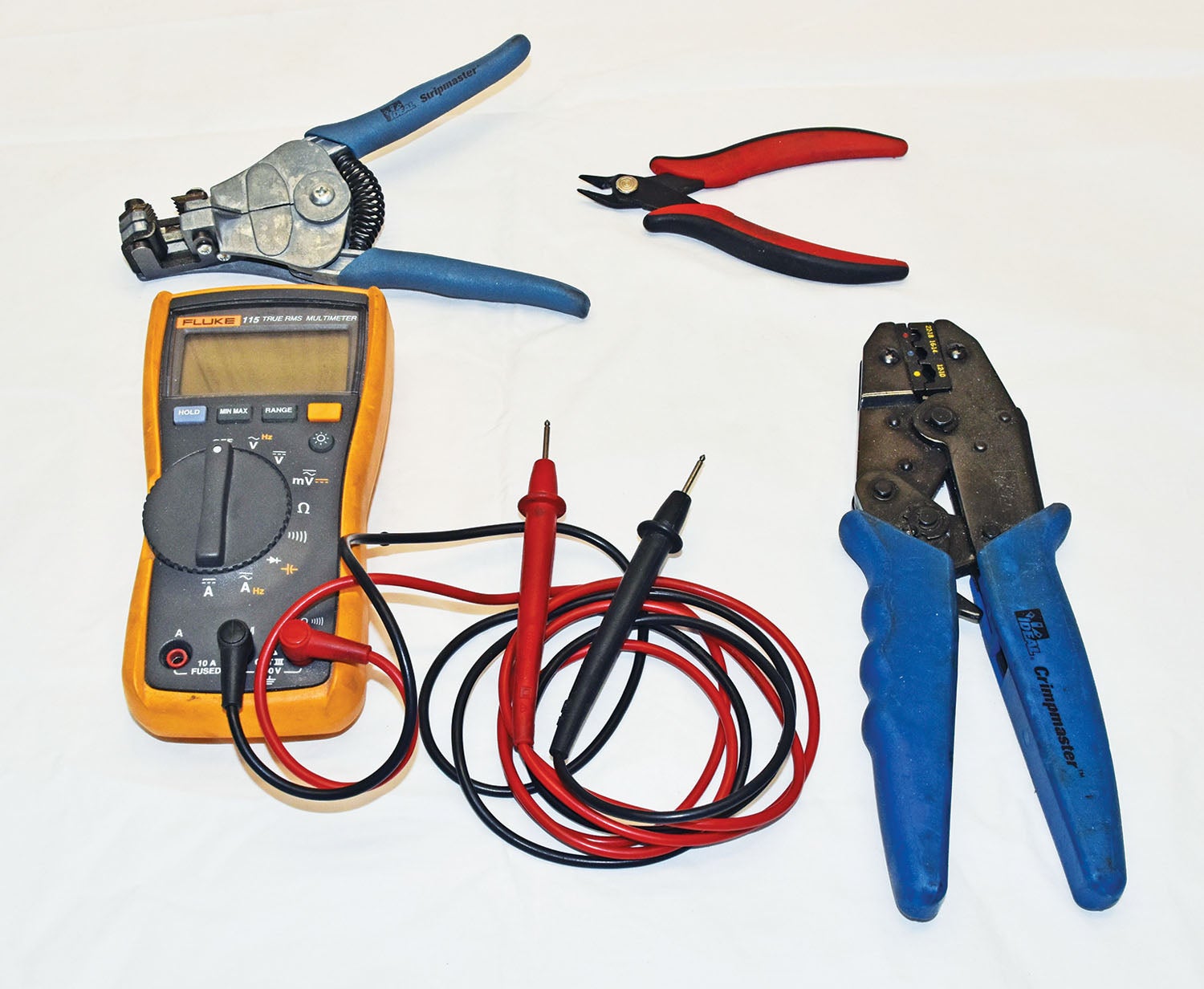

Your most important electrical tool is a good volt-ohm meter or multimeter that can accurately measure to 0.1 ohms and 0.1 volts. This is your primary diagnostic tool when sorting out electrical problems such as hard starting. My favorite is the Fluke 115, but the Fluke 101 ESP will do the job and only costs $53 from Amazon. There are cheaper meters, but it is hard to beat Fluke quality. If you don’t know how to use a multimeter, there are some EAA Hints for Homebuilders videos that can help and many YouTube videos that are mainly focused on automotive applications but can still be useful.
If you need to perform electrical repairs, you will likely need a good crimper, some side-cutting pliers and a wire stripper. If you need to buy these tools, be sure that they are sized for the gauge of wire you will be working with. I suggest you wait to buy them until you need them.

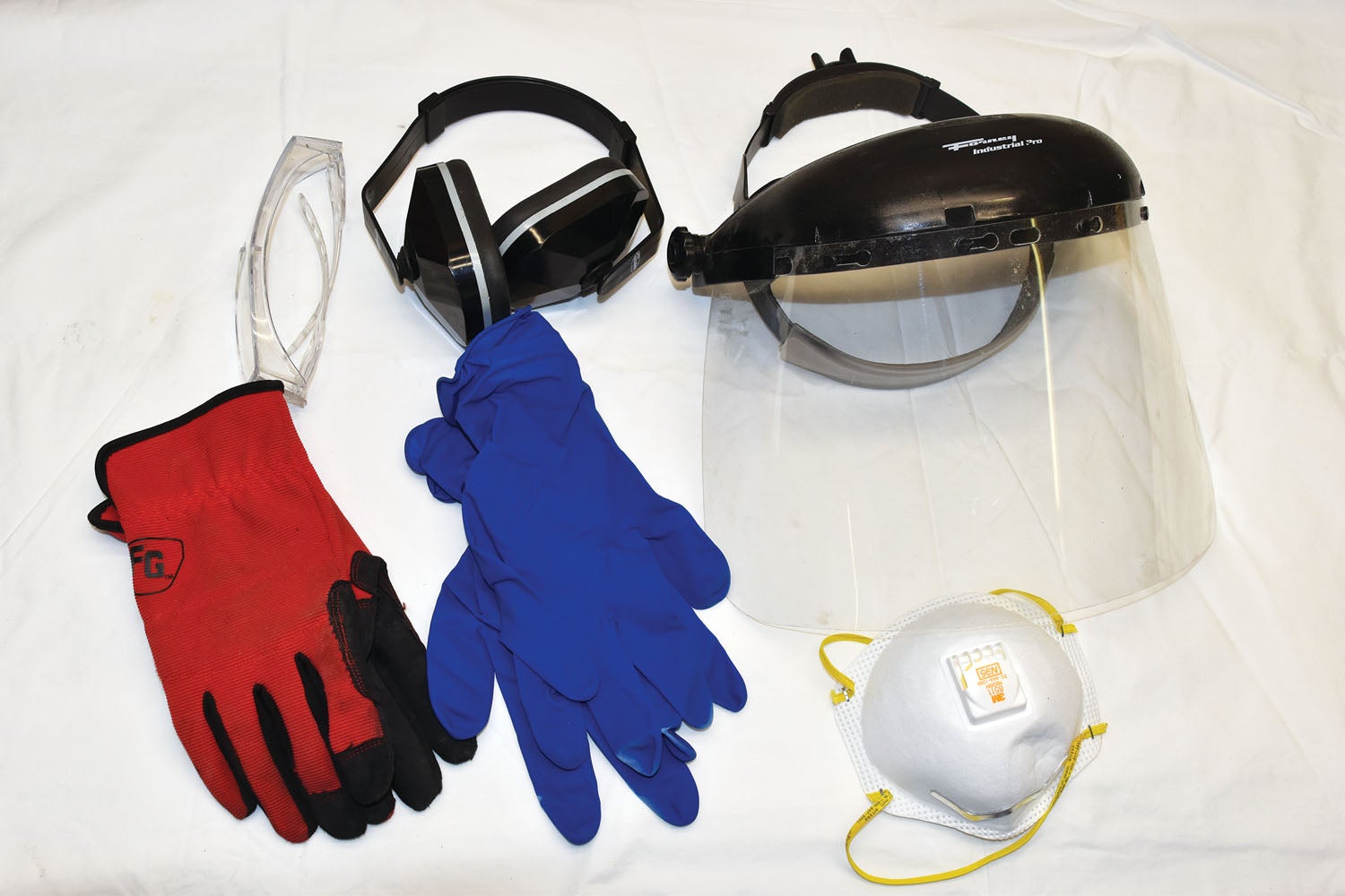

Personal Protective Equipment
It should go without saying that if you are exposed to personal risks while performing aircraft maintenance, you should take steps to prevent injury to yourself and anyone who may be helping you. When handling chemicals, resins or grease, you should wear nitrile or latex gloves. When working with liquids, a pair of safety glasses is a very good idea. When grinding, a face shield is much better than safety glasses. In addition to safety glasses, a dust mask is mandatory when cutting or sanding, especially fiberglass or carbon fiber. Work gloves can come in handy when working on a hot engine. And, last but not least, ear protection should be worn whenever loud noises are present such as when riveting or grinding.
This safety stuff is mostly common sense. It isn’t expensive to protect yourself, and it can save you from a serious injury, an injury that might jeopardize your flying dreams.

For a Hartzell propeller, it is better to buy a proper torque wrench, rather than using a crowsfoot.
Snap On has an appropriate torque wrench which has its’ own open end wrench for the nuts on a Hartzell.

Suggest you use a screw-type brake pad riveting tool as opposed to the hammer-type pictured. More control with screw-type equals less pad breakage.
