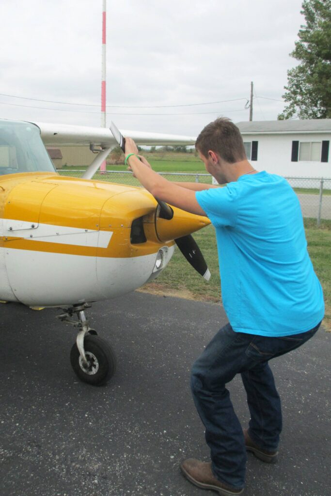

![The alternative to bending down as the propeller is pulled through the compression stroke is to keep the back straight and bend the knees slightly, stepping away in a crouch. [Credit: LeRoy Cook]](https://www.kitplanes.com/wp-content/uploads/2026/05/IMG_1519-683x1024.jpg)

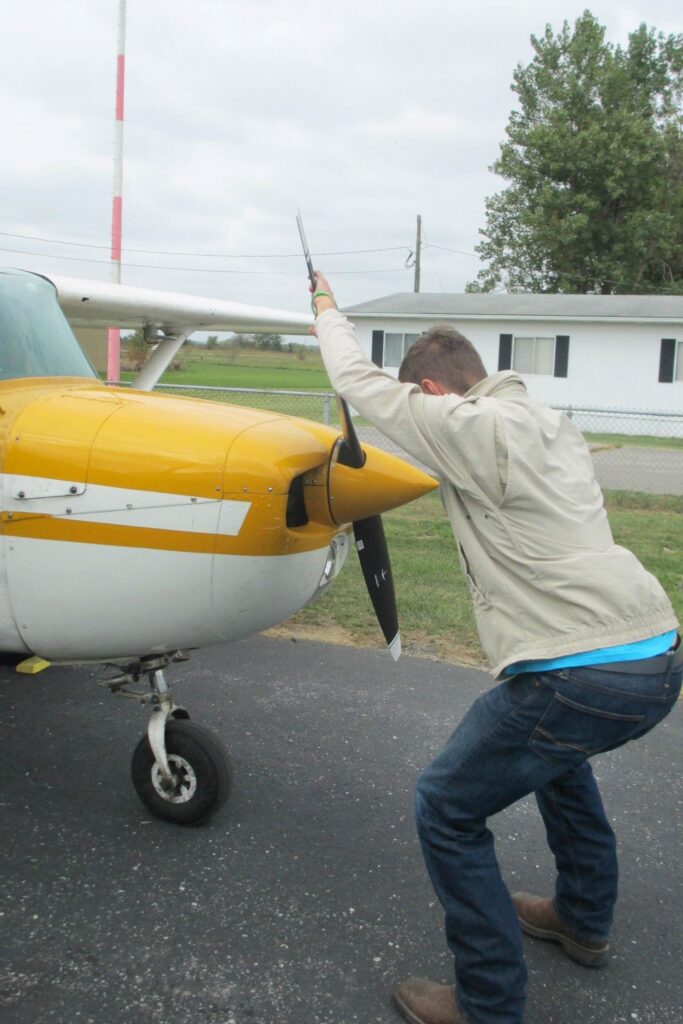

Airports and airplanes have changed. Nowadays, teenagers are forbidden to work or loiter around running machinery like aircraft, leaving them little to do except play video games and plot idle mayhem. Modern airplane engines are sophisticated large-displacement, high-compression, fuel-injected powerplants, not well suited for hand-propping. Tricycle-gear planes leave the propeller hub at or below chest-height, which requires attaining an awkward bent-over stance in order to pull the prop through a compression stroke.

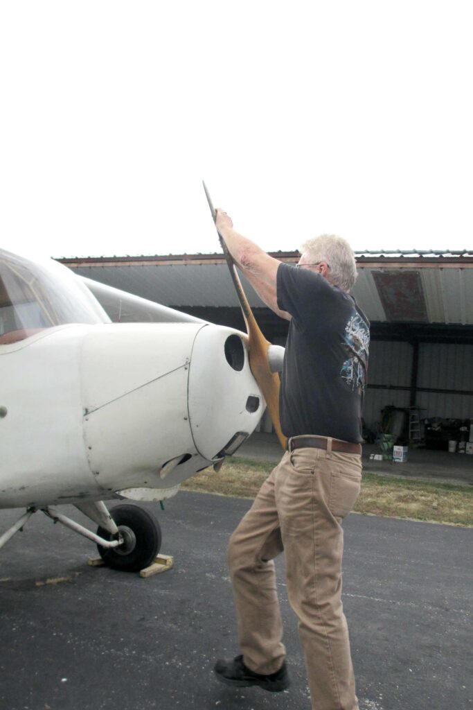

The ideal candidate for old-fashioned manual starting is a tailwheel airplane with a carbureted engine developing less than 100 hp from a 6.3 to 7:1 compression ratio. Trying to prop a 300-hp motor with 10:1 compression requires the strength of a lately departed Hulk Hogan. Oddly enough, old low-compression radial engines fitted with long propeller blades were relatively easy to hand-prop, despite their massive displacement.

First, don’t waste your time if you find the battery completely dead unless it’s an older plane with a generator. An alternator needs a source of voltage to excite the alternator’s field, so even if you get it running it’ll never supply power. It’s necessary to put some kind of charge into the battery before attempting any kind of start. Next, if you’ve almost exhausted the battery trying to turn over a Lycoming engine, you’ve probably engaged the starter in the process and will have a very hard time spinning the prop with the added drag of the starter against the drive gear. Finally, low-mounted propellers on the front of tricycle gear airplanes will require the aforementioned crouching down to make the rotation, a dangerous position. Also, some engines have propellers indexed so that the compression stroke comes at a less than optimum position for swinging the prop by hand; ideally, you want to be able to pull the prop through from the 10 o’clock point. As you can see, there are a bunch of reasons you shouldn’t attempt to prop an unsuitable airplane/engine combination.

Communication is key. The person swinging the propeller is the one who can get hurt, so they are the boss, and they need confirmation to definitely know when the ignition is on or off. Go over the terminology with your person in the cockpit. If you call “Switch off” it means the mags are to be checked to be sure they are off, and he or she is to respond with “Switch off.” “Contact” is the traditional request for magnetos to be turned on, not “Switch on,” which could be confused with “Switch off” in a noisy environment. If I call for “Contact and brakes” I expect to hear the reply “Contact and brakes” and I’ll nudge the prop hub to assure that the brakes are holding. “Throttle cracked” is a request for positioning the throttle to full idle and then opening it slightly to assure a prompt start.
Prepare the engine for starting with an adequate amount of priming; as part of the priming, I’ll usually make sure the mags are off and the throttle is open, then turn the propeller over a few compression strokes before resetting the throttle, leaving the propeller parked just before the compression point. Without delay, call for “Contact and brakes,” listen for a confirmation, and swing the propeller blade briskly downward as you step away from what you hope will be a running engine.
Impulse coupling notwithstanding, magneto ignition systems respond best to a quick, firm “snap” as the propeller is moved through a compression stroke, simulating the rapid twist of a starter motor. Dragging the prop through slowly may not get results and is riskier for the participant.
Take precautions to assure safety. Do not stand on a slippery surface as you attempt to prop an engine; you don’t want to lose footing and fall into a turning propeller. Move the airplane if necessary. If wearing a jacket, make sure it’s not flopping loosely; zip or button up so it can’t be snagged by a blade. Do not place any more of your fingertips over the propeller blade than you want to break or have cut off; one knuckle is enough to provide purchase; none would be better. Stand close to the propeller, rather than warily standing back and leaning over; if you lose balance and fall, you want to be going away from the prop disc, not into it. As you move the blade down through the compression stroke, be making a step back, giving some extra leverage and heading for safety. Use both hands, if for no other reason than to get the spare arm out of the way.
