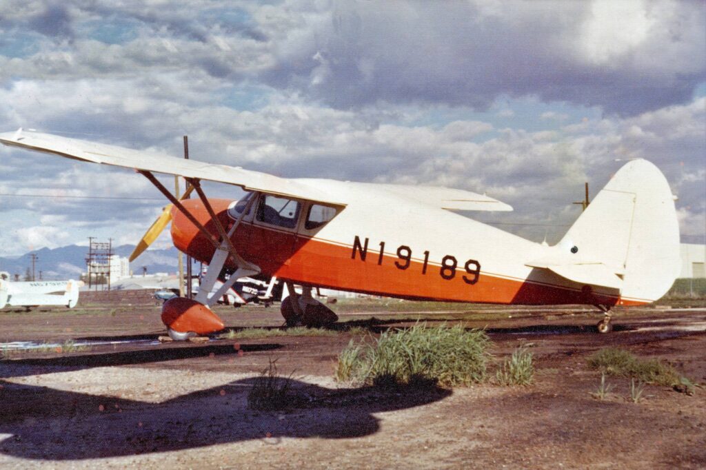

That brings us up to Griesbeck’s acquisition, serial #3304; The one in our hangar was a Fairchild 24K and one of only 34 or 38 built, according to different sources. We do know that it was built in Hagerstown, Maryland. In the spring of 1938, it was delivered to its first owner as NC19189. That owner was a corporation named Aircraft Service Inc., located at the municipal airport in Cleveland Ohio. It is believed that only eight of the 38 K models remain.
NC19189 passed through the hands of some 18 owners until it arrived in Schellville, California. Brian and Beverly Esler purchased it with the intent of doing a full restoration but instead sold the project to Werner. This involved a complex deal that included a freshly restored Aeronca L-3.

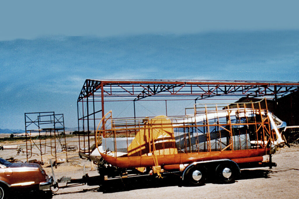

Werner began the Fairchild restoration that would take the next 4 years and a lot of research. Just getting the project home involved a round trip of some 1860 miles, several days on the road as well as a few issues with customs during the border crossing back into Canada. After months spent sorting out past ownerships and getting the appropriate bills of sale, he was able to get the aircraft registered in Canada as CF-BWW.

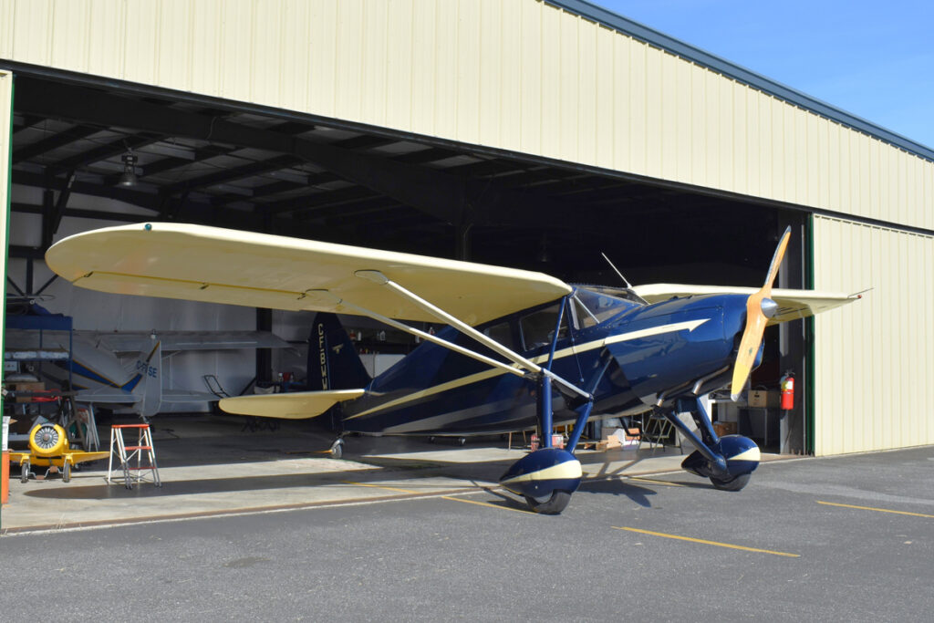

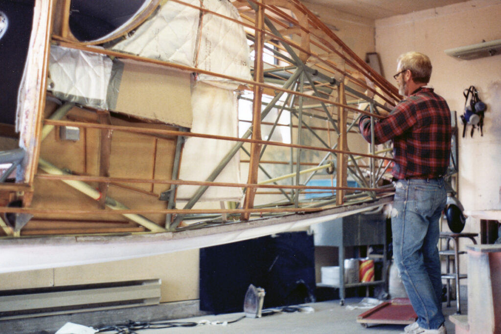

After getting the Fairchild parts home and sorted, he removed the wooden fuselage formers and then sandblasted and epoxied the fuselage. Once that chore was done, he reinstalled the formers that give the Fairchild its distinctive shape.
The wing, built by Ruth Spenser of Anderson, California in 1979, had the original spars but she had made all new ribs and installed new cables and hardware. This work was so well done that little more than minor touchup was required.
The stabilizer and fin required extensive repairs including a new rear spar and top and bottom plywood skins. The original Grimes landing light was overhauled and reinstalled. Both 20-gallon fuel tanks were repaired and reinstalled.
The left door frame was built from scratch using the N.O.S. (new old stock) right door as a guide. The Fairchild 24 has a unique quality in that the side windows can be rolled up and down. This helps improve picture taking and lends a decidedly cool factor when taxing in at a flyin. To facilitate this, new “Model A Ford” window winders were installed. The door panels were upholstered using the same material as the seats. LeBaron Bonney of Amesbury, MA provided the appropriate vintage material for not only the seats and doors but also the headliner. The interior was gutted and replaced with this immaculate blue and grey fabric reminiscent of the era. Each seatback contains a leather trimmed map pocket.
The instrument panel contains as many overhauled vintage instruments as could be found, including an airspeed indicator complete with the Fairchild logo. Werner installed a modern radio in one of the instrument openings. The transponder is hidden in a special side pocket that opens for use but can be closed for that 1930’s look when the aircraft is on display.
A new stainless-steel firewall had to be fabricated to replace the original as it was unlikely to get Canadian approval seeing as how it was made of a sandwich of aluminum and asbestos! He then went completely through the inverted 6-cylinder Ranger 6-440-C2 even though it had less than 50 hours since a military overhaul. All new main bearings and thorough check of all the other bits and pieces that make up the 200 hp engine were done before installation. A refurbished 3-gallon oil tank ensured a sufficient supply of lubricant. A new wood Sensenich propeller and a polished aluminum spinner completed the firewall forward installation.
