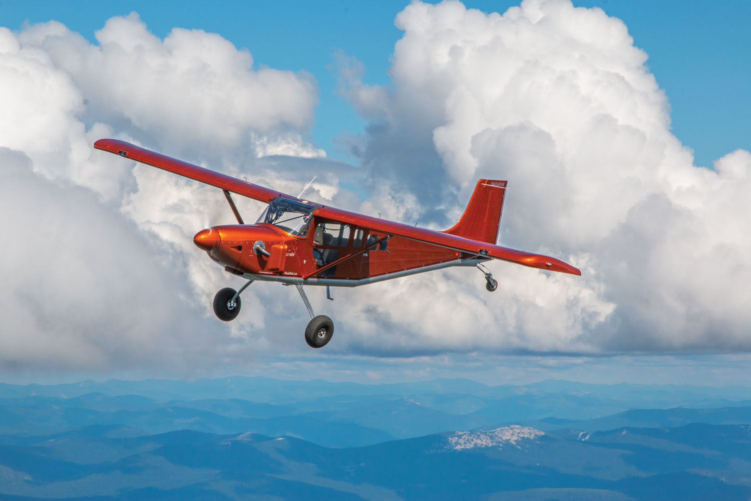

The Moose, designed and sold by Murphy Aircraft of Chilliwack, British Columbia, is one of the few kit airplanes designed to haul large loads in and out of unimproved strips—it’s a kind of Experimental-category deHavilland Beaver. Over a hundred Moose (Mooses? Meece?) have flown, but up in northeast Washington state, Ray Watson has created a Moose like no other—and he calls it the Bull Moose.

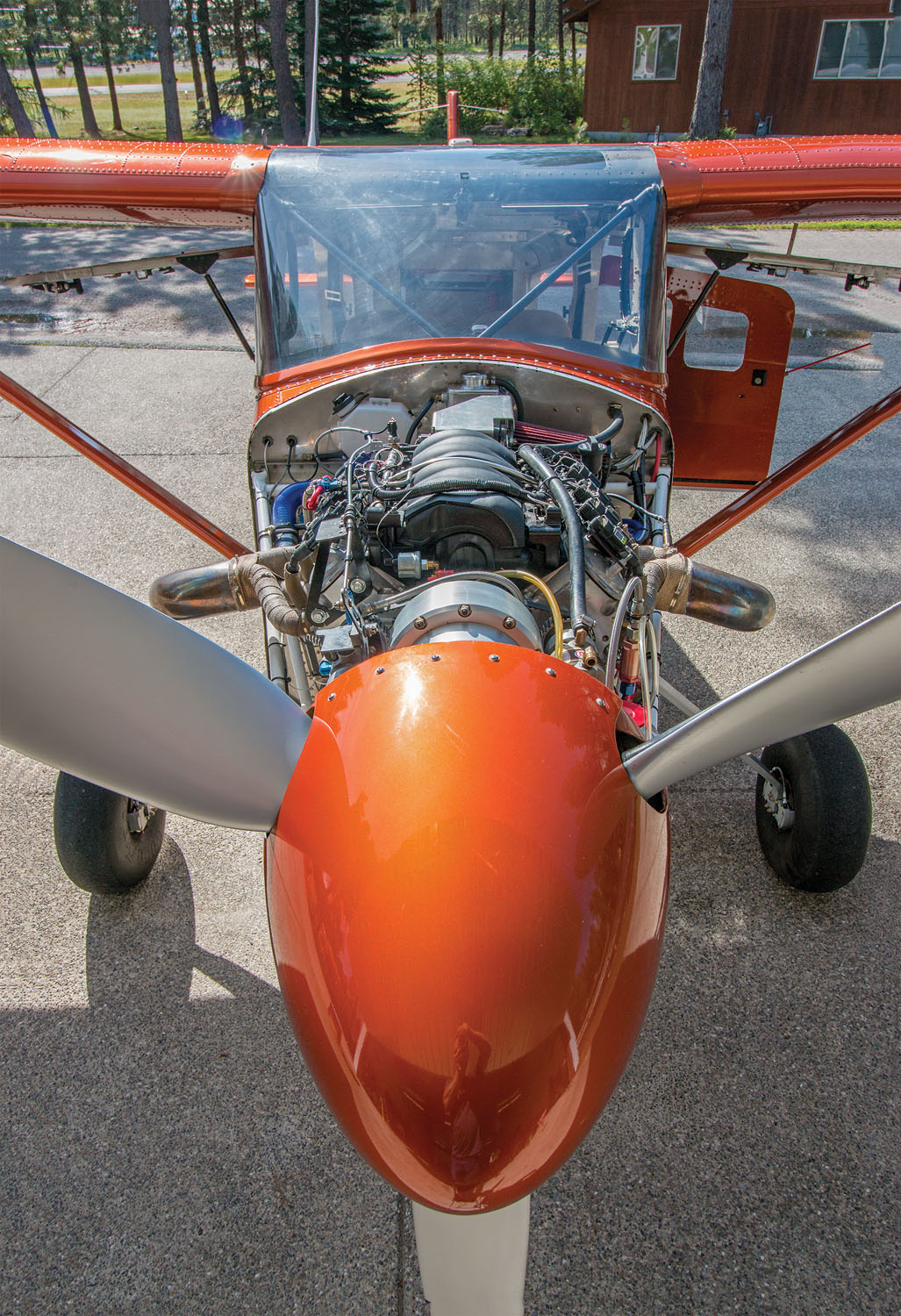

He chose the General Motors LS3, a much modernized but long-distant relative of the vaunted small-block Chevy V-8 used in several GM vehicles and as the basis for any number of racecar and racing-boat engines. Four hundred fifty horsepower is not asking a lot of an LS3; some versions can develop 500 to 600 hp. According to dyno tests, the 376-cubic-inch aluminum V-8 will develop about 470 foot-pounds of torque and 460 hp at 5200 rpm.
The new “crate” engine was not modified internally, but Ray did install a new throttle body linked to a push-pull throttle in the cockpit. “The stock GM setup uses an electronic throttle,” he says, “and I wanted a direct mechanical connection.” Custom exhaust headers lead to huge exhaust pipes protruding from either side of the cowl. There’s a custom harmonic damper mounted on the crankshaft flange. An aluminum radiator with a thermostatic fan lives underneath the engine, with a large cowling scoop feeding it air.
The PSRU and Engine Controller
Five thousand rpm is way too much for a propeller, so a reduction drive is a necessity. Ray chose the CAM 500 2.11:1 gearbox built by Firewall Forward Aero Engines in Ontario, Canada. Designed to handle up to 750 hp, the unit also provides drives for a hydraulic prop governor and, if anybody still wants one, a vacuum pump. The reduction ratio results in 2500 propeller rpm for takeoff and 1900–2000 for cruise—well within the comfort zone of the Hartzell three-blade propeller.
According to Archie Dobbins at Firewall Forward, “Our unit uses a dry sump system with a two-stage oil pump supplying pressurized oil directly to all the gears and bearings. The oil is used just for the gearbox—it isn’t shared with the engine. A damper with eight internal springs quiets resonances between the prop and the engine. Most of the gearboxes we’ve built have gone into replica fighters using automotive V-8s and they’ve performed well.”
Another Canadian firm, Simple Digital Systems (SDS), provided controllers that handle the fuel injection and dual ignition with variable spark timing. “SDS has extensive experience with aircraft,” says Ray, “and even more in automotive racing. Ross Farnham has been generous with his expertise and continues to help us develop the potential of the LS3. His system can log extensive data and make it possible to see what the engine is really doing so we can make changes that improve performance and economy.”

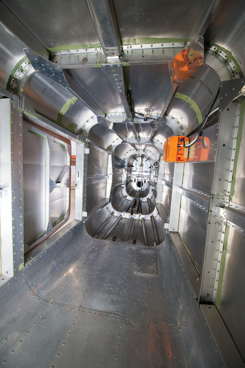

While he was building the Moose, Ray incorporated some structural modifications designed to handle the extra power. The fuselage was built with some thicker skins, additional stringers in the tail cone and a strut brace for the horizontal stabilizer. Heavier tubing was used between the firewall and cabin top. He developed a long, slender cowl to accommodate the V-8—the result (and those big exhaust pipes) makes the airplane look very “turbine-like.” So much so that Ray is semi-seriously contemplating a “NO JET A” sticker around the filler caps.
Beyond that, there are top-hinged doors for easier docking on floats, and there’s a small baggage compartment with its own door in the aft fuselage, suitable for light items. The finished airplane, painted an eye-catching shade of orange, weighs 2034 pounds—similar to M14-powered versions. That’s impressive considering the structural changes and the fact that the V-8 is liquid cooled, which typically adds a significant amount of weight.

Ray invited me along on a brief fight. After we’d added 20 gallons of ethanol-free, premium-unleaded auto fuel to the wing tanks, I clambered into the large cabin using some cleverly placed grab handles. Forward visibility was better than I expected—even though the spinner was way up there, you could see around the slender cowl quite well. Looking over the long, pointy nose, I realized that I’d never been in an airplane with a V-anything engine.
Ray fired ’er up. Electric boost pump on, fuel pressure up, mixture rich, electronic ignitions on—and hit the button. Two or three blades later, the engine gave a couple of short barks and settled into a crackling idle. I told Ray he could sell this package on the sound alone! It reminded me of Oshkosh mornings when the P-51s were going out for their morning rat races.
We lined up on the runway and Ray applied takeoff power. That crackle immediately spun up to a snarling roar and the Moose moved out smartly, tugged along by the three-blade Hartzell constant-speed propeller. Even with an 82-inch diameter, there remains 22 inches of clearance when the tail comes up for takeoff.

Just wondering where, that beautiful grass strip the bull moose is parked on, is located?
Hello Brad. That photo was taken at Elk River, Idaho. A favorite fun spot. Ray
