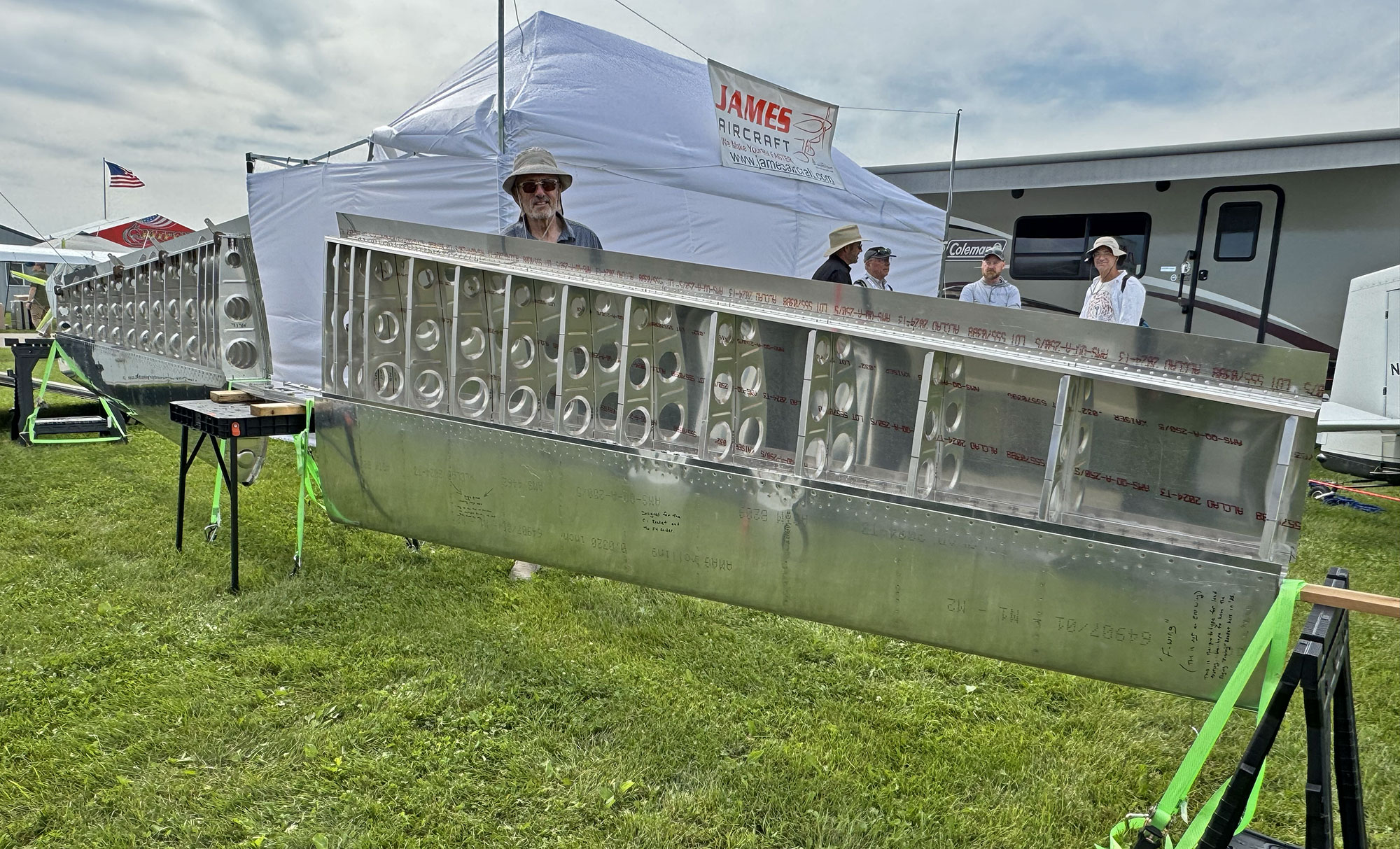

F1 Rocket wing that is still in development is on display at the Team Rocket booth in the Homebuilt vendor area.
When Vince Frazier began producing F1 Rocket parts a couple of years ago to restart Rocket kit production, he knew he wanted a new wing. The early RV-design wings were not ideal for the F1’s performance profile. The technical goals for the new wing were twofold:
  1. Enable more practical and slower landing speeds
  2. Allow faster cruise performance above 10,000 feet
To work toward these goals, Frazier partnered with longtime friend Paul Romano—an F1 Rocket builder, owner, and engineer. Romano has a partially completed prototype of the new wing on display this week at the Team Rocket booth in the Homebuilt Vendor Area, showing the progress so far.

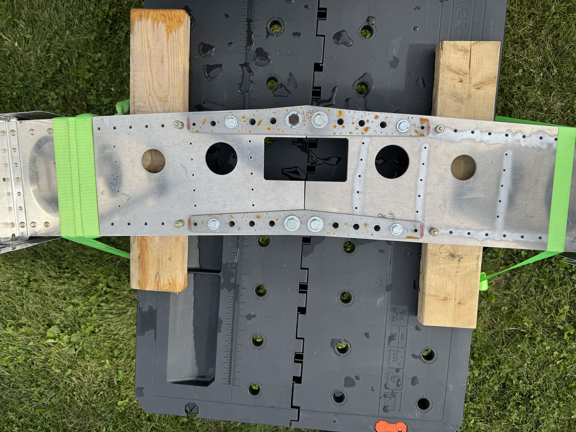

Port and starboard wing spar interface on the developing, new wings for the F1 Rocket.
