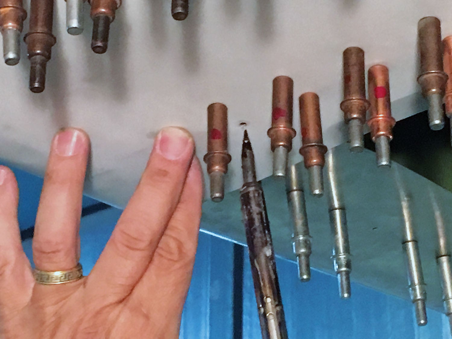

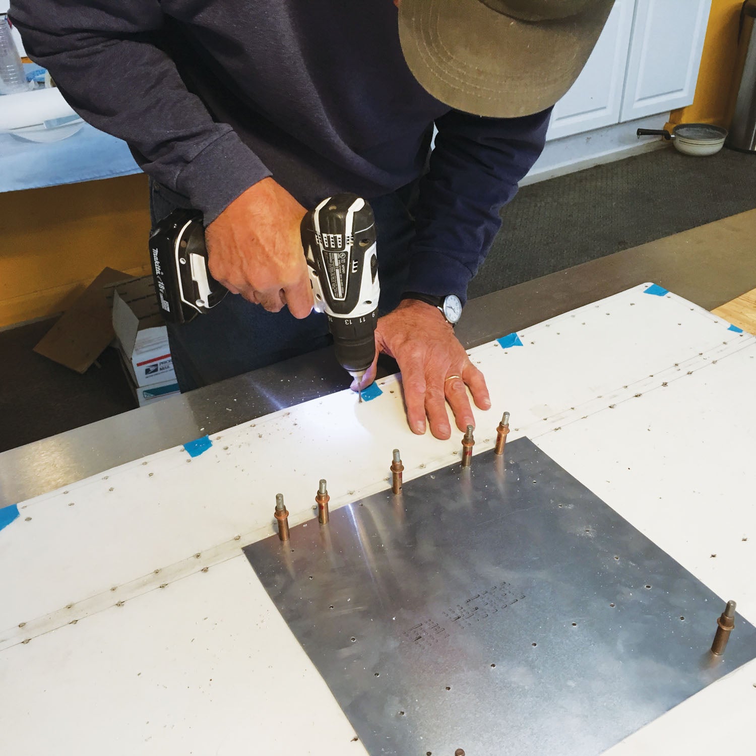

Ribbed!
Again by this time, there was no point in contacting the factory for parts. In fact, I had received a phone call (in my capacity as a journalist) from someone representing the owner of Dream asking if I had any idea of someone who might want to buy the entire program—the rights to the design, the intellectual property, remaining parts, the prototype and several complete kits. So I knew that we were again on our own. Since the leading edges were tapered in two directions, replacing them was not going to be an easy sheetmetal job. When I de-riveted them, I also found problems with double-drilled holes for the skin rivets—meaning I was going to be making nose ribs. So once again, I pulled out my very worn copy of AC 43.13 plus my sheetmetal mechanic’s handbook and went to work on doublers that would patch the skin at each nose rib. Lots of drilling and fitting followed, with extensive trimming to make everything fit nicely. Hundreds of tiny rivets later, the tail was once again airworthy.
