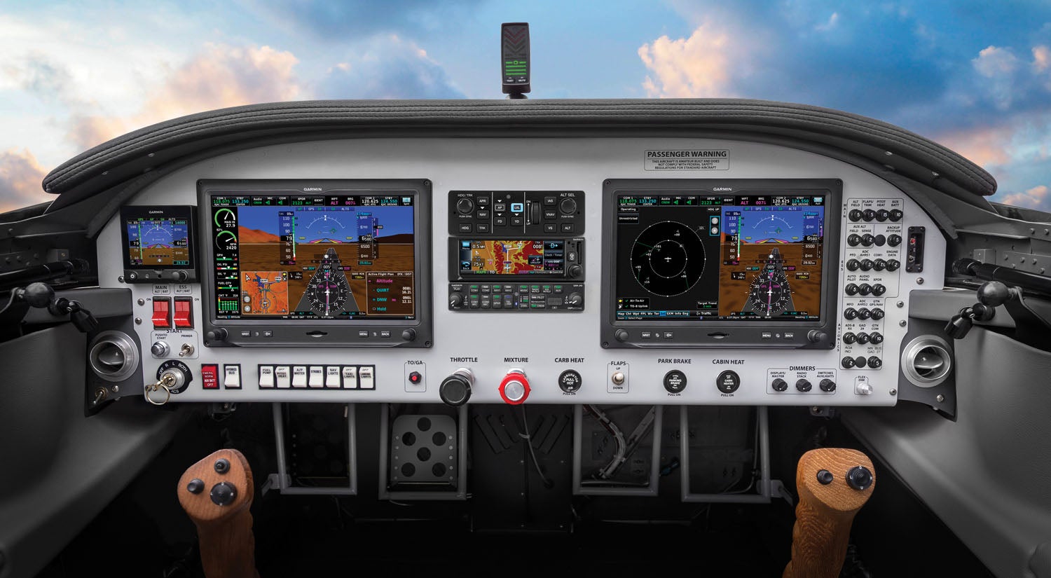

I know most everyone flies IFR with belt-and-suspender tablet-computer backups, but let’s be real: Total and even partial EFIS failures in the clag or at night are no joke. And since most otherwise skilled builders aren’t trained avionics techs with years of install and troubleshooting experience, the chances of having to deal with (and fix) an installation screwup are good. Even if you didn’t build the kit and inherited someone else’s work, with a little bit of savvy, a lot of concentration and the proper manuals and wiring prints, you can get it fixed right to last a long time.
For a follow-up to the Troubleshooting 101 article in the August 2021 issue of KITPLANES®, here we’ll focus on common EFIS problems. We’re talking about heading error, air-data and angle-of-attack and attitude problems, plus some things to do to make the system easy to troubleshoot as it ages. As a bonus, Garmin’s Team X and Dynon engineering both weighed in on what they hear on their tech support lines and read on the tech forums. The takeaway: Maintaining an EFIS starts long before you crimp your first wire.

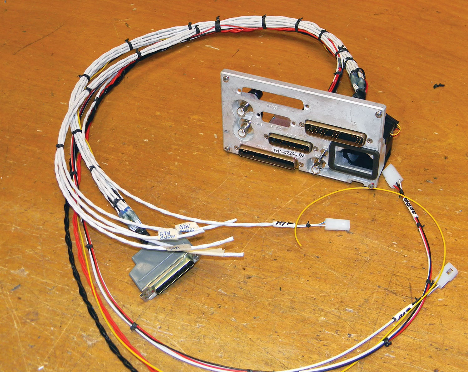

Joe Gepner, the lead engineer on Garmin’s Team X Experimental avionics development and support team (and an RV builder), made a good point in that avionics wiring prints are so important that they should have a direct influence on the value of the kit. Searching for a used homebuilt and found one that doesn’t have wiring diagrams for the avionics and other systems? It might be a red flag, or at least a costly problem, should you need to dig into its wiring. Don’t plan on an avionics shop to bail you out with a finger snap.
When faced with troubleshooting a homebuilt without diagrams, many avionics shops will charge the owner to create a set. That can be either an easy or miserable task, depending on the complexity of the suite and the quality of the build. It can be even more of a hassle if the existing harnesses aren’t labeled. Be ready to pay the regular hourly shop labor rate for the effort and be turned away at some busy shops that don’t want to deal with it. Wiring diagrams that are valuable for troubleshooting don’t have to be complicated. You can create them by modifying and marking up the interconnect schematics as shown in the installation manual to reflect your install. Your kit is custom, and so is its paperwork.
Since EFIS suites generally have multiple components, or LRUs (line replaceable units), you can even document on the diagram where the component has been installed in the airframe, pointing out areas of access through certain inspection plates, for example. This might ease the disassembly chore when accessing the component and its connectors buried in the airframe. Worth mentioning is that the EAA offers a personal-use version of the SolidWorks industry-standard CAD software free to members. You can make a professional set of prints that really can add value to the kit, or at least make it more attractive for a shop to work on.
Avoid wiring failures in the first place by wiring it like the pros. Have a realistic discussion with yourself about your skill set. If you are new to the world of avionics wiring, consider training to properly strip, crimp and solder connectors, build wiring bundles with proper strain relief and chafe protection, and thoroughly understand ground connections and what they mean for overall performance. The effort will pay back. Whether you are building your own kit or troubleshooting and repairing the avionics in one that someone else built, chances are good that you’ll have your hands in the wiring at some point. Building and maintaining a kit means you are also an avionics tech. See the sidebar below for some suggestions on training and guidance.

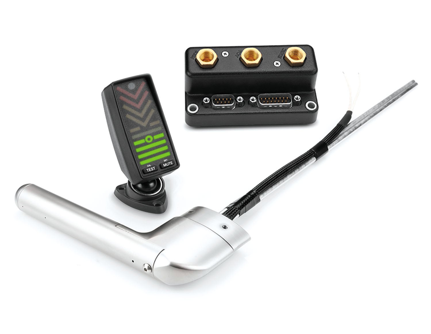

Some problems may be minor but still a nuisance. Maybe you don’t see true airspeed, for example. If the TAS data field on the EFIS is dashed (at sufficient indicated airspeed) or red-X, check the wiring at the temperature probe. If it checks good, try swapping the probe.
Water intrusion can be a common issue in air-data computer failures, especially when installed downhill of the static lines. When flying in heavy rain, water can run down the pitot and static lines and ultimately work into the electronics—a setup for component corrosion and eventual failure. Speaking of pitot systems, many pitot tubes have integrated angle of attack sensors with dedicated AOA pressure ports. For smooth, constant and accurate AOA data, the pitot probe should be mounted as close to the wing’s leading edge as possible to allow for the best, constant airflow. Mounted farther back will often cause choppy and unreliable readings. Last, when bringing the aircraft to the shop for a pitot/static and transponder inspection, remind the tech that the pitot tube is equipped with an AOA port. I’ve seen some techs damage the differential pressure port by not teeing it off correctly and running the system up to high altitude, while drawing considerable vacuum on the AOA port.
