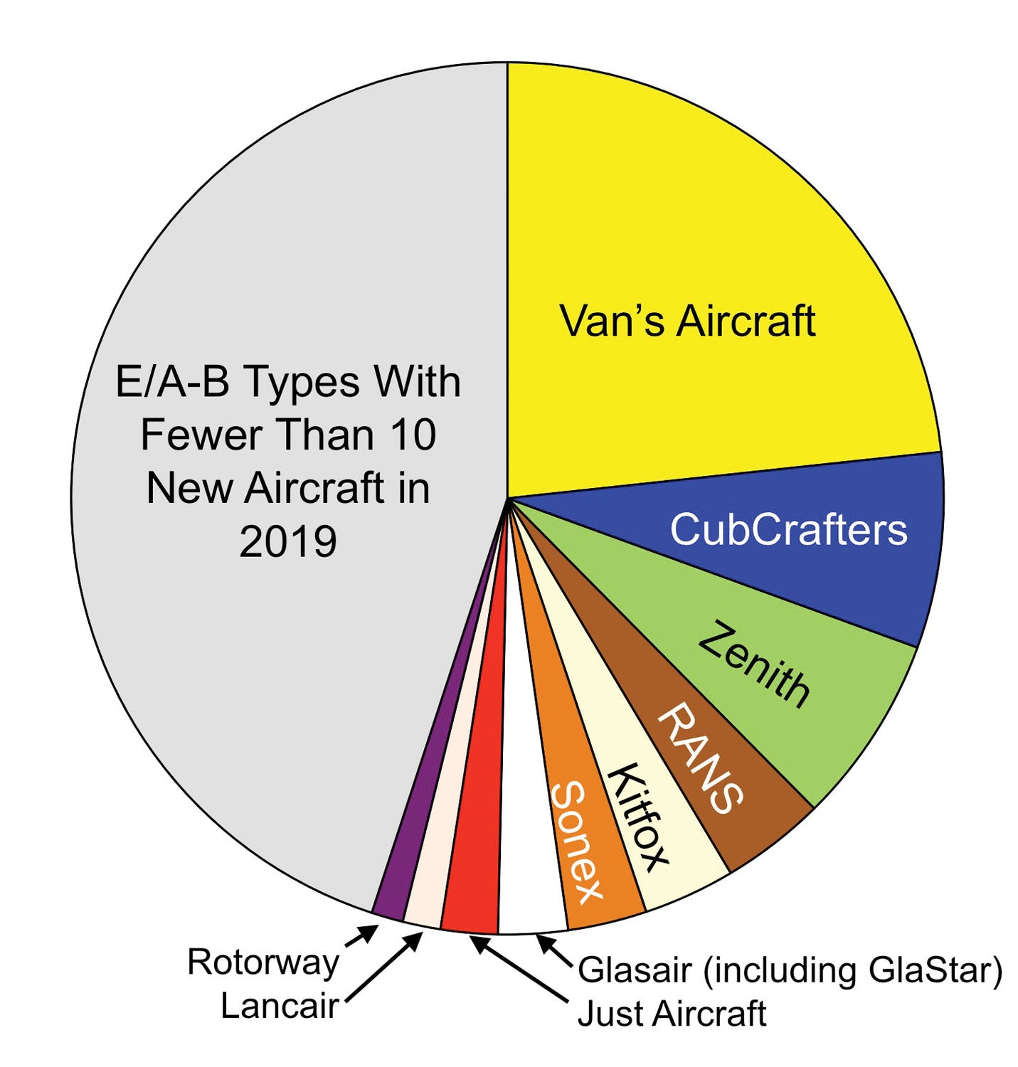

Happily, we’re seeing signs of recovery. Last year, 1179 new E/A-B registrations were added to the roster, the most in a single year since 2001. Three hundred thirty-five were previously deregistered aircraft that had been restored to the registry. But to the FAA, they count as new aircraft—so we’ll count them, too.
If we ignore the “restored” homebuilts, 844 actual new homebuilts were completed. What types were they?
As one would expect, Van’s Aircraft led the way: 199 of the new aircraft were RVs. The RV-7 took the lead, with 51 examples. Second place was a surprise—in more ways than one.

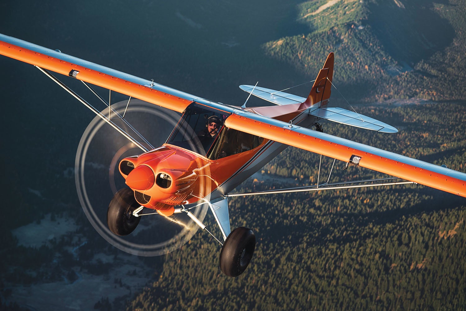

CubCrafters was number 2, with 61 new Carbon Cub airplanes of all models. What’s more, the larger airplanes in the stable, the 2000-pound gross weight versions of the Carbon Cub, saw 51 new aircraft added to the registry in 2019.
eab fleet size chart 3
A wide variety of homebuilt aircraft were completed in 2019. Relatively few companies saw 10 or more new aircraft.
That’s the same as the RV-7. Van’s and CubCrafters tied for the most-produced homebuilt airplane in 2019*.
Of course, Van’s wide offerings dilute the sales of specific models. If the company hadn’t offered the RV-8 and the RV-14, more customers probably would have opted for an RV-7, and the comparison wouldn’t have been close. Still, it’s interesting when you consider that the Carbon Cub kit costs about twice that of a quickbuild RV-7.
In close third place with 60 new aircraft was Zenith. Over half (31) were CH 750s and 14 were CH 701s.
