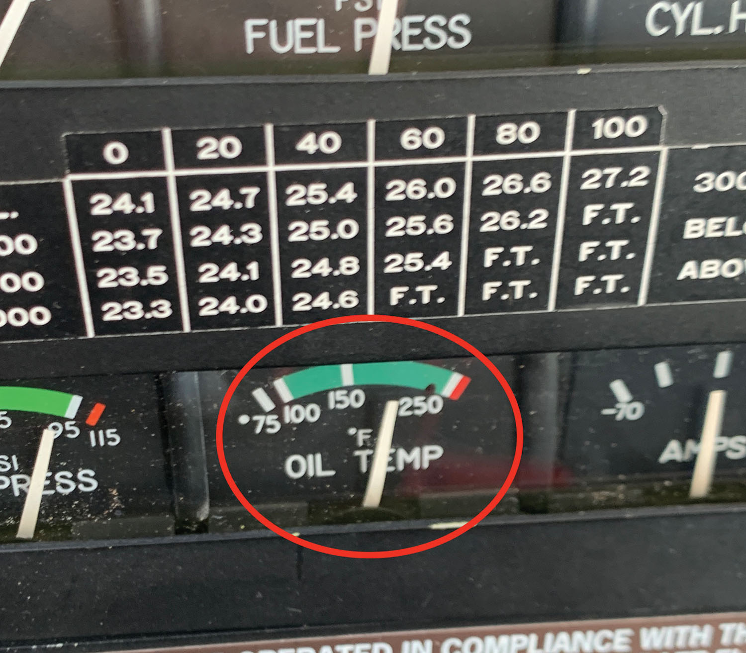

When I started flying it in Atlanta, it was early spring. Warm, but not hot, and certainly not Phoenix hot. Right away I noticed two things: high oil temps and high oil consumption. The oil temp always ran at the top of the green arc, which was 250° F, with 260° being the redline. It is a Lycoming engine, an HIO-360-D1A to be exact. Hmm…that’s not unlike the Lycomings in which I have thousands of hours and for which I’ve always strived for temps around 185–190° in cruise. On top of that, we’ve always been told that the oil doesn’t like to see temps above 245°, which is the oil temp redline in the other Lycomings. By the way, we are using the same oil in the helicopter as in the other aircraft.

Finally, one weekend I had enough time to get to the bottom of it. The first thing I did was hover and run the temps up to their normal indications. I immediately landed and shut down, and used an infrared thermometer on various parts of the engine, including the oil filter. Interestingly enough, the temps were much lower than I thought. The oil sump was around 199°, and the oil temp probe was showing 165°. It is normal for the sump to be hotter as the oil temp probe is measuring the oil temp as it enters the engine, having already been through the coolers. Since I had to sit and let the engine temps cool down with the engine running for 2 minutes prior to complete shutdown, these temps appeared normal to me. I had a sneaking suspicion I had an indication problem, but there was another culprit I wanted to check—the vernatherm.
The vernatherm is there to decide which way the oil is routed for cooling. Normally, it stays pretty much closed until the oil temp is up to around 185°, at which time it opens and then routes oil to the coolers. If it wasn’t opening, that would cause higher oil temps. A quick test is to remove it, place it in a pan of water and slowly heat it on the stove. We did this and watched it open very nicely as the water temp hit 185°. Yeah! Another thing to note is that the vernatherm really never completely shuts off all of the oil flow to the coolers. It allows a small amount of leakage to the coolers to keep them warm so oil will flow through them. Otherwise, when flying in really cold climates, it would be possible to send a nice hot slug of oil to a fully congealed oil cooler and blow it up.
Now my premise was that the vernatherm was really never fully opening up as it was not reaching 185° on the helicopter. That would explain the slightly warm feeling of the oil coolers when I touched them. My next step was to check the calibration of the gauge. Luckily, the Hughes H269 helicopter (predecessor of the Schweizer 300) was built for the military, so the maintenance manuals are excellent. It was very easy to find the resistance numbers for the various numbers on the gauge. I just happened to have enough of the right resistors around to test the various indications, which showed the gauge to be quite accurate. It must be a bad sender, so I tested that as best I could, heating it in water and watching the gauge in the aircraft. It was puzzling, in that it was not quite as accurate as I thought it should be, and in fact read high, just like in flight. Luckily, Aircraft Spruce had the sender, and while I was at it, I replaced the wiring from the sender to the panel.
Guess what? It worked. The oil temp gauge now reads in the middle of the green in flight, and still never moves. But that’s OK. The vernatherm is doing its job correctly and the engine is not really overheating at all. I’m more relaxed now in the hover and not distracted by the oil temp. We’ve since had some pretty hot days here in the upper 90s, and I have purposely hovered and let the CHTs climb from 350 to 400, with no change in oil temp, so I am very happy. I have concluded that the dual coolers are quite capable here in Atlanta.

So, here are the lessons that I knew, and sometimes tell others, but this time I had to remind myself: Don’t always trust the gauges, and check the markings.
