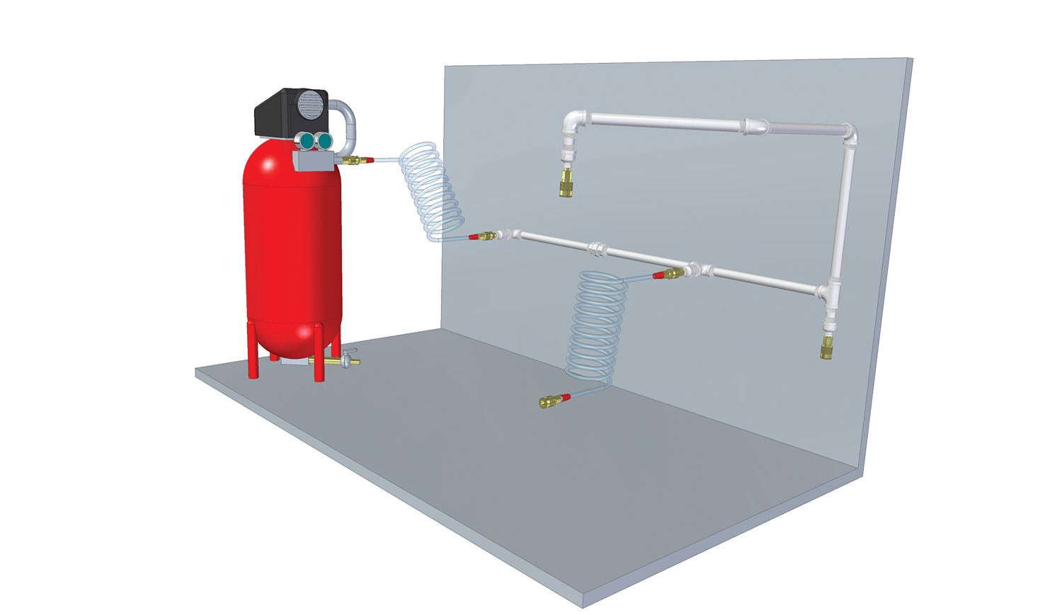

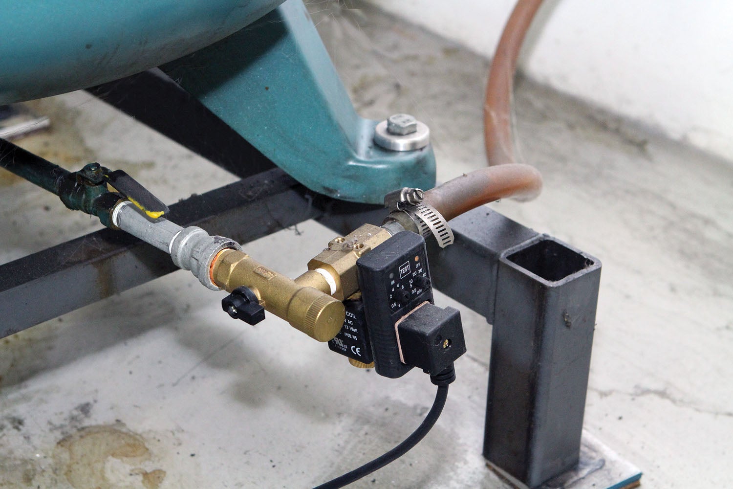

The size and complexity of an air system for a particular shop is subjective. It could be as simple as a small compressor, a flexible hose (or hoses) and a blow gun. Or it could be as complicated as a main line with multiple branches going around and above in order to provide an air hookup to each workstation. Add a filter/water separator and perhaps a dryer if you own a sandblaster or are spraying paint. If you’re in the shop every day, you should consider adding an automatic tank drain.

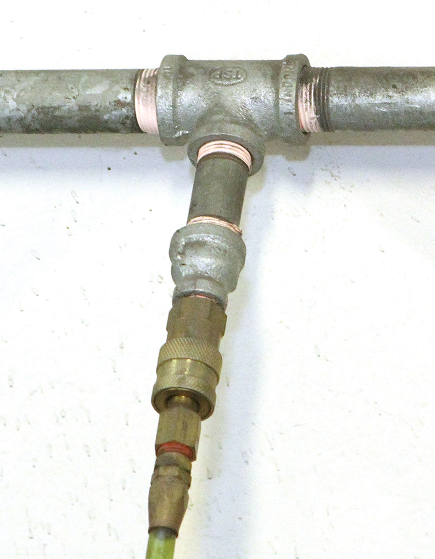

The easiest and most practical way to run air lines is with galvanized steel piping. I recommend ¾-inch (ID) pipe. The larger the better, in fact, because a percentage of airflow is lost due to the internal friction of the lines. The larger the line the more efficient the airflow, especially over longer distances. At the end of this column, I’ve included a rundown of the piping components that might go into a typical system. How many of each depends on how complex you want to make the system.

Although rated for 150 psi water pressure, PVC pipe is not rated, nor recommended, for use with compressed air. Yes, you may have been in or around a shop with PVC air lines, but unless you’re going to keep the regulated pressure so low as to be useless for air-powered tools (below 50 psi), the risk is not worth it. The normal working pressure (the regulated output to the system from the tank) in most shops is around 80 psi. At that pressure, if a PVC pipe breaks, it will send shards of plastic in all directions. Copper or polyethene tubing are viable alternatives to galvanized pipe, but the cost will be much higher.

Great article, and I would just add that most homebuilders will no doubt discover that there are two commonly used standards for air fittings: industrial and automotive, and that no matter which one you choose for your system, at some point you’ll inevitably come across a situation where you’re trying to plug in a tool that is equipped with the other one. The fittings aren’t difficult to swap out but it can be pretty annoying. I used an adapter for a while, but that was never handy when I needed it. I also tried some universal couplers with mixed success — until I came across the push-button safety air universal coupling, made by Husky and Rapidair and possibly others. These things are the bees knees — not only do they work with both standards but the push-button release makes disconnecting a one-hand operation. It’s a small thing but it makes things go smoother in the shop, and I have one of these on all my air hose connections. Available from the usual suspects (Home Depot, Amazon, etc.)
The best quick connect to use, is the one with the lowest pressure drop while connected.
The lower pressure drop guarantees high pressure and airflow at the Tool. specially while drilling aluminum you want high speed drill to get the smoothest bore possible. Incredibly important wile building a spar and drilling those rivet holes.
