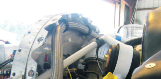

Looking radical and yet somehow normal at the same time, the headers are conversation starters. This dual three-into-one layout is optimal for flat-six engines, yet six-into-one exhausts predominate with Red Bull and airshow performers likely because the single exhaust is better for burning smoke oil. The nearly flat angle of the exhaust exit looks sharp and minimizes drag (as if it mattered on a dirty old Starduster, says the author) but is awfully shallow. The transponder antenna melted in about 5 hours and exhaust residue lays thick against the belly.

Welding the headers at your home shop means your airplane provides the necessary buck. But the author was so tickled by the pro welding on the Burns Stainless collectors that he elected to have his headers made by one of its contractors, Chris Parker at CPR Fabrication. That meant a dummy engine supplied by Ly-Con played a major role in providing the welder with a fixture to work against. Looking down on the dummy engine shows how cylinder offset, along with the reversal of the intake-to-exhaust port relationship from left to right bank, means the right-side header barely reaches with 34 inches of pipe, while the left bank snakes tightly to end up at the same spot. Burns calls for all primary pipes to be within +/- a quarter-inch length of each other, and that goal was met.

The finished product is a work of 321 stainless-steel art, especially before the inevitable discoloration begins. Much consideration was given to providing adequate compliance among the pipes to avoid cracking. Ultimately the slip joints at the collector were deemed sufficient, as each pipe is separate, has at least one bend and is nearly a yard long. These factors allow the pipes to expand and squirm with heat cycling. Further, each pipe is 16 gauge from the flange to the first weld, then 20 gauge the rest of the way to the collectors. The thicker material at the flanges aids mechanical strength and crack resistance.

Step one in building a header is to mock it up. After considering PVC pipe and flexible tubing as mockup material, I took Jack Burns’ strong suggestion to tack the system together from mild steel purchased at a local muffler shop. This gives by far the most accurate idea of what fits and what doesn’t. This work was a collaborative effort between Aberle Custom Aircraft in Fallbrook, California, and to a lesser degree, yours truly.
With the mild steel mockup complete, the final product was welded from 321 stainless steel by Chris Parker at CPR Fabrication, which is right next door to Burns in Costa Mesa, California. This ensured superb pipe fitting and welding, though an experienced hobby welder could get close as the final header is built up from straight tubing and pre-done bends, just like the mockup.
Burns Stainless likes a tapered nozzle at the end of its megaphones to enhance their scavenging effectiveness. Burns calls them reverse cones, and in this example they narrow the 3.5-inch megaphones to 3 inches at the outlet. The felt-tip numbers are the weight of header/collector/megaphone assemblies in pounds. Burns uses the weight as a double check of symmetry between the two sides. The 0.2-pound difference is chalked up to slightly different lengths of 16 gauge primary pipe side to side.
