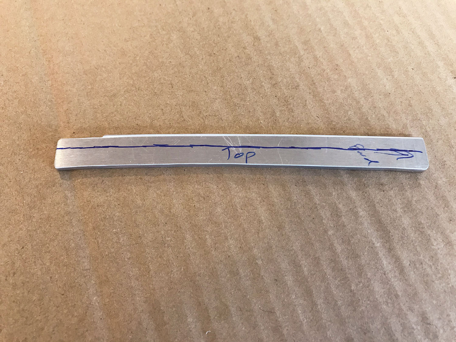

Holy Longerons!
On the cockpit longeron on the opposite side from the canopy hinge, the canopy is registered in place for latching with two pins that stick down below the lower edge of the canopy and stick into two holes in the longeron. These pins are actually AN3 bolts ground down with bullet points on the end and are initially lined up with the longeron to be match drilled. They fit and work well, but over the years, vibration and the small changes in shape that come from opening and closing the canopy have enlarged the holes in the top of the longerons.
Now longerons are pretty important, especially in an aerobatic airplane. They carry primary loads the length of the fuselage, and it is easy to lose edge distance when a hole elongates in a 3/4-inch piece of aluminum angle. Fortunately, they are also relatively easy to repair using doubler plates, fitted and riveted to the inside of the angle.
We used 1/8-inch-thick 2024-T3 aluminum sheet to make the doublers, scribing them in place and shaping the edge to nestle nicely into the inside fillet of the aircraft-grade angle. Rivet holes were laid out using standard spacing from Advisory Circular 43.13 for repairs, and flush rivets were used in countersunk holes to make the surface smooth for the canopy to sit down. Once the doublers were in place, we redrilled the holes for the registration pins in the locations where the current canopy shape wants the pins to be. We’ll keep an eye on them to make sure they don’t begin to migrate again. Repaired as needed.
